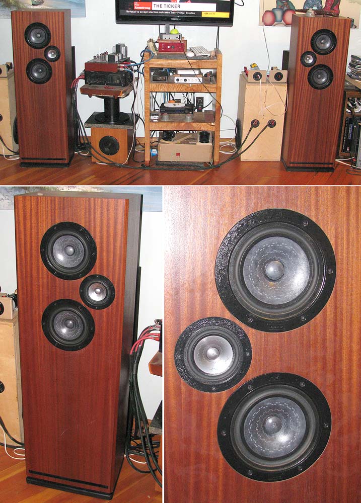

I'm building a pair of simple 2 ways, with a front port, and maop-7's and 12 pw's Dave. Cabinets lined - top section top and sides, lower section lined top and down about 10cm (4") below the driver with stuffing very loosely below.

This one? http://wodendesign.com/downloads/simple-2way-A7pA12pw.pdf
In a BR you line the walls (or at least 3) so as to try to reduce higher frequency reflections. Too much damping screws up the helmholz function of the vent.

Yup, that one. I followed guidance from Stefan at KJFaudio for the lining and stuffing. Not sure what the helmholz function is but the vent has been useful when trying to pick up the boxes...!

Any update, or listening impressions, and comparison's? I'm interested in building a set of these, or something similar.
Sorry for the very slow reply - covid got me, still has me as the recovery has been very slow. Summoning the energy to write anything is still a major effort.
OK, Compared to my Frugel-Horn XLs they are way better - bigger, more punchy and they look nice.
However, compared to my Graham Audio LS6f's which cost £3300 UK, they are still good, but not as good. The LS6f's are easier to listen to, and sound fuller.
If you were closer I'd sell you mine along with the crossover I had built !

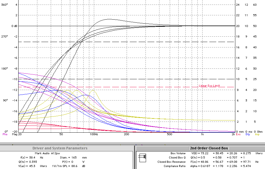

Usually one will use an aperiodic box to lower the box Q of a smaller than optimum sealed box.
So first pass would be a "small” box.
The sim suggests something on the order of 10 litres or less.
dave
dave
