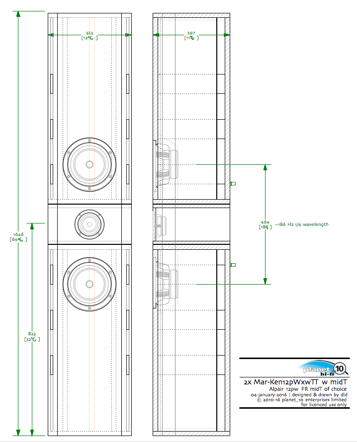

Bernie is building a pair of big Mar-Kens for sngle A12pw. We intend to try it FR as well as see if we can meld a tweeter to it.
dave

note, that's a pair of the 12PW per side, in a "not tiny" (i.e. just under 48" tall) wide baffle MLTL
yes, they produce a helluva lot more bass than a single A10P
35 litre net internal volume.
dave
Dave might have other designs in the works (he usually has).
If the one Bernie is building works out…
dave

Not quite sure how to do the angled cuts on the Mar Ken, but looking forward to seeing Bernies ones when finished.
