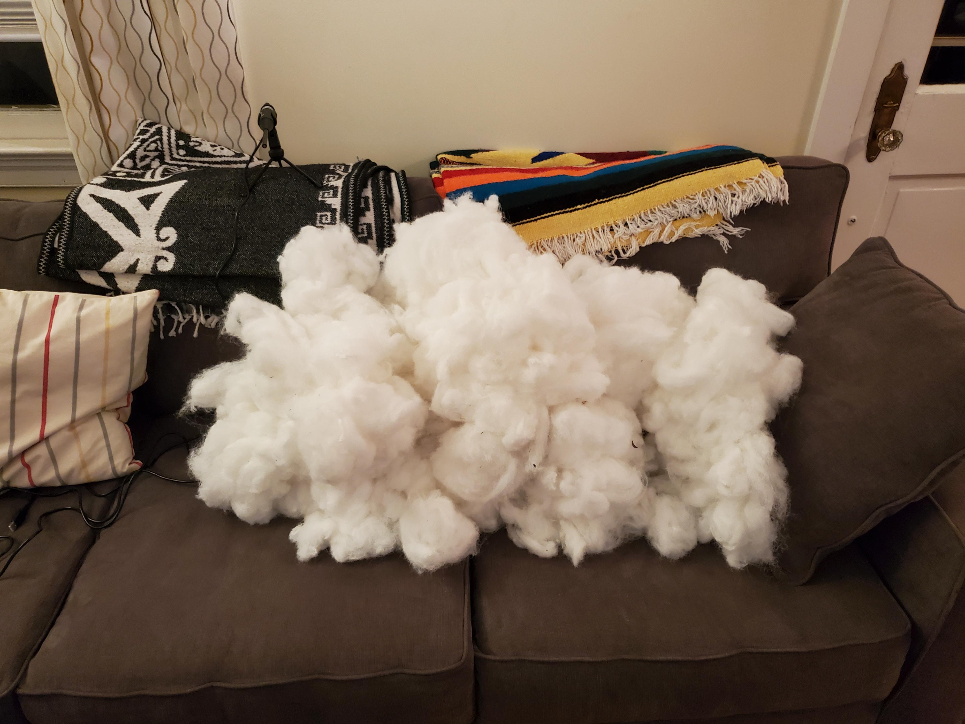

Each box now has 240g of stuffing, teased out to a fare thee well and filling the whole volume.

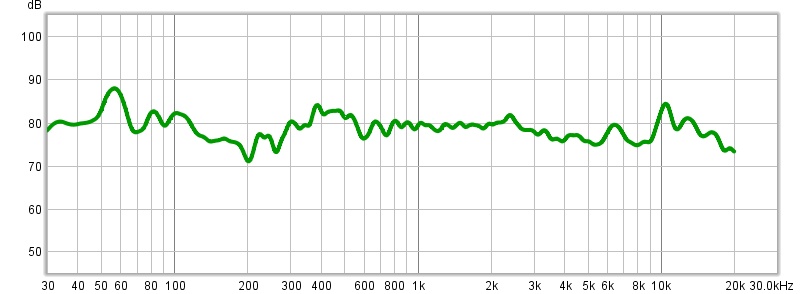

A VAST improvement, both in measurement and listening.
I did a little reading and realized that I am currently out of my depth with impedance testing via REW. Will have to read up some more, and solder up the necessary cables. Not happening today.
In the meantime, I'd appreciate help with interpretation of the new response. The 60-80 hz issues are certainly the room. Can the trough around 200hz also be attributed to that? What about the 8k-10k dip/peak?
This response graph was made using the SET. Will try again with the Crown just for fun.

200 hz is about 2 x 80 Hz and still well within the zone where the room dominants. 80 Hz is about what appens with an 8’ ceiling so most people have that problem.
You might be able to get some insight by measuring the loudspeaker in a different place in the room.
The stuff way up high is the A7. They are not perfect just really good.

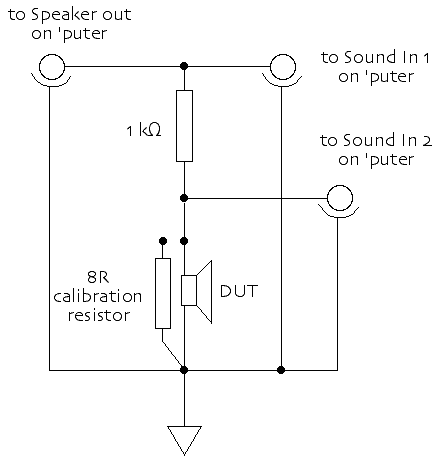

Imp measures are fairly easy. Getting useful T/S with that is trickier. 2 audio channels on your ‘puter and a jug something like this:

PS; the picture of the polyfluf you posted 2 posts back needs more teasing, it should not be “chunky”.

As always, Dave, I truly appreciate your prompt and tireless attention to my projects.
Understood on 200hz. Thanks.
I'll move the mic around some more, maybe measure one speaker at a time. Might reveal something useful.
The 7.3 IS really good, and didn't exhibit the same behavior up high in the Onken boxes. Could be a dampening issue. Could mean that the onken is better for this driver. I'll try to get my head around the impedance testing circuit to find out. Looking at it makes me scared I might screw it up and damage my computer. In the meantime I might play with the dampening a bit and retest.
The fluff in the picture is what I removed. It all looked like that originally, but what is in the boxes now has been teased out to cloud-like, gossamer softness. There used to be 1040g of chunky thickness. Now there is only 240g of wispy fluff, hence the vast improvement in bass response.
