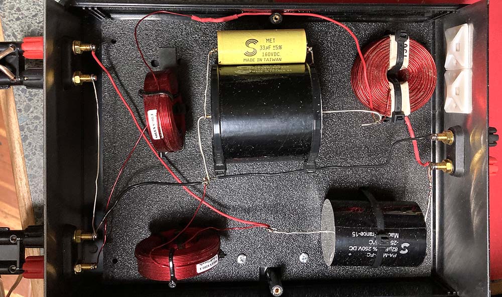

I’m definitely intimidated by that crossover. Was it difficult to assemble?
The parts are big but the XO i fairly simple.

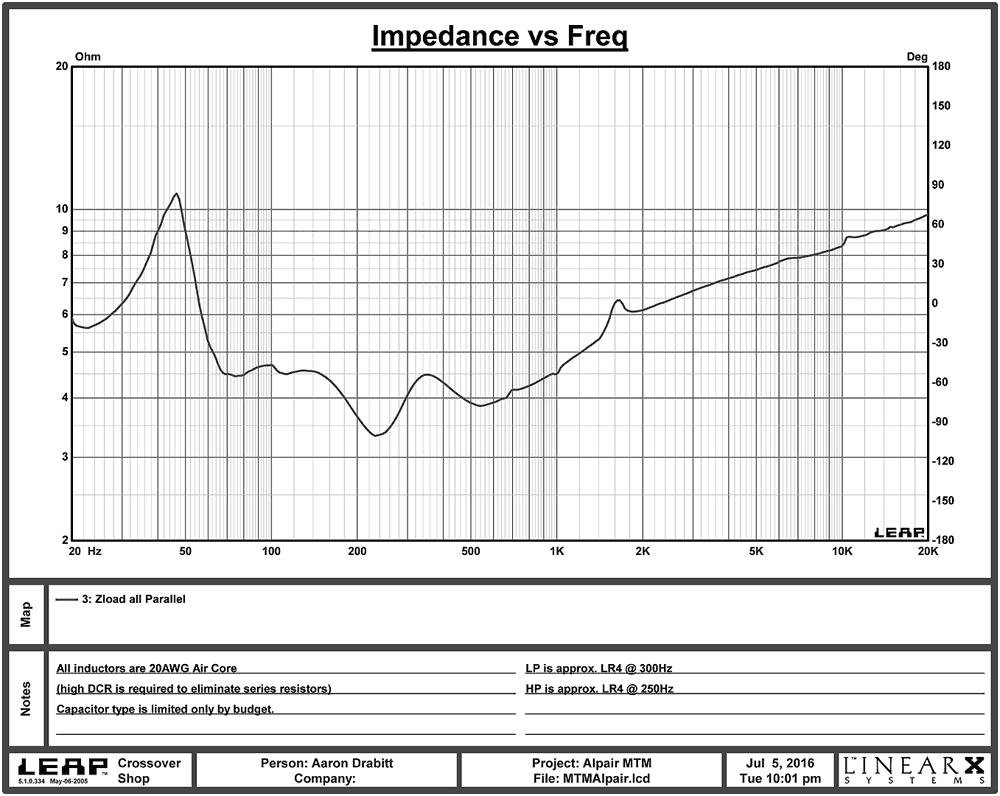

Thanks Dave, if I understand that correctly, it dips down below 4 around 200hz? I assume that’s not uncommon of speakers rated at 4ohms? Is that around the crossover point? Looking at the FR graph is it safe to say that the 2nd 12PW is what’s keeping it afloat in terms of balanced sound? Would a 3rd make help flatten it out even more? I was looking at the box design on the MA site and it seemed a little bit flatter (on the bottom) while using only one 12PW. I also realize flat isn’t always or even usually the goal. Merely and humbly trying to learn before I bite the bullet and build something. This particular project interests me more than others I’ve seen. Very nice job on both the design and the build.
No it is not uncommon. XO is at 250 Hz.
The A12pw plan on the MA site? Is it Scott’s ML-TL? This is the same TL but for 2 drivers.
If one wants a flatter impedance, then different 4ohm in series or 16 in parallel. Or go to 4 A12pw. I have a sketch of that.

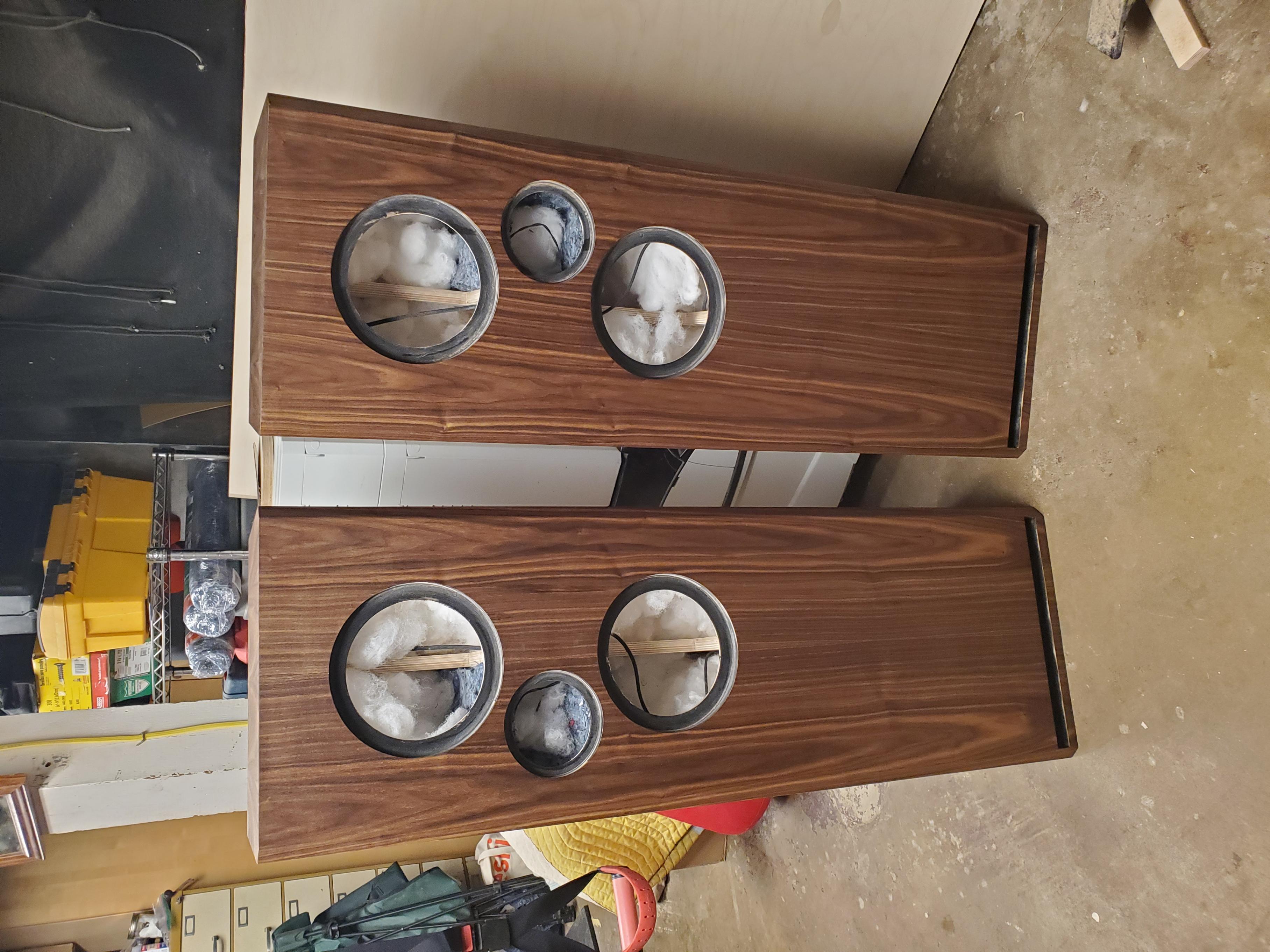

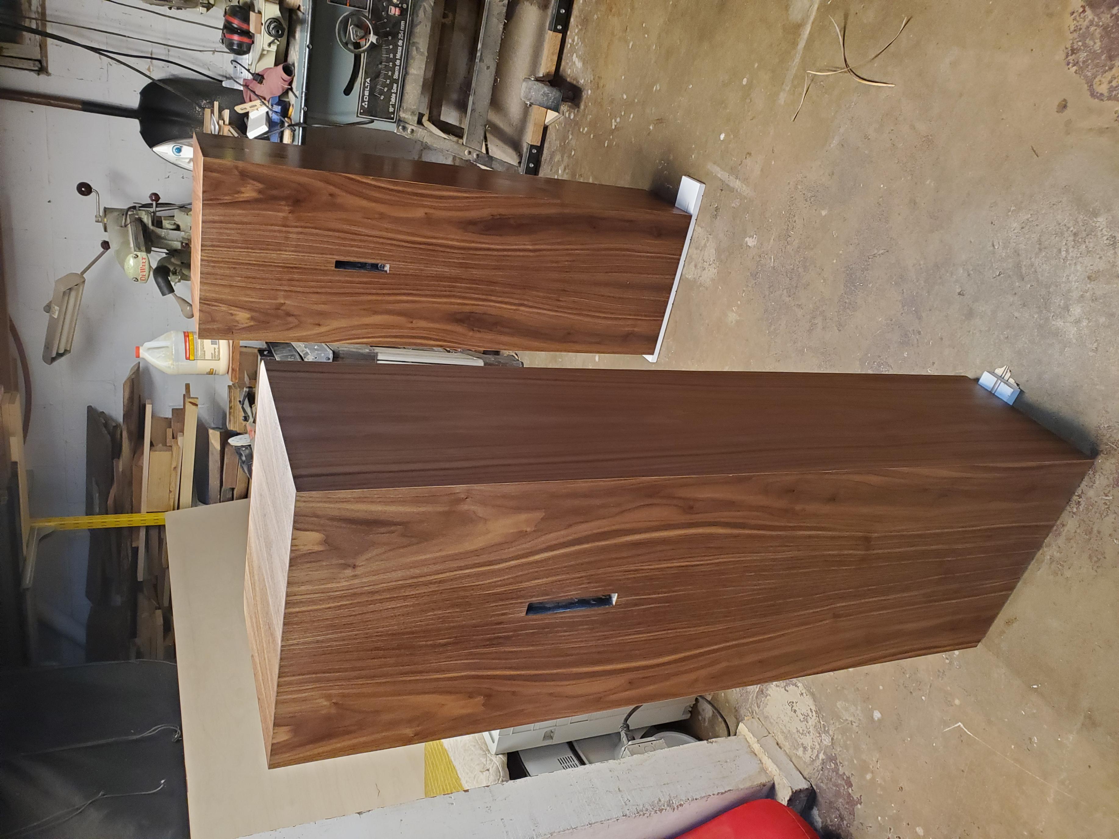

Hey there, 312.
Sorry for the delay in getting back to you. I haven't been on the forum much of late. Too happy with my speakers to have much of a need!
Dave took care of the technical stuff. Thanks, Dave!

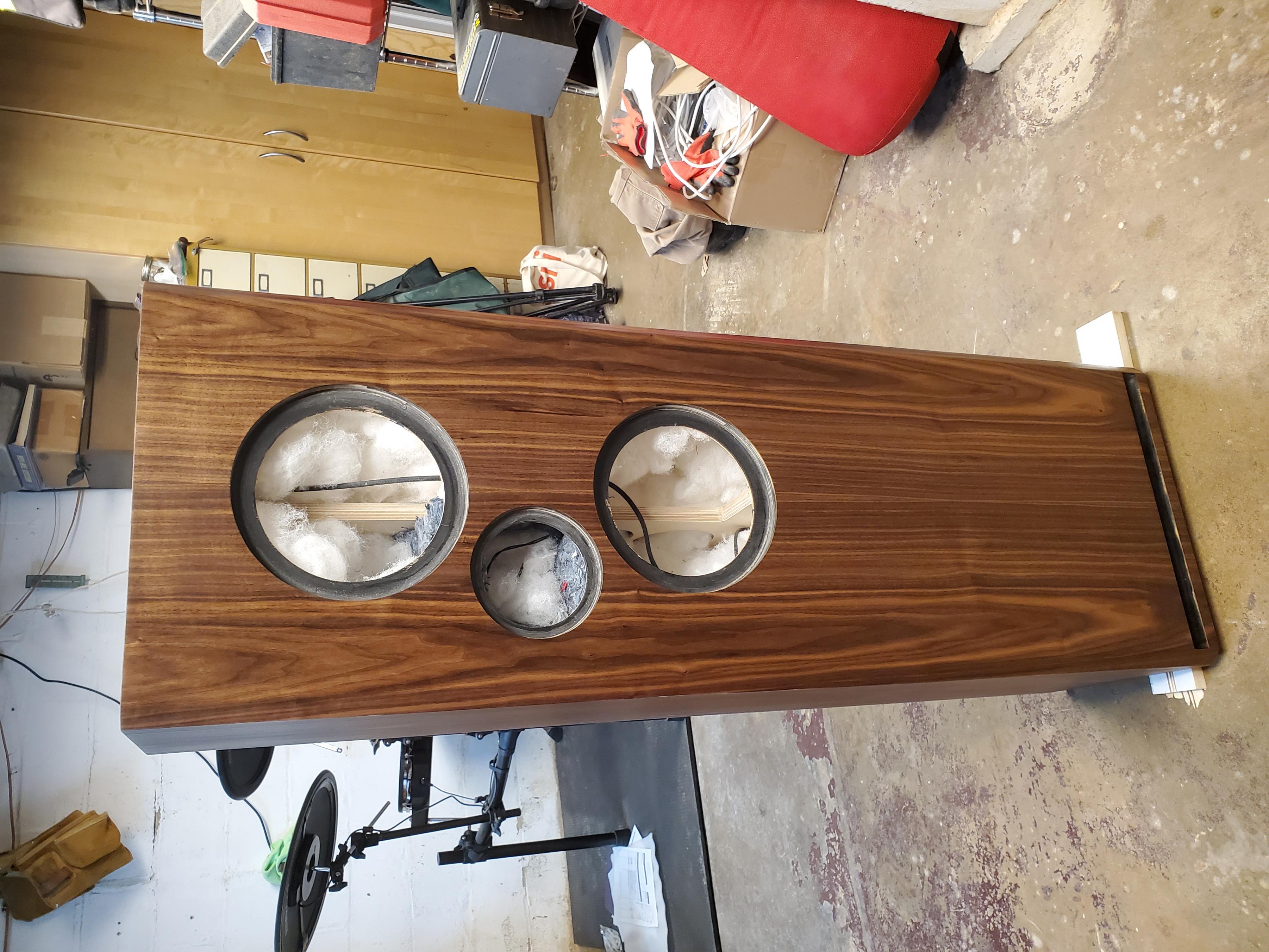

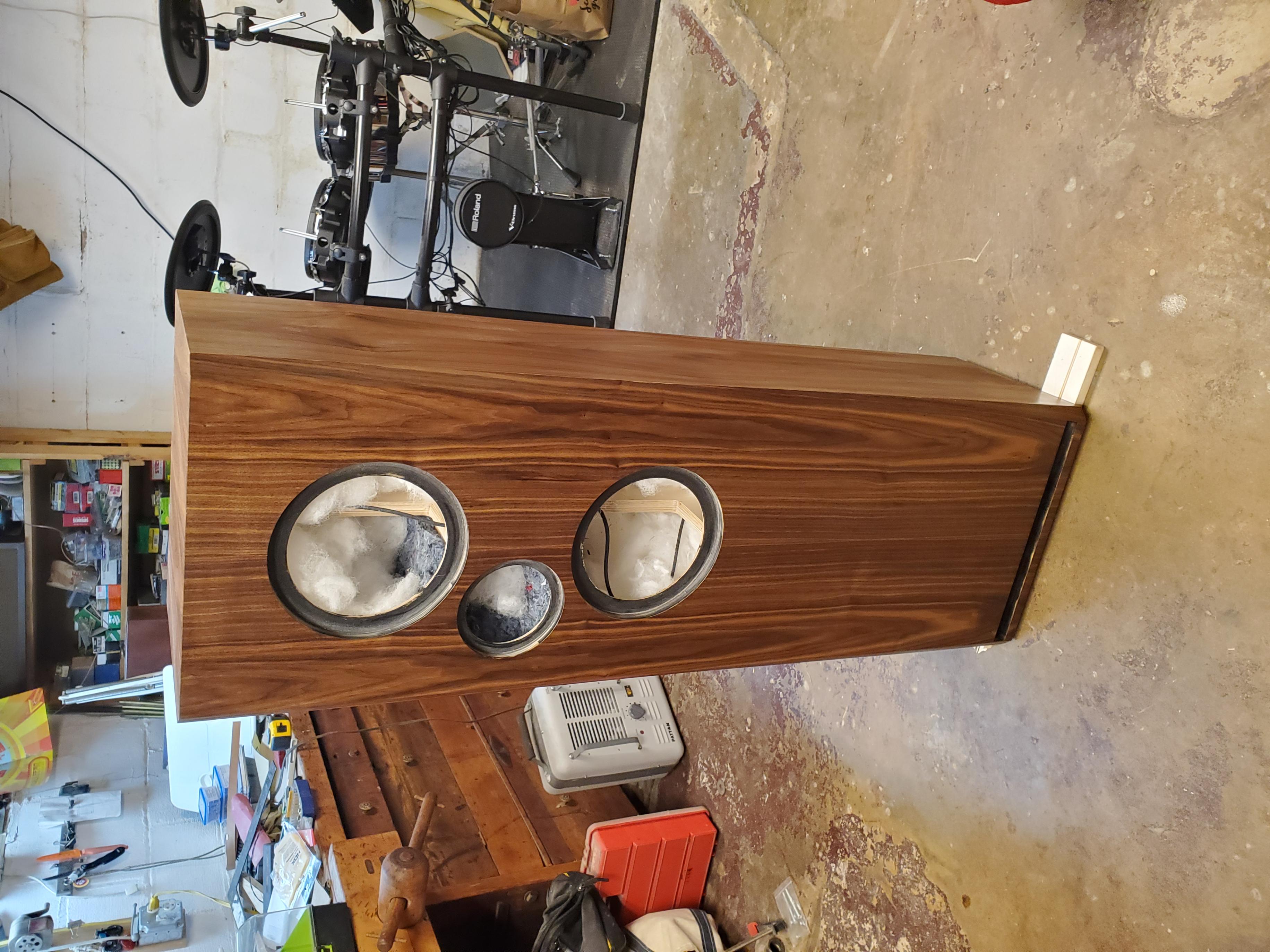

The crossover was really quite simple. I had lots of questions, and made a few simple mistakes, due to my near-complete ignorance of how the components work. Dave was his usual, extremely helpful self and got me through it. The only downside was cost. Parts were around $400. We're all here to help you if you decide to give them a shot.

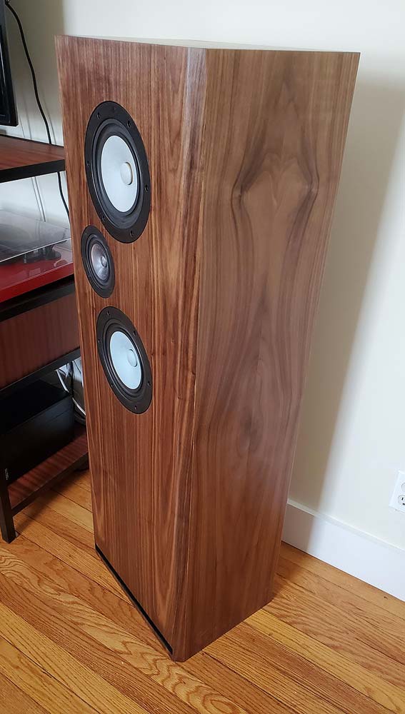

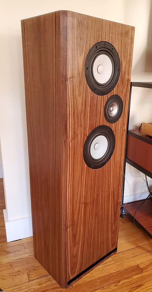

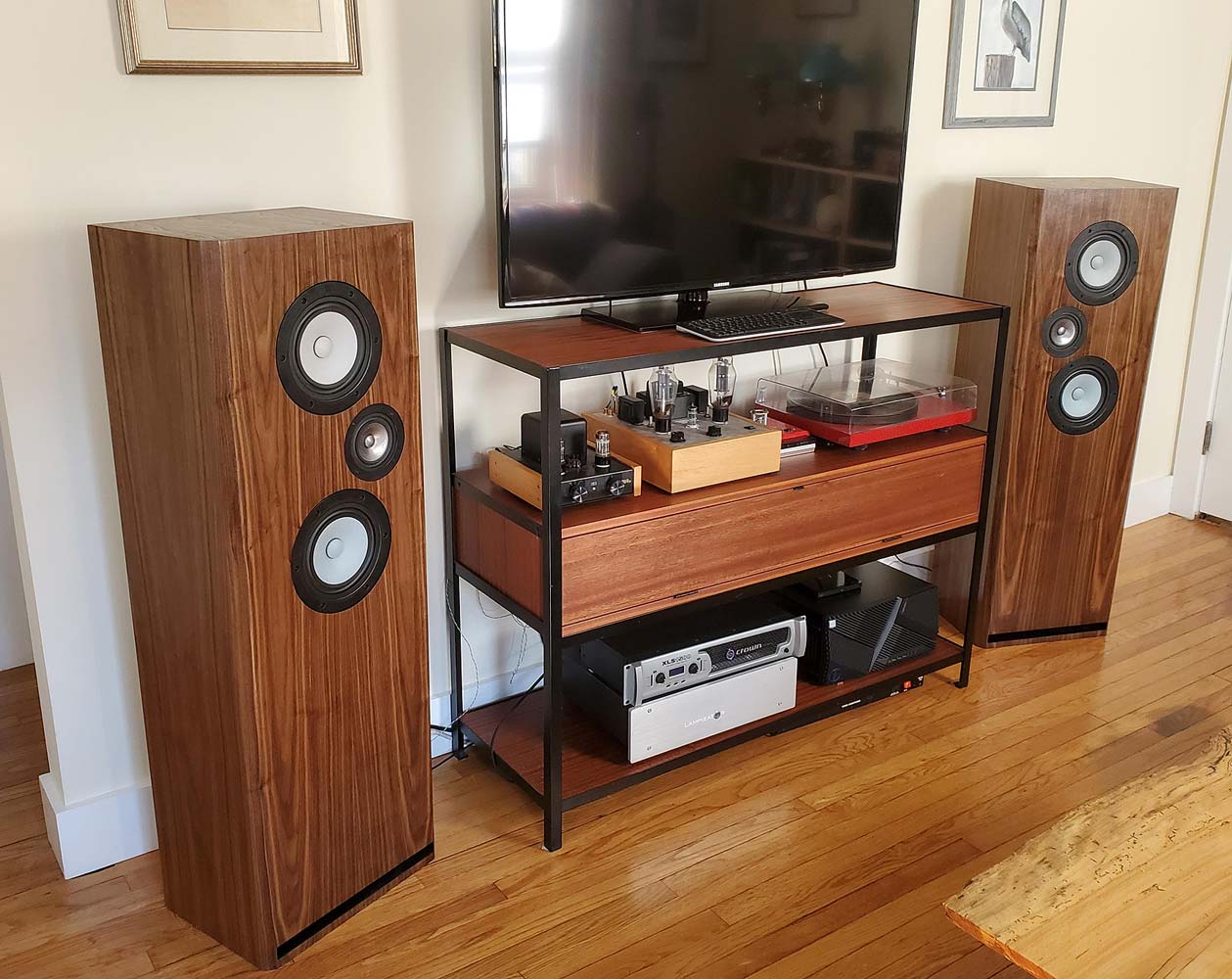

They have been playing perfectly since my last post, often for many hours per day. The sound is sublime, especially now that I am giving them more power. The 3.5 watts was definitely the source of many issues. I was able to obtain an LFD Mk III amplifier a couple of months ago and it changed EVERYTHING for the better. With 60 watts of refined SS power the mids and treble snapped into focus with better clarity, and the bass....oh, the bass. It is all there, with subtlety and amazing extension. I haven't re-tested, but I think they are fairly flat into the mid-20s (room modes aside).

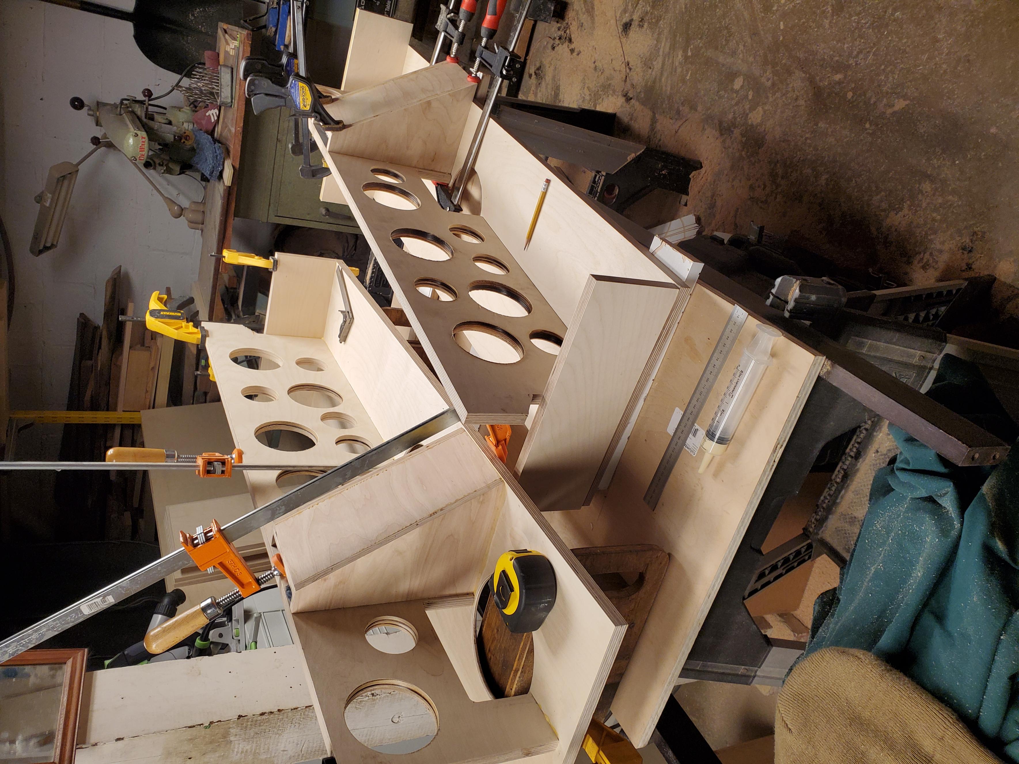

What would I do differently? I would build the crossovers at the same time as the boxes, and put them inside. I've decided I'm going to put them inside after the fact, and it is going to be a major PITA. I would also pay more attention to Dave when he said to really tease out the poly fill. I wasted a lot of time and worry by not teasing it out nearly enough the first time.
My old MarKens sounded great. Amazing, really. These new ones are, I think, their equal or better in pretty much every way. The only exception may be imaging. I can't A/B them, but my (admittedly fading) memory tells me that the MarKens were just slightly more holographic in their presentation. Could be a dispersion issue with the wide/flat vs teardrop shapes. Could be the size of the enclosure or dampening. Could be my imagination. Tough to say, but I am not switching back. Any imaging degradation is more than made up for by the vastly improved mid-bass and bass. Plus, these had the crossover design, which allowed me to try a few amps very easily to dial in the sound.

Alas, the stacked MarKens were a non-starter with my lovely wife. The MTMs are a little bit too tall. The stack was WAY too tall.
