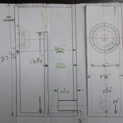

MLTL Alpair 10
View attachment Griffin-A10-MLTL-030611.pdf

nirvana - note that the Griffin enclosures cited were also for previous A10s - the new models, particularly the papers, are quite different, and while the 10P would "work" in the most fundamental sense, there's a good chance they'd be mis-tuned/aligned, and could be anywhere from slightly underwhelming to much worse
finally, what is the best small cabinet for A10P ?
There is no "best" - as in "one ring for all" - least compromised for given situation, maybe
I've found that the simple MLTL format is a widely flexible topology, easily adjustable for T/S parameters of a wide range of drivers. Mind you, thorough computer modeling by experienced designers is only a wild-ast guess as to how a system will perform in your real world environment.
Then there's the aesthetic and WAF considerations - actually in many cases those come first. Since small enclosures often imply the use of stands, often a compact footprint floorstander is much more readily accepted, and can deliver better bass performance.
edit: pardon the "senior's moment", but have you yet determined what the constraints of enclosure dimensions might be for this particular application?
