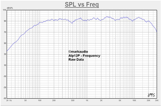

The single driver 12P would be truly unsuitable as a studio monitor because of its erratic frequency response. From the graph shown here, from 130Hz to 17K Hz. From a 90 Db baseline, a -4 Db hole at 470 Hz, and a train of +8Db "ripples" on out to 17K. Forgive me here but you try to master anything with this ragged a response & ....who knows what you'll wind up with.
Monitors should be shooting for a -2+2 Db range ...not a -4 to an +8 Db, let alone a roller-coaster graphing.
________________________________________________Rick.............

J2 sounds excellent on the MA drivers I have had. I would suggest a tweeter for the A12. Heresy, I know, but it is more about improved balance, top to bottom, and improved imaging. I am strongly considering the 10p for a mid in a monitor style setup with N26C tweeter and supporting woofer. MA drivers haev the most wonderful sound and are really only limited by physics. Anyone who speaks against them either has not listened to them or has not accepted these limitations. Most crossovers I have heard are much more easily identified than the variations in the frequency response seen above. Look at the 7.3 response. I can assure you the other than lacking in sub 50Hz bass, and slight loss of image up high due to beaming, it sounds spectacular.
