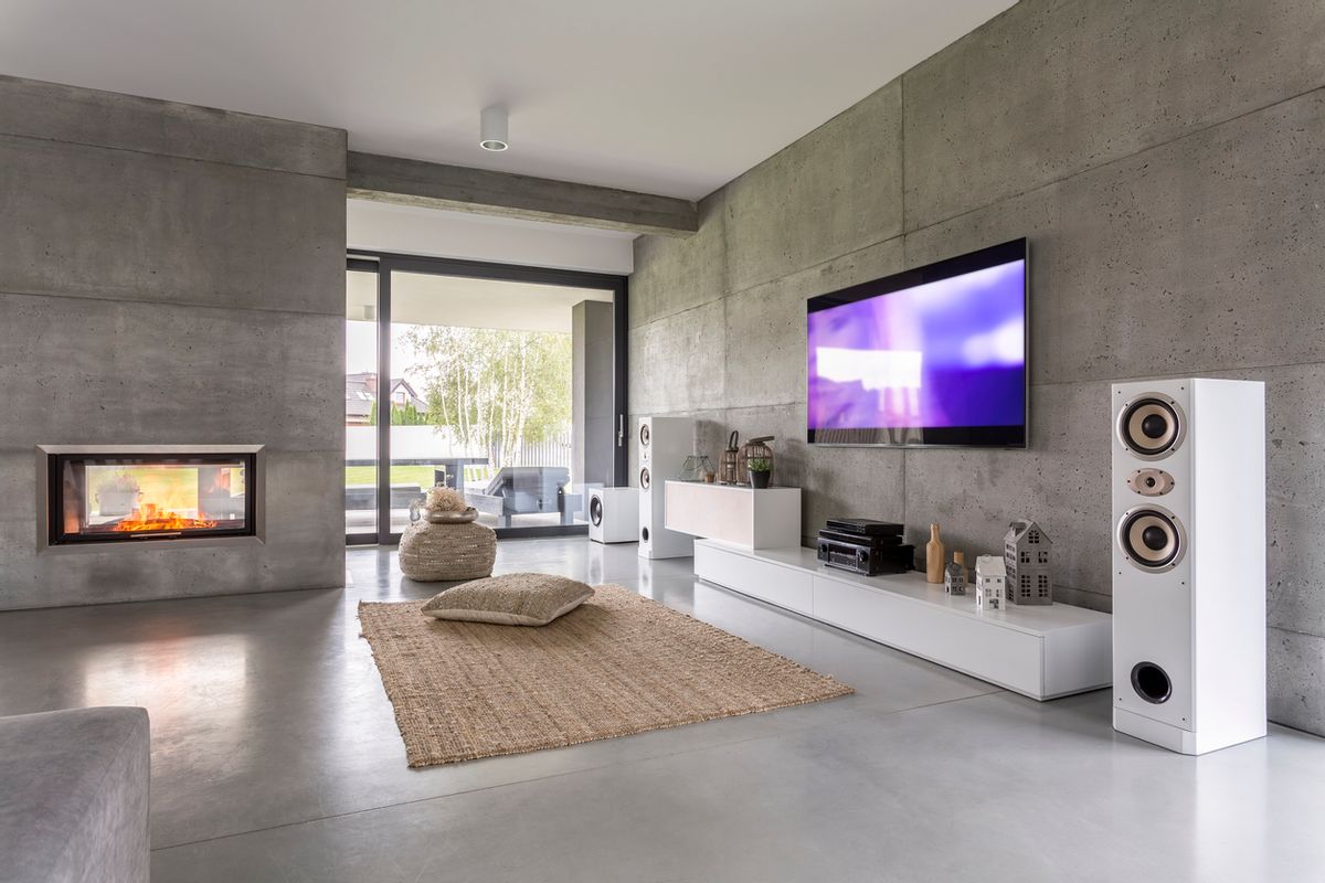

I know, my space is not really treated, but some simple thing like a carpet did change the sound to very good. The only thing i probally still need to do in my space (but i live here since less than a year) is the space behind my speakers, wich is an old brick wall (old in the sence of a 400 years old brick farmwall, very irregular. The back and one of the sides are drywall with a lot of stonewool behind it wich works well, the other sidewall is plaster on a brick wall, but done very irregular (so a kind of diffusor on it's own), and the ceiling is plaster on wood (with a lot of stonewool above the wood isolating to the 1st floor). I did measure it roughly and i have not really big reflections since i put the carpet on the stone floor. For bass traps i don't have space (small space in a 400 years old farmhouse). But the bass is rather accurate here and the room modes not so disturbing. And it's my living room, not a dedicated listening space so i can't go to far in this. The sofa, vinyl storage cabinets, other cabinets and plants already take all the space i have...
And on horror acoustics, i've seen very expensive stuff (like Wilson Audio Alexandria's powered by Pass Labs amps, FM Acoustics preamps and Nagra DAC) in a living room like this one and it sounded like ****...
