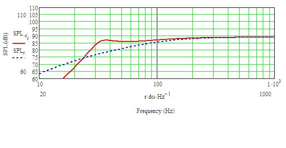

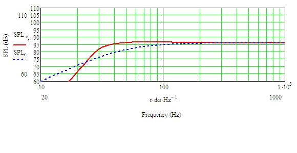

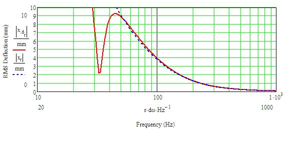

The Alpair 10 models to a F3 in the 35 Hz area in my MLTL simulations. It models a few Hzs lower than my Jordan JX92S version MLTL. Of course like any TL or ported speaker you have limited power handling for low frequencies--especially below their resonance frequency. Hence, you will not have chest pounding bass with drivers the size of the Alpair 10 and the Jordan JX92S but listening to music will be just fine (the exception would be 32 Hz organ notes at high volume levels and the cannon shots in the '1812 Overture'). Furthermore, don't think of them as subwoofer replacement in your home theater set-up.
My work indicates that a 15 liters vented box would work well for the Alpair 10. The box size wants to be a little larger than the Jordan driver needs. In an independent design Bob Reimer of CSS tells me that he is using a 14 liters cabinet with a 2" flared port at 9.25" in length (45Hz tuning). You can stuff the port tube if you wish to act like a sealed box.

Here are my preliminary specs for a MLTL design with the Alpair 10 and the Jordan JX92.
Overall Size with 19mm panels. 600mm high by 235mm wide baffle and 273mm deep. Volume at 21.4 l, minus various, approximately 20 l. 0.5 lb per cubic foot stuffing.
Port at 381mm from top (inside) 20mm radius port 100mm long and 110mm deep for A10. Driver mounted as high as possible.
