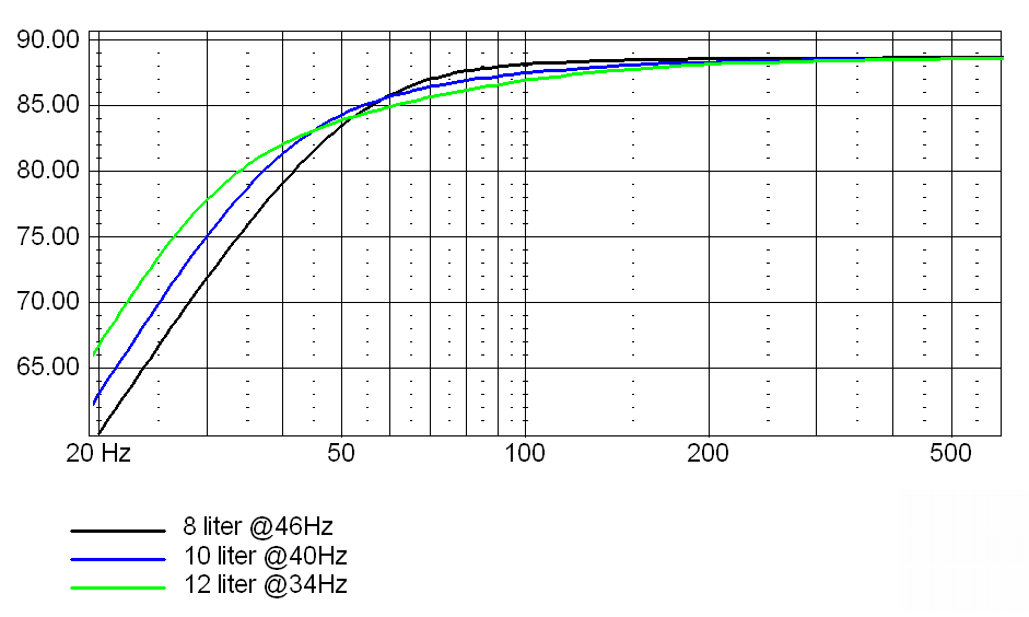

I did a few sims for the FR alpair10, parameters will give plenty of freedom to choose the cabinet size.. I would myself probably go for the SBB4 or slightly larger with the same tune, but smaller BR cabinets are possible (even as small as 6 liters tuned @40Hz will give a nice response).
