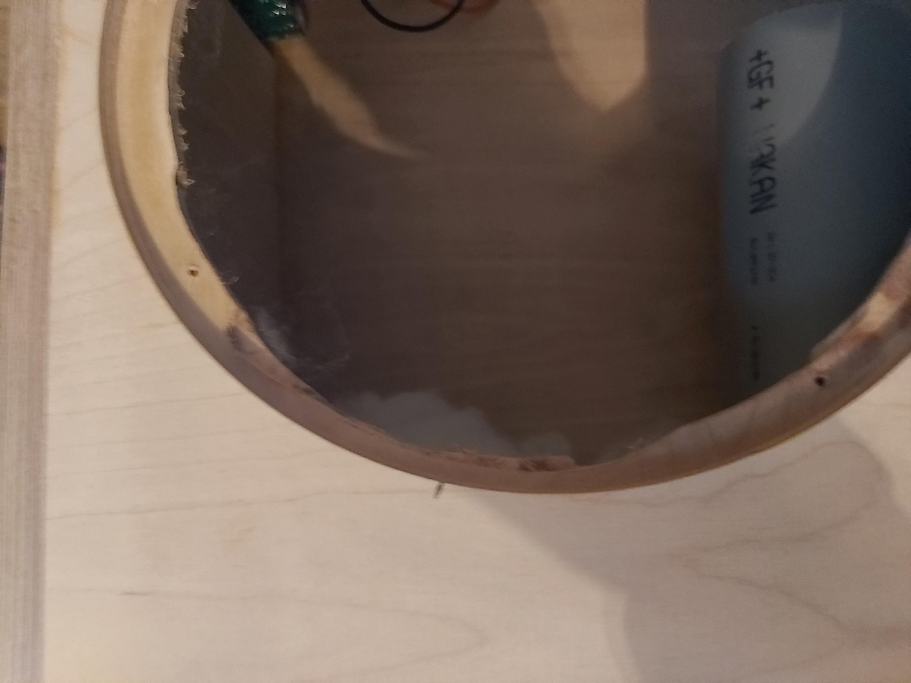

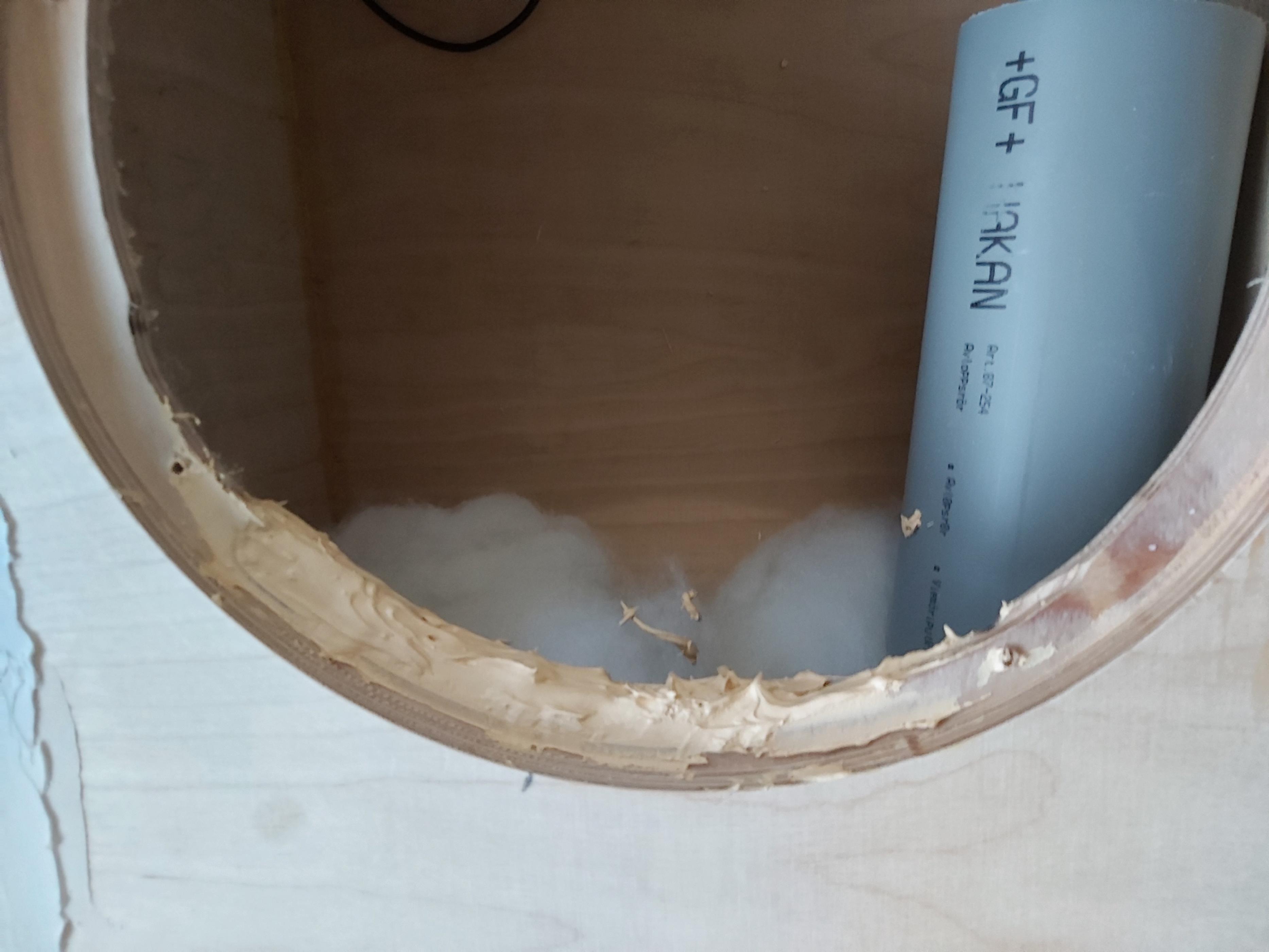

On another note, just finished fixing my oopsie with the router. Small piece of wood glued as support and polyester kit. The smell...
