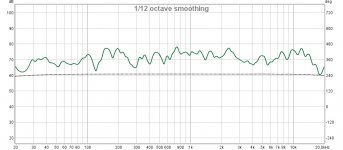

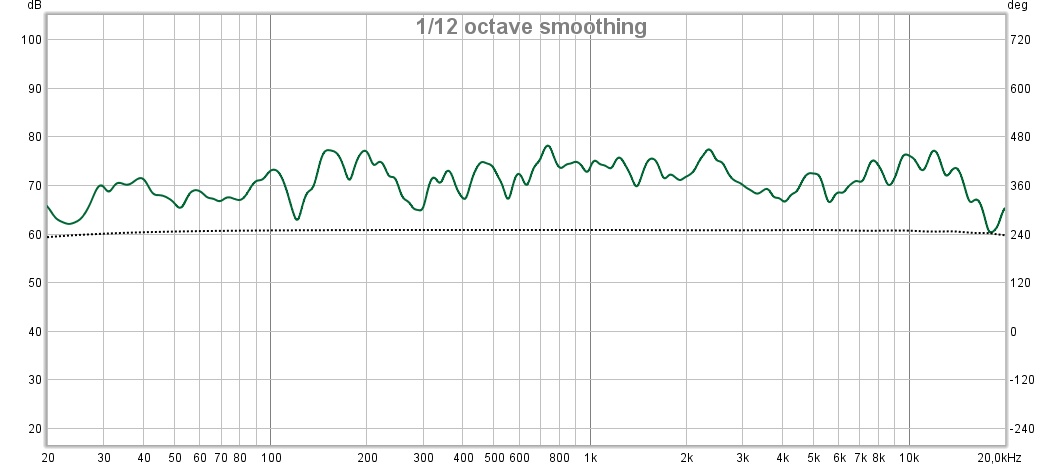

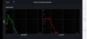

First adjustments and measurements done, not a small task to adjust phase, crossover and volume for all parts separately.
At least the sub part is now adjusted, thanks to Audyssey for fixing the 30hz bump.
Next step far & near field measures for all with REW. I think I'll test a higher crossover, now it's 80hz.

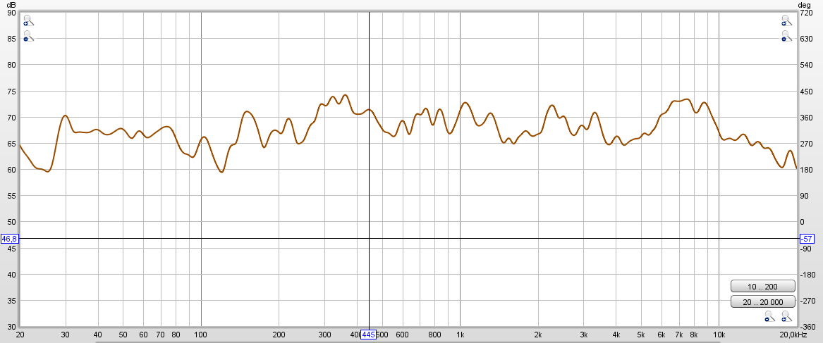

So, measurements done and still happy with the results. Might try a little notch filter for the 5-10khz range, it does sound a bit bright but not annoyingly.

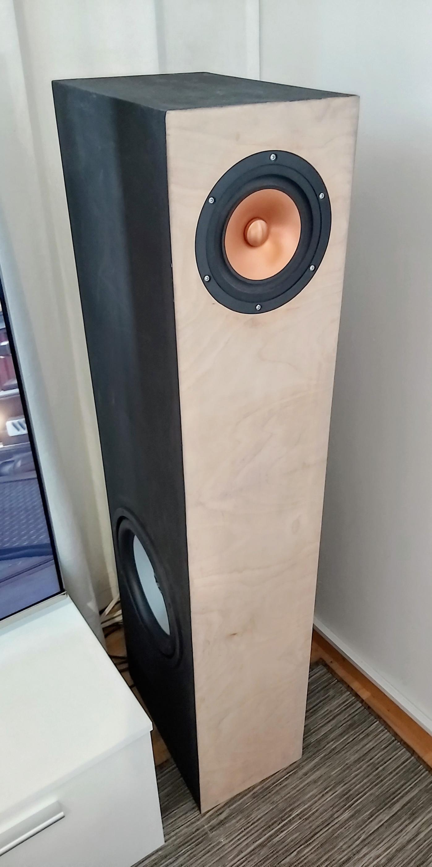

The sealed Alpair 10.3 measure down to 30hz -6db without subs but they are crossed over at 80hz to keep the 80-200hz area smooth.

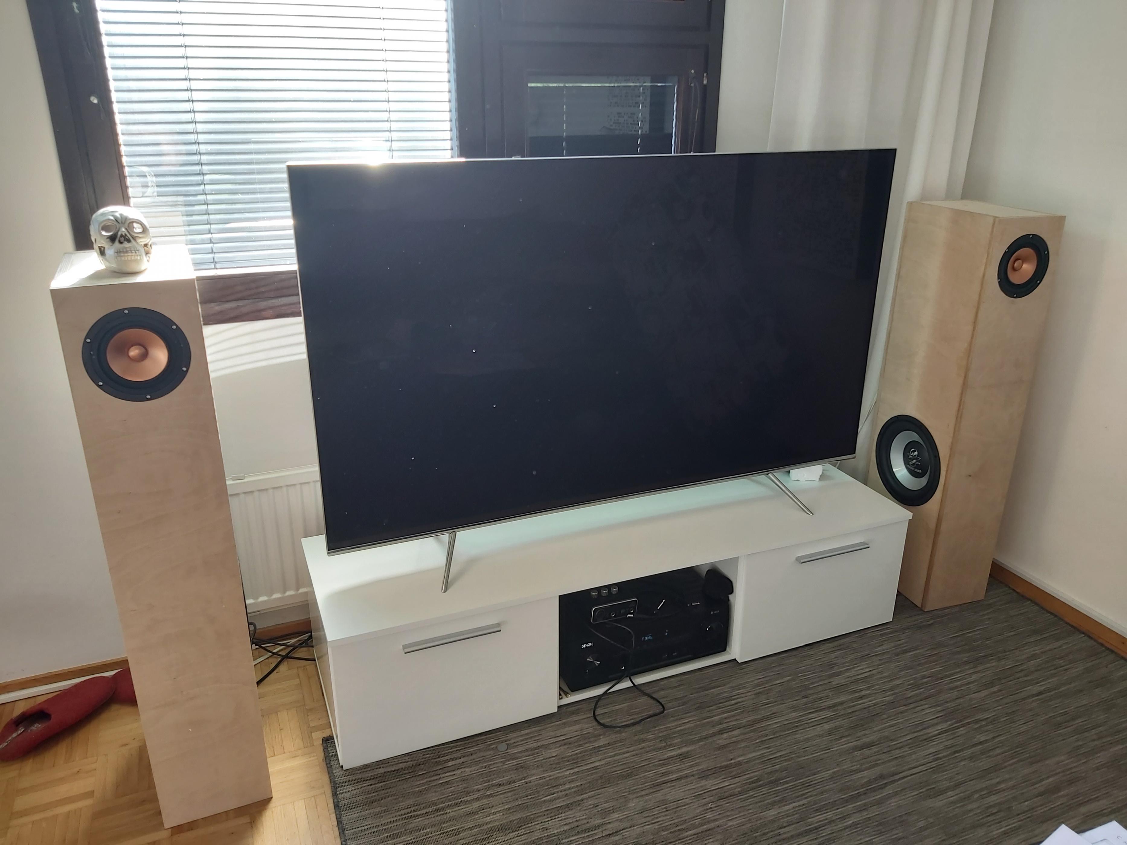

All in all the total costs for the pair was around 500€ - 200€ for the plate amps, 200€ for the elements and 100€ for plywood & misc.
Now just need to finish the surface and prepare for painting.

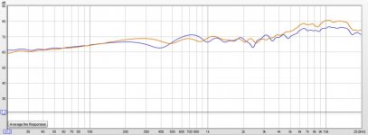

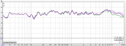

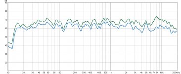

Finally proper(?) measurements and might want to try a notch filter for 5-10khz range.

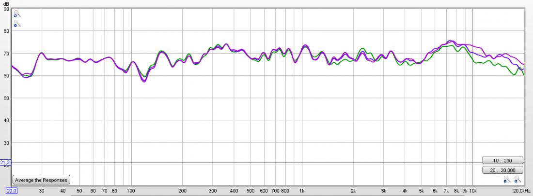

Looking at the graphs, first one is individual speakers wo subs at 1m, second one both at listening position with 3 different angles (0-5-10 degrees inwards)
Filter calculator gives me a series filter with 0.2mH coil and 4.5uf cap, does that sound right?

I'm already listening off-axis, but that still leaves the 5-10khz range around +5db. If I turn them away, that drops the 10-20khz too much down but 5-10khz doesn't go down much.
It's a trial, I might prefer without the filter but also looking to build my skills with speaker building and measuring. Doesn't hurt if sound improves as well.

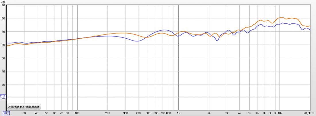

I played around with the calculator and I'll try first with
R:10 Ω C:9 μF L:0,05 mH
That should cut just between 5-10kHz as needed but let's see.

Today I learned two very important lessons:
1. Audyssey (my room correction) setting "Flat" corrects the WHOLE frequency range, regardless of any limitations set. This was messing with all my measurements, now I managed to set the crossovers and subs to pretty perfect combination.
2. The 5-10khz bump was caused by early back wall reflections. I accidentally did measurements with some clothes lying on the sofa back and poof - the bump was gone. So, instead of needing a crossover (already ordered, dammit) I need to add some light treatment to the back wall.

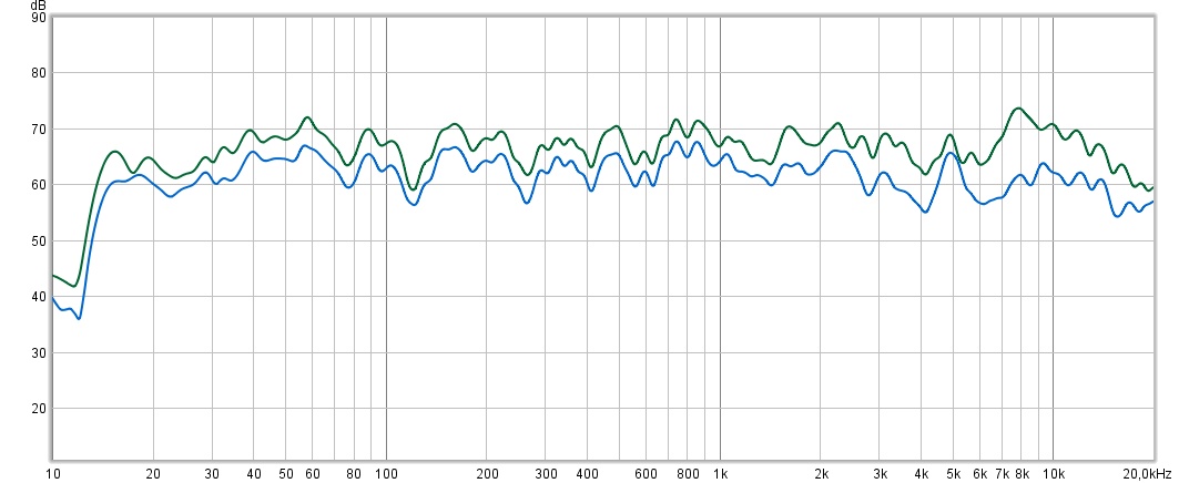

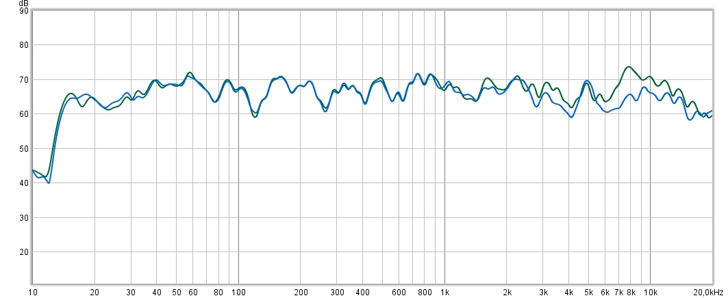

Here's the measurements from listening position with the crossover. It does exactly what I wanted it to do, which is quite a suprise considering my complete noviceness.
Subs also adjusted, now giving decent response to 15hz, still room for adjustments but need to focus on listening for a while, the new album from Tool is sounding brilliant!
