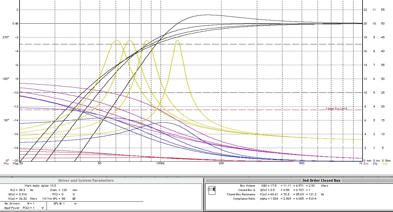

My sim suggests that 6 litres or a bit less for a damped sealed box with max flat alignment. But anywhere up to about 15 litres would be fine.
How high you cross depends on a number of things. Yesterday i summarized many of the things you should consider when placing the XO: FAST (WAW) build help and opinions (Post #18). You’ll probably find other relavant info.
But…
I am not familiar with the plate amp you mention, but most do not have a real hi-pass function. That makes them best used in what i call a REL configuration. Run the FR sans any filters, just using the 2nd order roll-off of the box. And then bring the sub in elow that. For a ~6L box that is going to be about 85 Hz. That low you have the option of running the woofers in mono. I like to run them stereo but your room will likely let you know which is best. 2nd order on the woofer HP would be symmetrical, but they often come 4th order. Again room, and how hifh doe sthe woofer go.

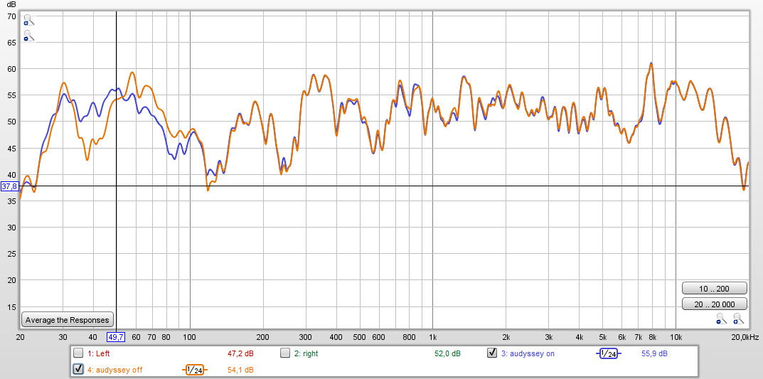

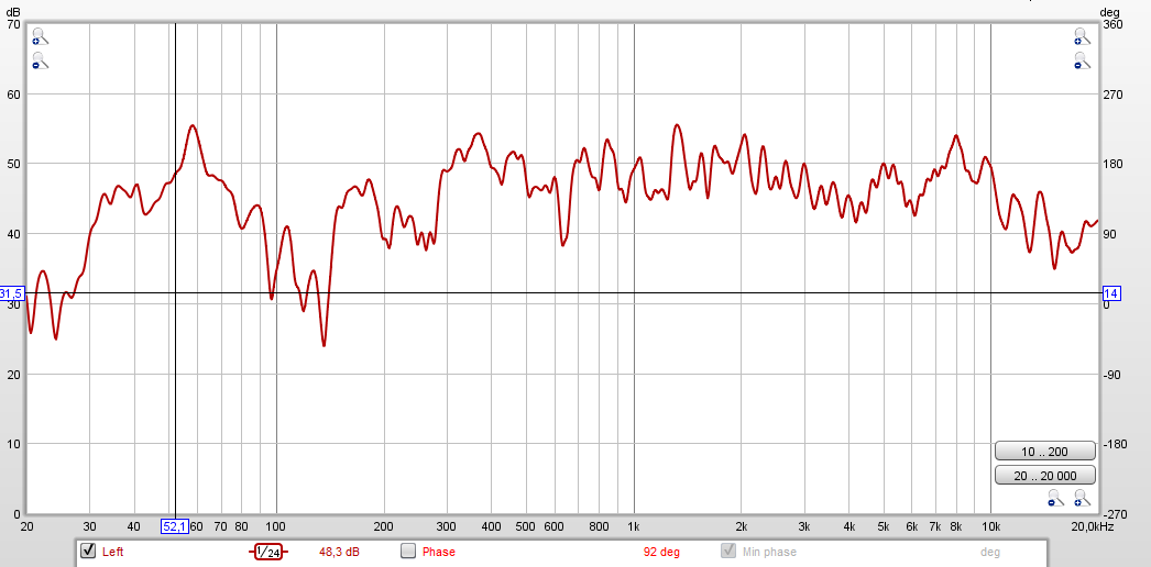

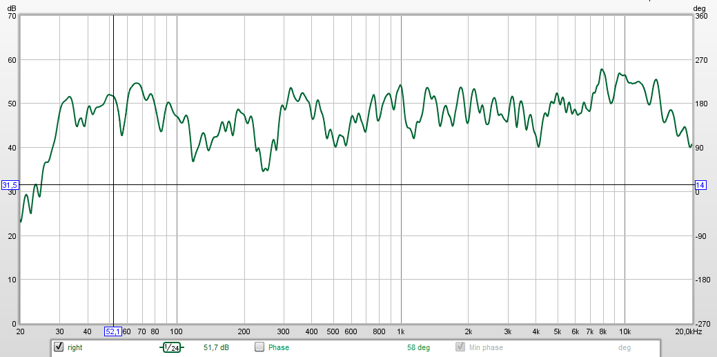

I managed to measure my current prototype sealed boxes and I'm quite happy with how it's looking.
This is from the main listening position per channel and then both channels with the current under the sofa sub in action.
Left side is opening into a large space and it shows, right side is getting a great boost from corner placement which results in quite a nice smooth response?
May need to bring down the high end >8khz a little?
Looks like the Alpairs are pretty smooth down to 30hz so definitely no additional low end stretch needed from larger enclosures. I'm hoping that my stereo subs will help sort out that big valley between 80-150hz, I'll need to experiment with different crossover points and sub levels.
Any other opinions?

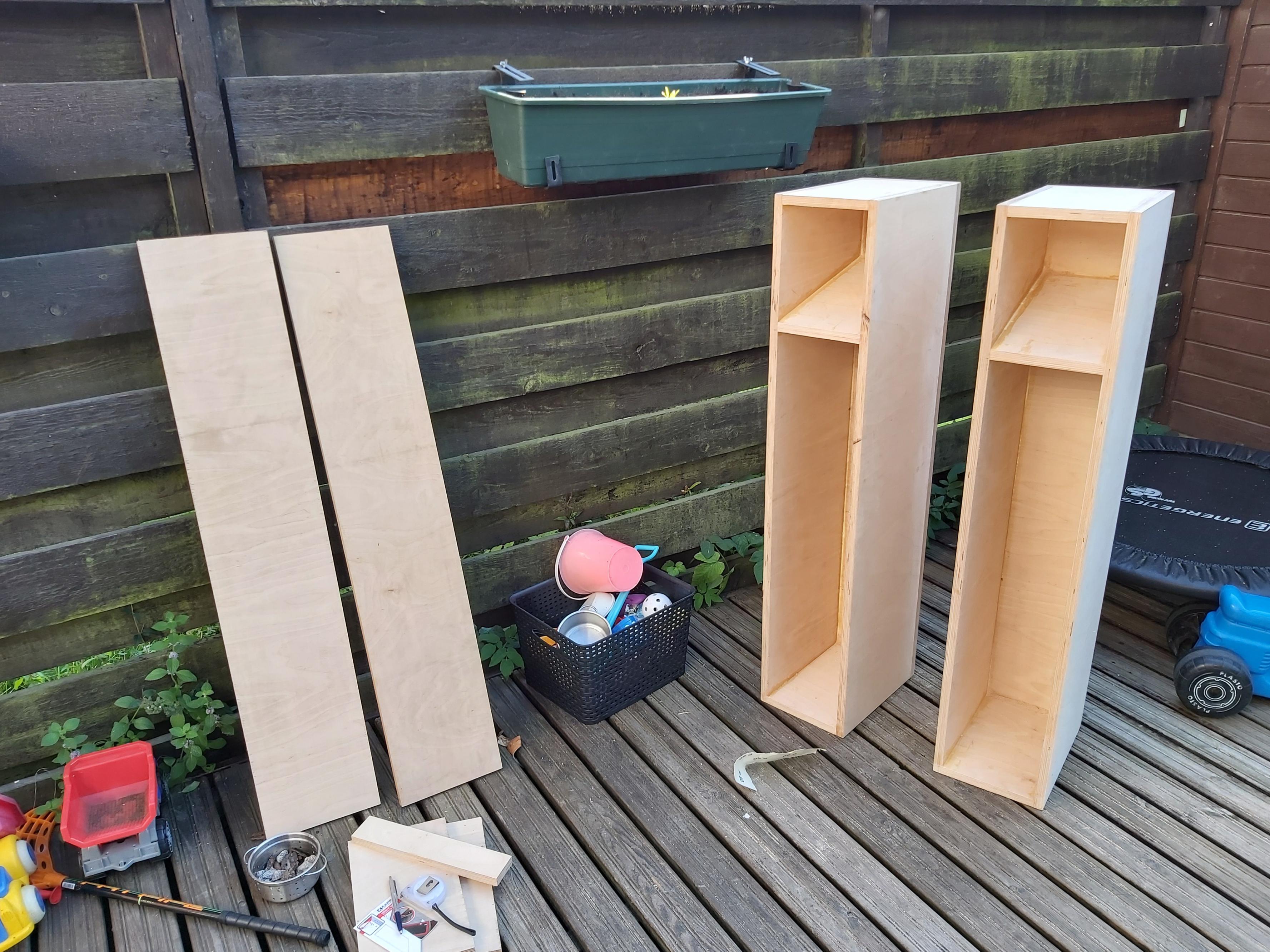

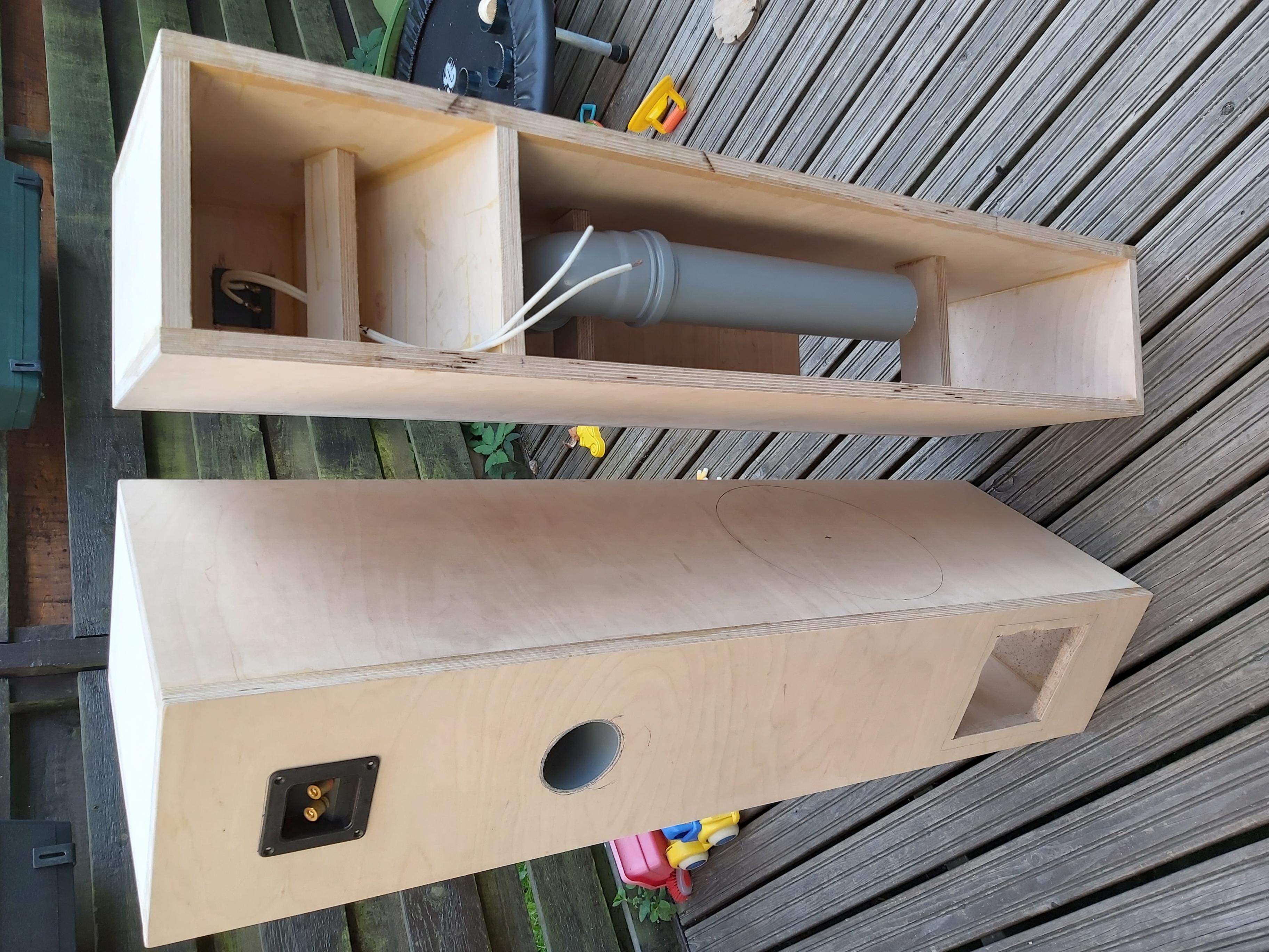

Building started, still some bracing to be added and I'm missing a router but so far so good. All parts are ready, will assemble when I find the router.
Really easy to build from 18mm birch ply and Titebond, earlier prototypes from 12mm were much trickier plus Titebond is the best glue I've ever tried!
