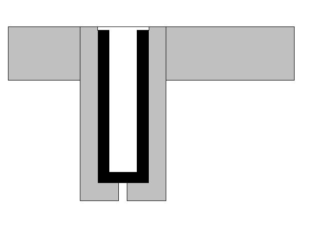

The motor in this table apparently is very similar to the AR, but unlike the AR the platter is a single piece. I had a similar table at one point and reinstalling the belt after tinkering required nothing more than a stiff piece of solid wire shaped as a hook to slip it over the motor pulley.
The main bearing arrangement looks a lot like the one used on the AR-XA. Should be a hardened steel plate at the bottom of the bearing well.

There is a small hole in the bottom of the aluminum casting where the bearing socket is. It looks to me like (I used a flashlight) the bearing is a solid one piece affair and the hole is there so it can be driven out. I have atached a crude graphic - the black u-shaped thing is the bearing.

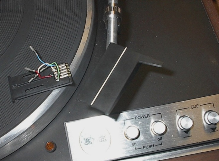

Now I am perplexed. The buttons on the front appear to be
for speed change. There are two buttons marked 33 and 45.
Above are marked POWER and below are marked PUSH.
Given you have one piece platter manual speed change is
not an option.
So how does it work !? I'm lost because there is no simple
way of switching the speed of a synchronous motor, i.e.
you cannot adjust voltage or current to change speed.
Does the motor pulley only have one size, if so very confused ....
If it it has two sizes then there must be have been another solenoid ....

The motor pulley is double, two sizes. The belt has to be manually moved from one groove to the other.
The buttons on the front are "on", "off", "cue up, "cue down".

OK, what I assumed was 33/45 is in fact ON/OFF.
Well 33 only then. Setting up to work well with both speeds can
be a pain (the belt keeps falling off on the lower pulley, and if you
raise the motor too high it limits the suspension travel) as you
have no 45's simply do not buy any.
I would assume only the thrust pad can be pushed out from the bottom.
If so if it comes out relatively easily it should be inspected for wear.
The ball bearing may be "stuck" to the shaft - if there are no signs
of wear then this can be left as is.

I think I'll leave the arm alone, except to glue the head shell on(?) - it's very loose.
I took your advice, found that cartridge and bought it. It comes with an elliptical stylus.
The tube has lines on it, spaced about 1 inch apart but no numbers or other markings.
The mat is in good shape. The seller send a felt mat with it.
I'm looking forward to playing with this. 🙂
Do you mean the carrier or the slide ?
again photos would help but presumably the carrier is held onto
the arm with a screw from underneath You are saying that this
arrangement between carrier and arm tube is very loose ?
Buy all means then epoxy it but make sure its glued parallel to the platter.
Pictures of the slide / carrier arrange would be good.
What is the height to the mat with the arm tube level ?
MJL21193 said:I took your advice, found that cartridge and bought it. It comes with an elliptical stylus.
The TP4 body needs epoxying to the 1/2" carrier and then as the
epoxy gets thicker a goop of it should be applied between the
carrier and the cartridge body, to fill the obvious gap.
A 0.3 x 0.7 is pretty good for a bushed elliptical, most are 0.4 x0.7.
I've seen places charging $70 for it, at $20 it should be a steal.
Track at 1.6g +/- 0.1g.
One would assume these are spaced at 1 gram intervals.
The felt mat supplied can be cleaned and cut to the correct size.
Then bitumastic spray the reverse side if you like, to keep it on.
Personally I'd expect the rubber mat to be the best, felt a bit livelier.
Presumably your going to get it going to see what its like before
the full new plinth and bitumen spray nearly everywhere rebuild ?
If nothing goes wrong (early attempts) getting to the nitty-gritty
of what makes a turntable sound good and improving it, often for
peanuts, I found quite rewarding, the skill is in not overdoing it.
🙂/sreten.
The carrier is loose on the shaft. There doesn't appear to be a screw in the bottom. The slide fits snug, but the wires that connect the cartridge are in rough shape - need to be re-soldered.
I have attached a picture.
The stylus is .3 x .7. I bought this for $14.95 plus shipping for a total of $21.00.
When I get the new cartridge, I'll give it a spin. If there is a problem with the motor, how hard are they to find? Would it be wise to replace with a different manufacturers motor, or should I stick with an original?
