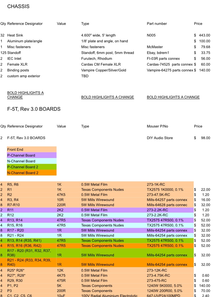

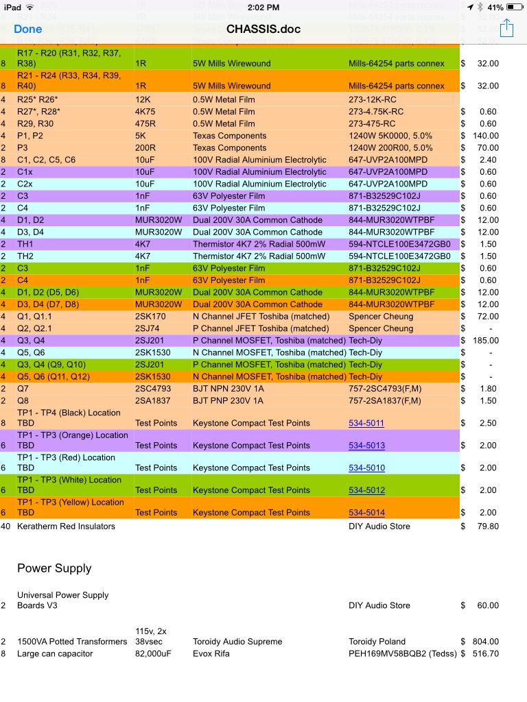

I did just finish ordering the the balance of parts from Mouser for the F5T v3 boards, pair monoblocks, except as previously noted and below;
TX2575 nude resistors from Texas Components for R1, 13, 14, 15, 16, 35, 41, 36, 42.
Vishay trimmers from Texas Components for P1, 2, 3
From Parts Connexion
Mills MRA-5 resistors for R3, 4, 7-10, 17-24, 31-34, 37-40
For the chassis I ordered a pair of IEC inlets, Furutech FI-03(R). Includes a fuse holder, and Rhodium plated copper alloy conductors. And for binding posts I ordered 5-way Vampire BPHEX/CB. They are gold plated over silver over copper base (not brass).
So now on to ordering parts for the power supply.
I have the DIY boards and have ordered 8 Evox-Rifa large screw top terminal caps, 82,000uF, 63v. 4 ea per monoblock.

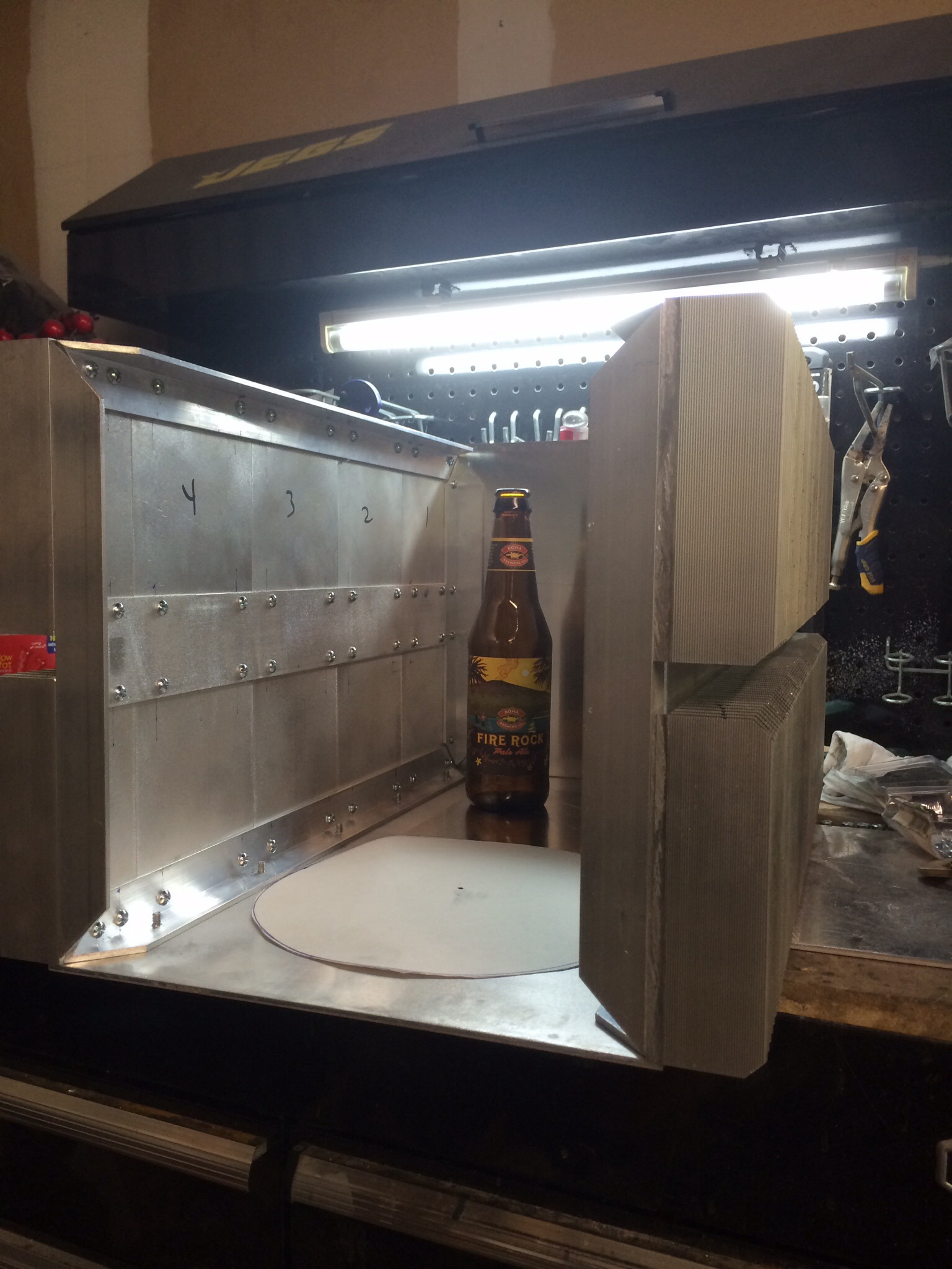

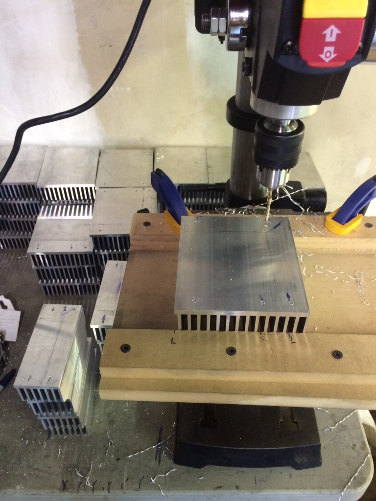

In building my chassis I know I'm going to need to drill and tap over 300 locations and then drill another +300 holes through the member to be attached. So for accuracy and speed I purchased an inexpensive ($130) drill press.

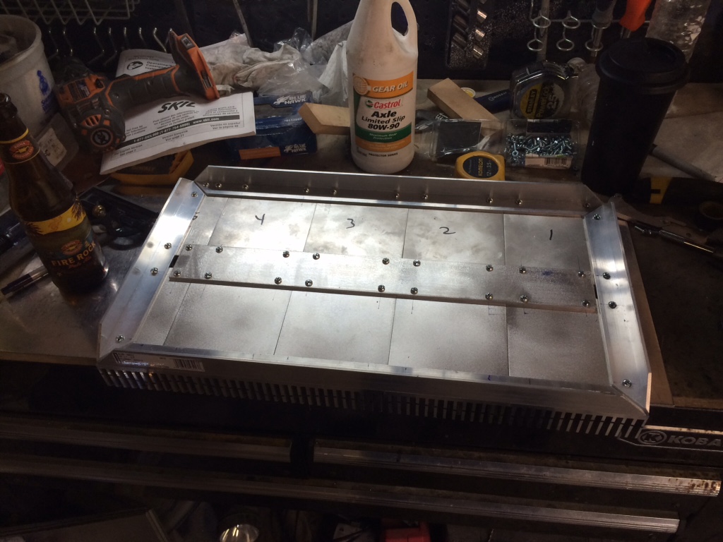

So here is the first of the 4 sides of the monoblocks
And here is what the backside looks like
The angle is 1" x 1/8" and the flat stock is 2" x 1/8". I will be using something else permanent for the flat stock. I plan on installing a very small fan in each monoblock pushing air into the chassis with the exit through holes or slots (haven't gotten that far yet) through this center mounted spacer/support, this will help cool the interior. The top and bottom heatsinks are separated by 3/4" (19 mm). I'm hoping that by spacing the heatsinks, and suppling additional airflow between, that the efficiency will be increased.

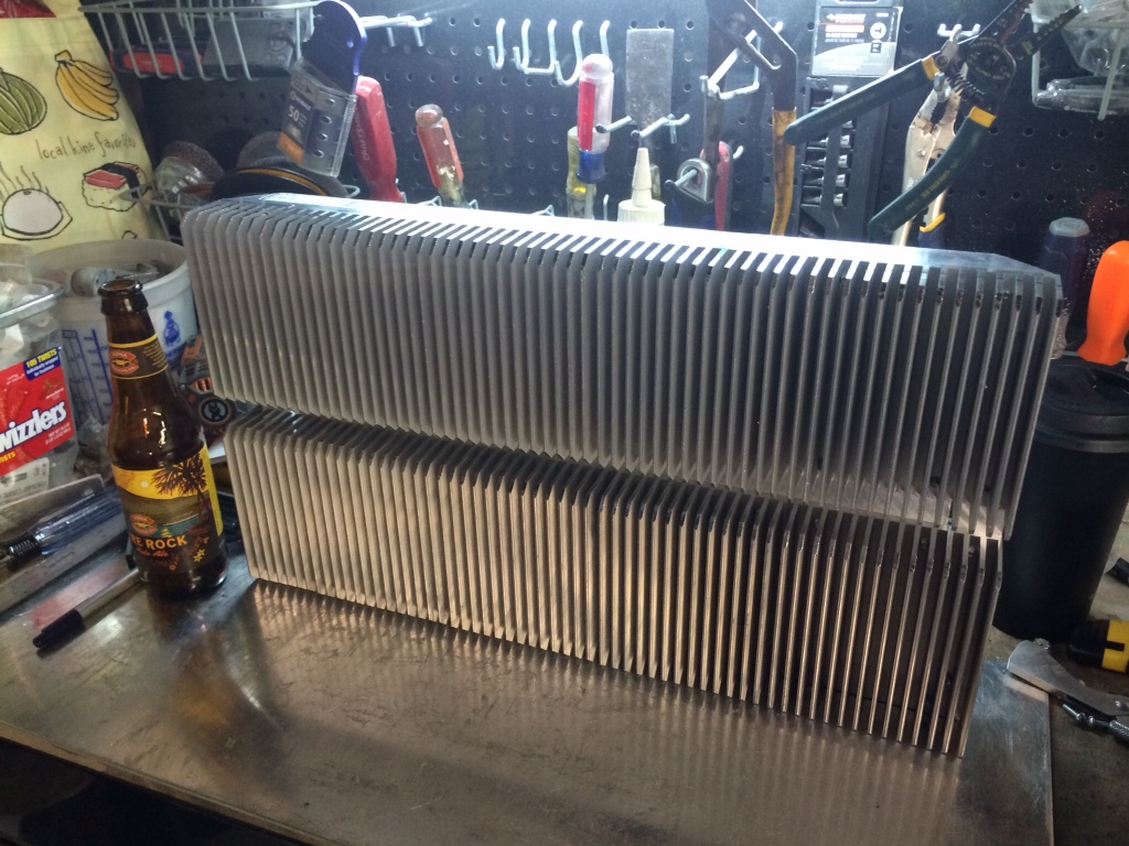

Hmm I'm not so sure about that.
I like the fact that he has two 'sets' of heat sink banks top and bottom.
In fact if you keep the top and bottom banks separate, as in leave a gap and not use a conductive material to join them like the aluminum you use, you may get better thermal isolation from one heat generating FET to the other.
I think somewhere on one of the F5T build threads it was suggested that 2 smaller heatsinks would be a better cooling option than one big one that is the same size as the 2 smaller ones combined.
Maybe I misunderstood Avwerk's comment. I understood them to mean compound between each small sink so it would act like one large sink?Hmm I'm not so sure about that.
At least that is how I plan on assembling. Right now I'm thinking of using 2 washers between the 2" flat stock and the heat sinks to 1) leave an opening for the exit of the air I will be pushing into the chassis and, 2) to minimize heat transfer from the lower sink to the upper sink.
The top, front, and rear panel will have another finish material, covering the aluminum. I want to minimize heat transfer to that final finish.
I appreciate all the feedback, thanks.
