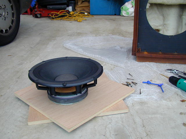

a good transducer for 2-way systems as an alternative for expensive full range ones is the fostex 12W360 (only available in used condition) - go to the attachment or to
http://wanko.pecori.jp/cside/12w360/P1014896.JPG
found by

the last pic under post #5 - go to
http://www.diyaudio.com/forums/subw...ubwoofer-precision-devices-pd2150-inside.html
shows an example for a sandwich enclusure (no parasitic sound at the walls from cabinet). The top uses the 135LB transducer from Supravox - go to
http://www.supravox.fr/anglais/haut_parleurs/135_LB.htm
