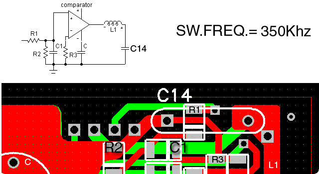

I got this in my files from classD forum. It's quite interesting, how a "hocus pocus" can be explained technically.
If we interchange the PCB position of C1 and R2 (they are parrarell), the diffence is huge (350khz VS 3Mhz).
