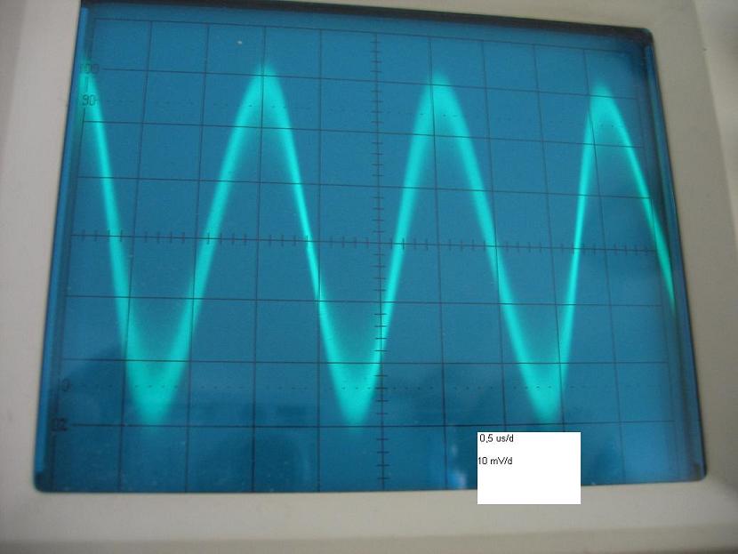

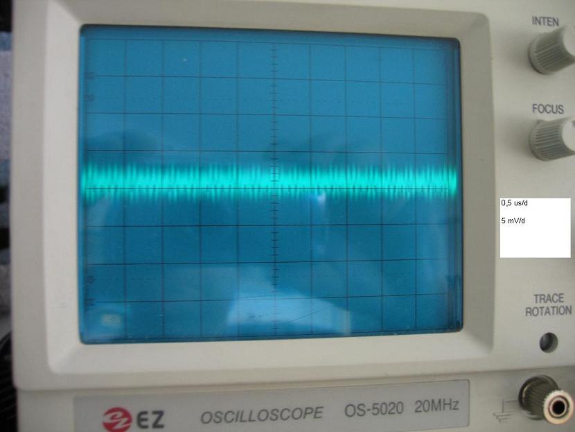

I think the EMI/RF issues are the key point today, given that airbourne and conductor-bourne RF hash has quite possibly increased at least one or two orders of magnitude in the last 20 years in the typical domestic situation.
And from experience (with musican's gear and industrial electronics, mostly) I know it is very hard to make something really HF-proof, especially when you only can modify the gear. But even when newly designed from gound up it is very hard and costly to get there, and (if one believes the rumours) the typical EMI "add-on" countermeasures like ferrites on signal/speaker and power lines may also have a negative effect on sound quality.
I have not found any typical consumer HiFi-gear so far (no access to the top-level stuff, though) that didn't fail with the simply cell phone test, showing the typical TDMA buzz. And way long before the buzz is clearly heard by itself it will affect sound quality.
- Klaus
- Klaus

I found another big source of RF gunk came from CCFL lamps. Especially these small screw in types. A lot are made in China and to be honest, they really radiate some crap.
While I was working on a proto amp a year or two ago, I went mad trying to find the source of the HF hash. After about an hour I remembered I'd just replaced my overhead bench light with a 15w CCFL. I turned the lamp off and the problem disappered.
Problem is, when you try to make a circuit RF hash proof, it probably affects th e sound (no proof of this, just my thought on it). Speaker cables make great a great input antenna for the amp. If your circuit uses a small cap across th e feedback resistor (now there's a reason for zero GNF!) you can get garbage straight into th e front end.
