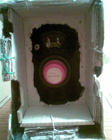

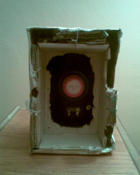

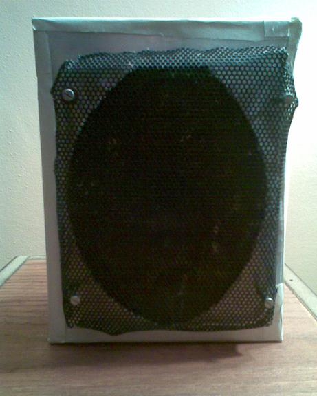

I found da dreky ting....
panomaniac said:
Ugly!
As our buddy Choky would say. 🙂
Speakers themseves are not bad, they have this "tone" that makes one to like them, even though they roll off quite early...
On the other hand, the open-back enclosure is really ugly (not Choky's ugly)🙂 , but I left it as is...
Zen Mod said:
OK- Iskra or RFT ?
I've no idea. There are just some numbers on the back, and 8 ohm....no Iskra logo...
Anyway, this is a bit OT...
The whole point being that
1. Yes, Open Baffle performance is so good that you won't mind if it looks ugly...
2. Old speakers, like that one, used to sound better than than most today's counterparts...
