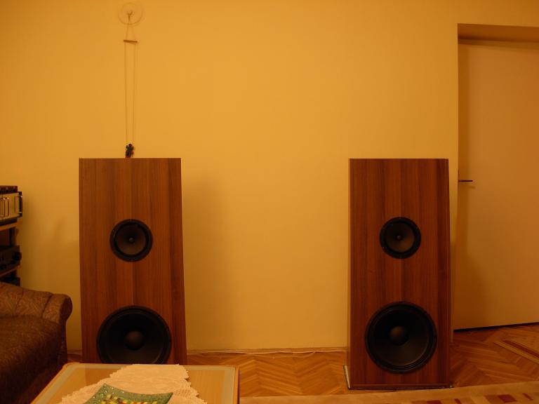

Now some pics of the current setup...

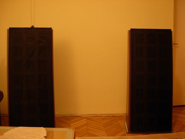

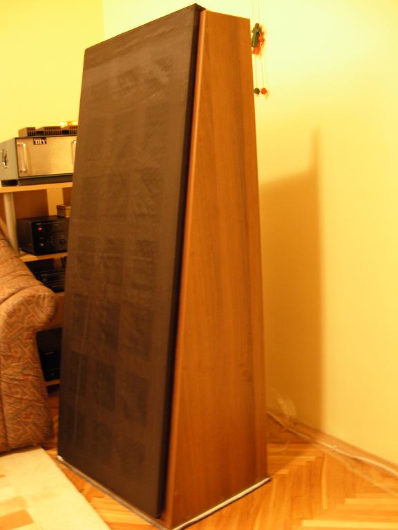

My local carpenter built me some wooden grills with a cloth over it. They just "hang" on the frame, and are removed when music is playing...
I was too scared to leave them naked and exposed... (Even though magnet is on the back of the speaker, it attracts kids fingers, usually through the dustcap...) :att'n: :cannotbe:
More pics...

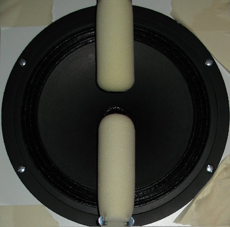

4kHz on the 8A. Try running direct with a piece of 1.5" dia light foam sponge (roller or carwash) ahead and just clear of, thus covering the lower half of the dust-cap as seen from the listening position. This will disperse/filter some of the 8A peak prior to roll-off without affecting the electrical input to the driver.

An example of foam response shaping is photographed below; here on an 8" Visaton B200.
