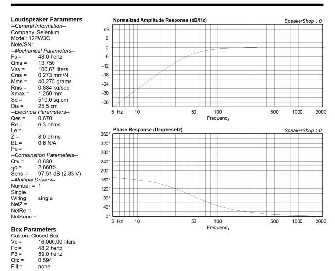

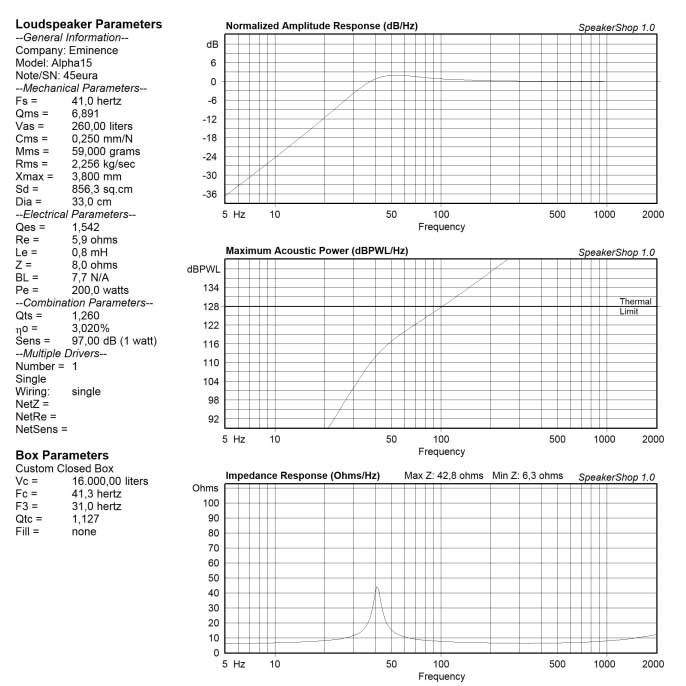

Seleniums. I was quite surprised when I simulated these units, not out of this world they seemed.

I wrote " just for fun " - you see that's for closed box ......... even if 16m^3 big
but - difference between Alpha 15 and Sel PW12 can't be seen in graphs published on net ....... except sweeps from third party .....

I don't have time ( sorry ) to look for sim progs for OB , lately ....... what I meant is just to make comparison between these drivers in same conditions ....... not trying to emulate OB ; of course that IB never can be same as OB , and vice versa .
tell us just one thing - it's obviously clear to you , but for us isn't
and - is it good in simulation , or you tried it in vivo - too ?

Good Spirit ! In fact I actually simulated the Selenium 12W3 when this was talked about. It will have a remarkable efficiency in OB but not streching down very low in frequency. Overall I would say that the Alpha15, like MJK has shown, will have quite a flat response down to 40 Hz in the baffle we are talking about. The Beta 15 will also be good not reaching flat as low as Alpha15 but may be with drier bass. As always with loudspeakers you have to compromise ! I never heard Selenium, Alpha15 or Beta15, I have used this unit for OB, also extremly linear down to 42 Hz: http://www.traumboxen.de/ad-audio/r1524.htm

Does anyone using the Eminence Alpha 15A use any electronic equalisation to prop up the bass ? The simulation seems to show that it holds up very well up to about 40 Hz.
