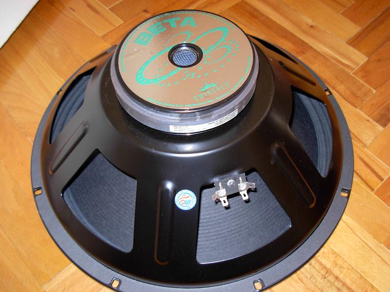

I avoided a reply but instead took the brand new digital camera out of my bag. I promised her one, so this was the right moment.
Ya see the picture is nice, don't you? 😉
(Shot by Nikon coolpix L5)
