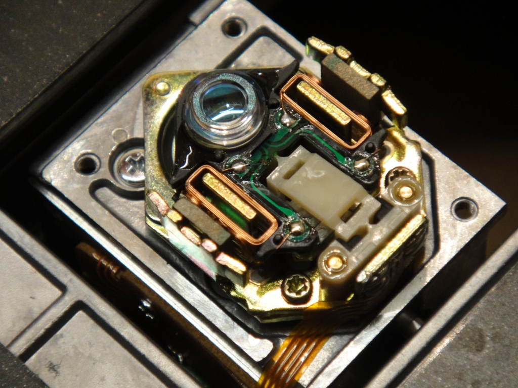

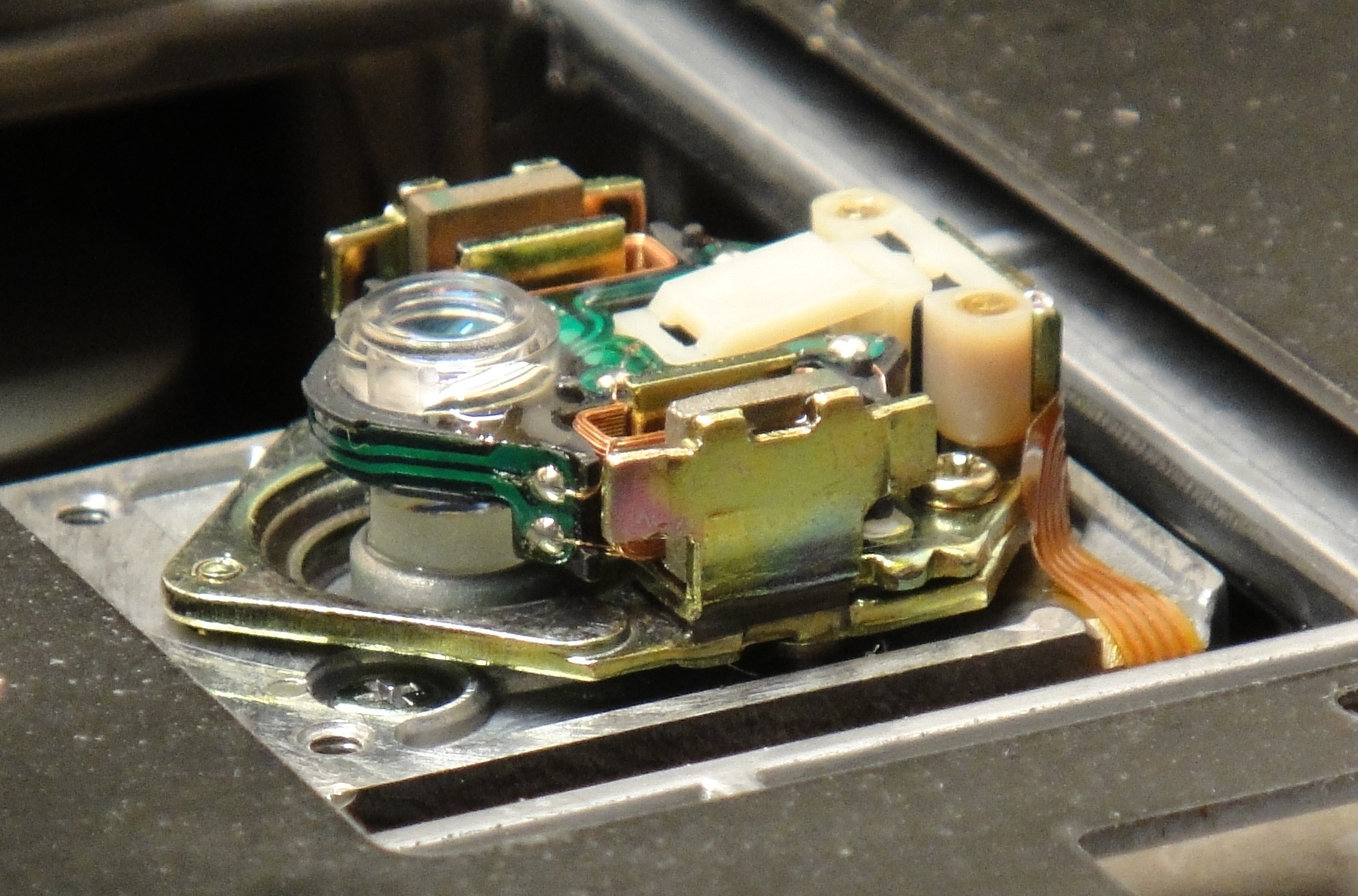

Investigating a loudening rotation-speed ticking, now focusing on the, er, fucusing. Sadly suspecting a weakening laser 🙁 Eye pattern manages just 0.8-1.0V
I notice that the radial motor sensing coil is 6k when it should be 2k according to the manual. I can't see how a single coil can go wrong, so I assume the manual is mistaken, again.
Anyone managed to replace a laser/monitor diode in one of these yet?
I've just noticed on the second photo that the rim of the lens holder appears scuffed. No sign on the CD, but perhaps it's moving too close?
That lump of plastic isn't nearly as good as the spring on the Tosh in my avatar.

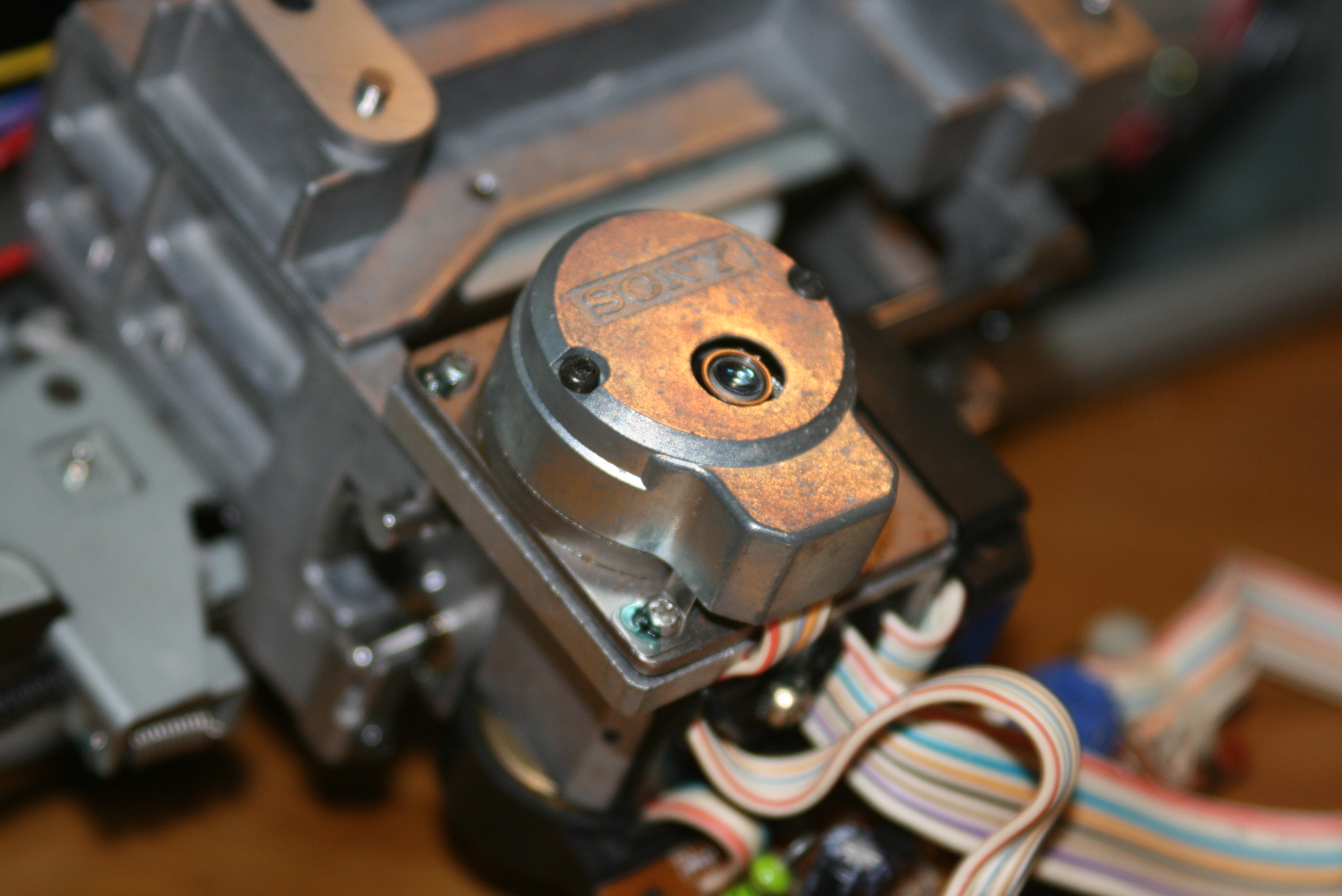

I have Sony CDP-501es and I belive it needs laser replacement. Disc spins for few seconds, then stops and tray comes out. The laser assembly is KSS-100a.
1. What is the way (procedure) to establish that laser is at fault?
2. This laser assembly is impossible to get; can another laser diode be substituted, and which one?
3. Is laser light of that particular one visible light or infra-red?
Thanks a lot...

According to Sony notes on laser diode emission check, I did following:
1. Ground servo amp board TP12 (IC102, pin 30 (LD ON)).
2. Observe the objective lens and confirm laser diode is emitting light.
No light was observed..
Focus search operation check:
1. Block the disc detection photo transistor.
2. Press PLAY button.
3. Observe for objective lens movement up and down 3 times.
No movement was detected.
RF Offset Adjustment (BTW, what is RF, sorry...)
1. Turn power ON.
2. Connect oscilloscope or VTM to audio board TP3 and TP4(ground).
3. Adjust RV7 so that oscilloscope or VOM reading is -0.4, +- 0.1V.
I did not do any adjustment, but I measured -0.338V.
Does all this mean faulty laser diode, or I can stil hope that there is fault somewhere in circuitry?

After a little bit more investigation, I found that there are three wires going from APC board (don't know what APC mean) into Laser head. One read 1.7V, next 0V and third -4.5V. As CD lasers are usually powered from 1.7 - 2.5V, that would mean infra-red laser, as they have negative voltage for common. So, seams all voltages are present, what leaves me with dead Laser diode...cool!
I guess I am now going to open had assembly and see if Laser can be replaced; any suggestion - where could I find, buy, these diodes, what type... Thanks.

Some POSITIVE results; I disassembled head assembly, was able to see photo diode array, but didn't take laser diode out. Coils look fine, no trace of burning. Put everything back together, guess what - it WORKS!! Not the hole CD player yet, but lens is moving in and out, and laser diode lit up for a second and then slowly decays. CD disc was before spinning like crazy for 2-3 seconds, now it does not spin at all, just tray comes out as disc was not detected. Now I have motivation to keep trying... Perhaps I should re-install STK9622, focus may be working but tracking drive may be faulty...
