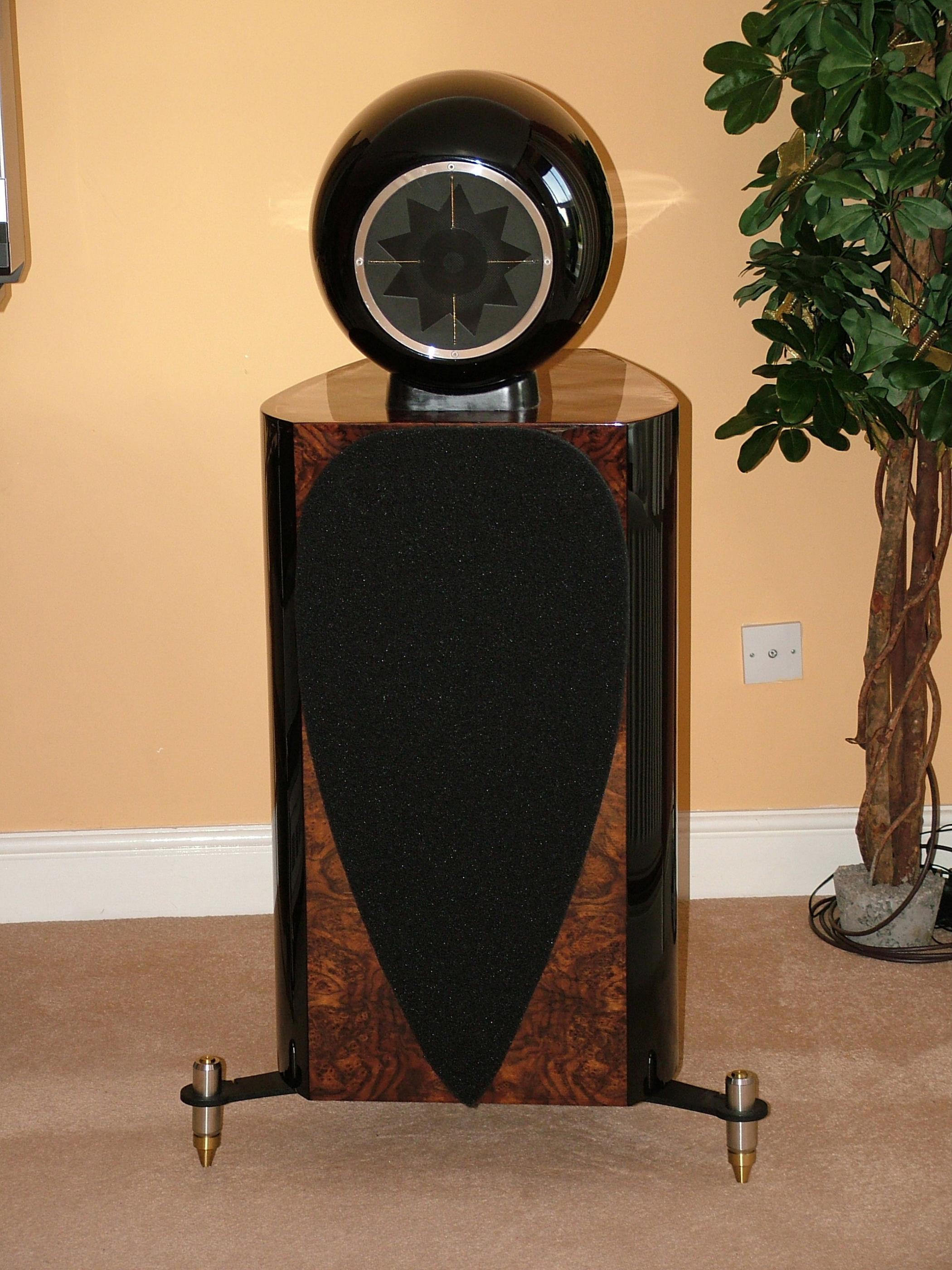

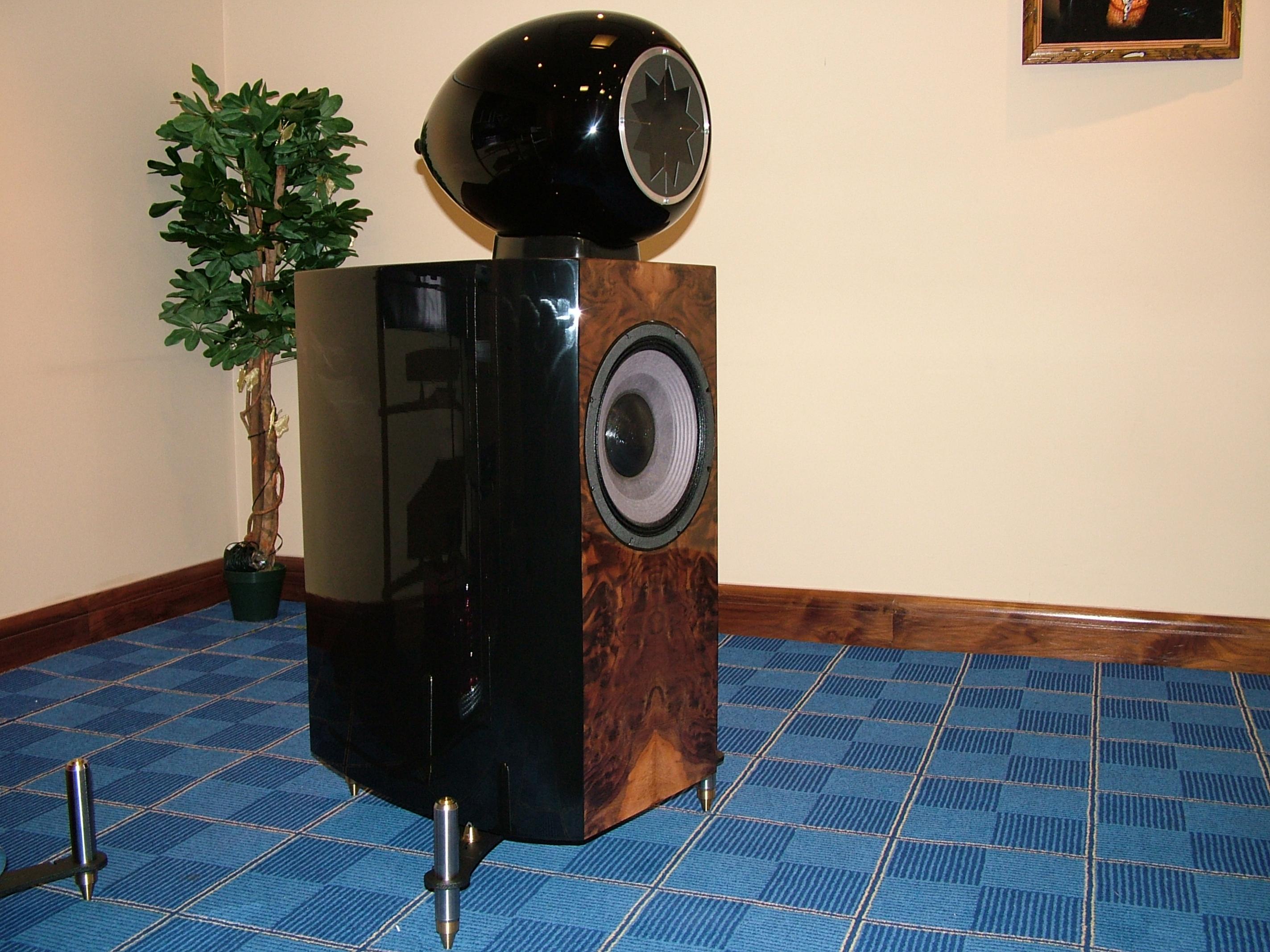

In no particular order, and specifically looking at your room dimensions:
(1) Whilst I would love to hear 24 Silk BMR's in an array in your room, it really would be overkill, and it takes a lot for me to say that!
Also the min height would be 2,750 assuming a two piece modular construction (12 BMR per cabinet) with floor spikes and low profile brass connection disks (Star sound Technologies - Sistrum gear is fab) so that would be too tall?
(2) I have in mind a lower cost but killer performance line array design for your room.....Four 12 inch drivers with 9 BMR's per side. Each 12 inch (sealed of course) sub sits in 23 liters of air (including driver and damping volume) and is 350mm tall. So twin subs, then 9 BMRs and then twin subs.
(3) Modular construction allows easy construction & handling with flexibility ie build and grow system as funds become available.Total height just under 2,600mm....Perfect!
(4) 200Hz crossover from BMR's to bass / mid-drivers. Important point here. The BMR's are only driven above the box / driver resonance, plus the bass / mids are only driven below the box / driver resonance. I can not stress enough how vital this is. All drivers in sealed box with precise 0.707 Q.

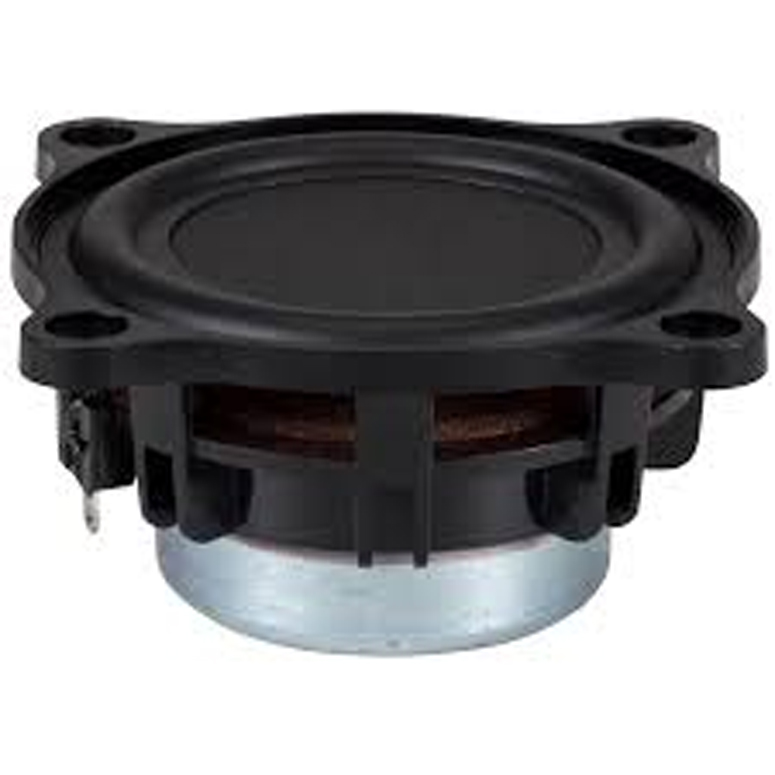

I'd say you would want a specimen of the BMR too for this test round of drivers.
No matter what you end up choosing, you'd have to like it to want to build an array of it. You basically get the same speaker on steroids if you array it.

Hope to see more data from you soon! I'd wish you had a drop in 3.5" BMR for me to try (lol).

After reading all that jazz about BMR's I have to try one now!

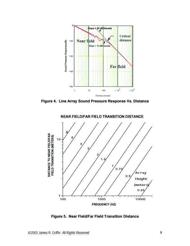

Actually, not overkill at all if I am building Near Field Line Arrays as per Jams R. Griffin's white paper. I should have communicated that better, my fault. I have considered adding "line" to the title of this thread: All Aspiring Full-Range Line Array project. (it just does not flow as nice and is too much to say in one breath 😛)
Your 9 speaker BMR has a length of 1200 mm, which at a listening distance of 2 meters (if the speakers are placed in the side wall locations as per my drawing), would drop out of the near field (-3dB per doubling of distance) at about 800 Hz, and below that act like a point source down to 200 Hz. I can only speculate that the four bass units would be the same, as they are a "broken" line, but there is room gain and the such messing with the math. What You have designed is a stellar floor to ceiling D'appolito, or WTW arrangement. Actually, this design is perfect for the Sound Production market You are targeting, where the system is EQed for the listening couch (as it will still have a broad listening spot at that distance). As I listen to my system on the couch, in front of the couch, on the floor in front of the TV (especially when my daughter and I game together), standing up, dancing around the room and even laying down on the floor resting after a 15 hour shift, a true near field line array is what I am aspiring to build.
Also, I have come to realize that the line source behavior is what gives the sound stage the "You are here" feeling verses a "You are there" feeling. As I am 100% blind in my right eye, and have been since birth, I have a very acute perception of 3D in terms of hearing. It is something I listen for in systems and it is something I help my musician friends create in their final mixes, eventhough they really do not understand it. When I listen to a point source speaker, it sounds like the sound is coming out of an open window (or the TV in my living room). It can have all the sound stage depth in the world, but it sounds like listening through an open window. The sound is "over there". When I started building my NSB arrays, I started with four drivers on each side, the window got bigger, but still a window. Once I used up all the drivers (15/cabinet), we started to get something more realistic, as if the front wall was removed from my living room, the sound is now "over here" in my room with me. In am now almost outside where the action is.
"Almost" because With my 15 driver/channel array at about 1500 meters is in the near field down to 500 Hz, so it still falls short in that realm, but it is a lot closer to my goal then my Avebury system. Thankfully, I do not have to build a 4 meter tall array to get the 80 Hz I am after. According to James Griffin, I just need 85% of 2690 mm (2287 mm) to "mirror" the array length. I am going for the full ceiling height, however, because Wesayso mentioned on his thread that he may have been getting some ceiling interference due to his array not being ceiling height. As this is an All Aspiring project, we are going all out.
Sorry for the lengthy explanation, but I really felt You deserved to know my deep passion regarding this as You where so kind to take the time out of your busy schedule to design the awesome monitoring system You did. But this is not a rejection so much as it is encouragement to go with the true floor to ceiling array, which seems like unexplored territory for You also. 😀
I remember reading something on the BMR thread about experiencing a "light" mid-bass in the BMR's. Could this be because the arrays where too short? The mid-highs being in the near field and the mid-bass being in the far field? The mid-bass can be EQed up, but that puts extra strain on the drivers, why not "array" up? 😉
Golly, I am already being a "tough" customer! 🙄
Below is the chart I referenced from James Griffin's White Paper regarding near field listening distances.
Here is the link:
http://www.diy-audio.narod.ru/litr/nflawp.pdf

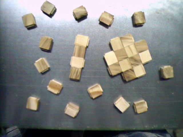

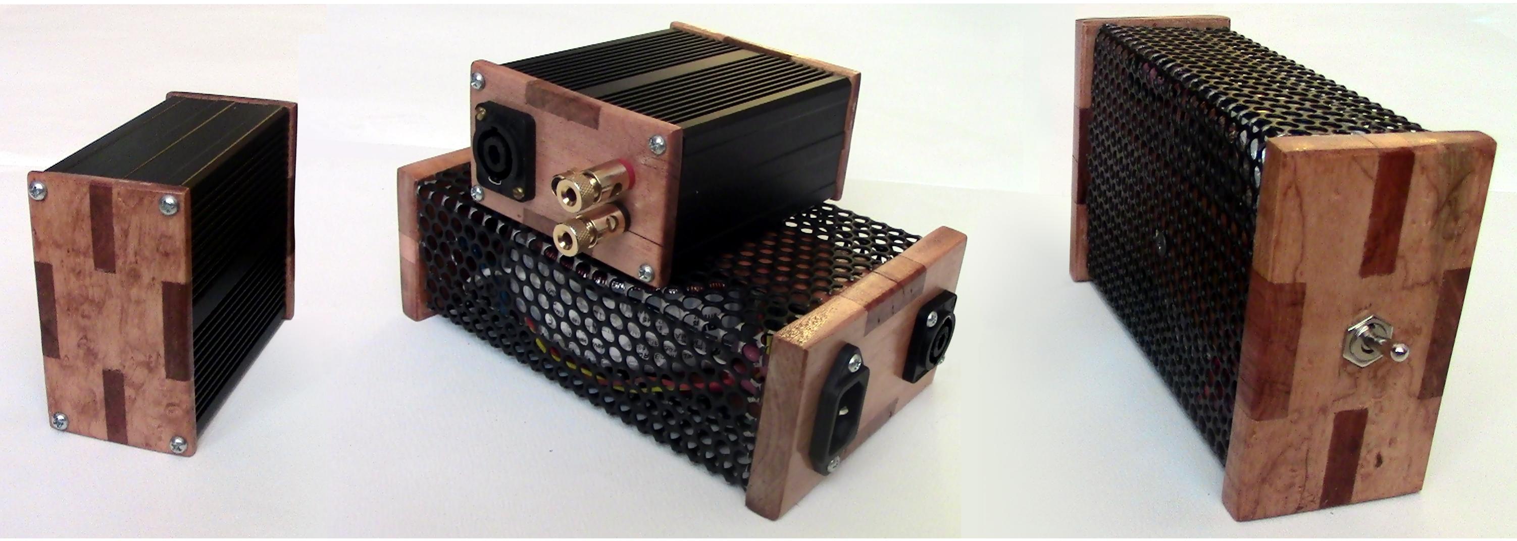

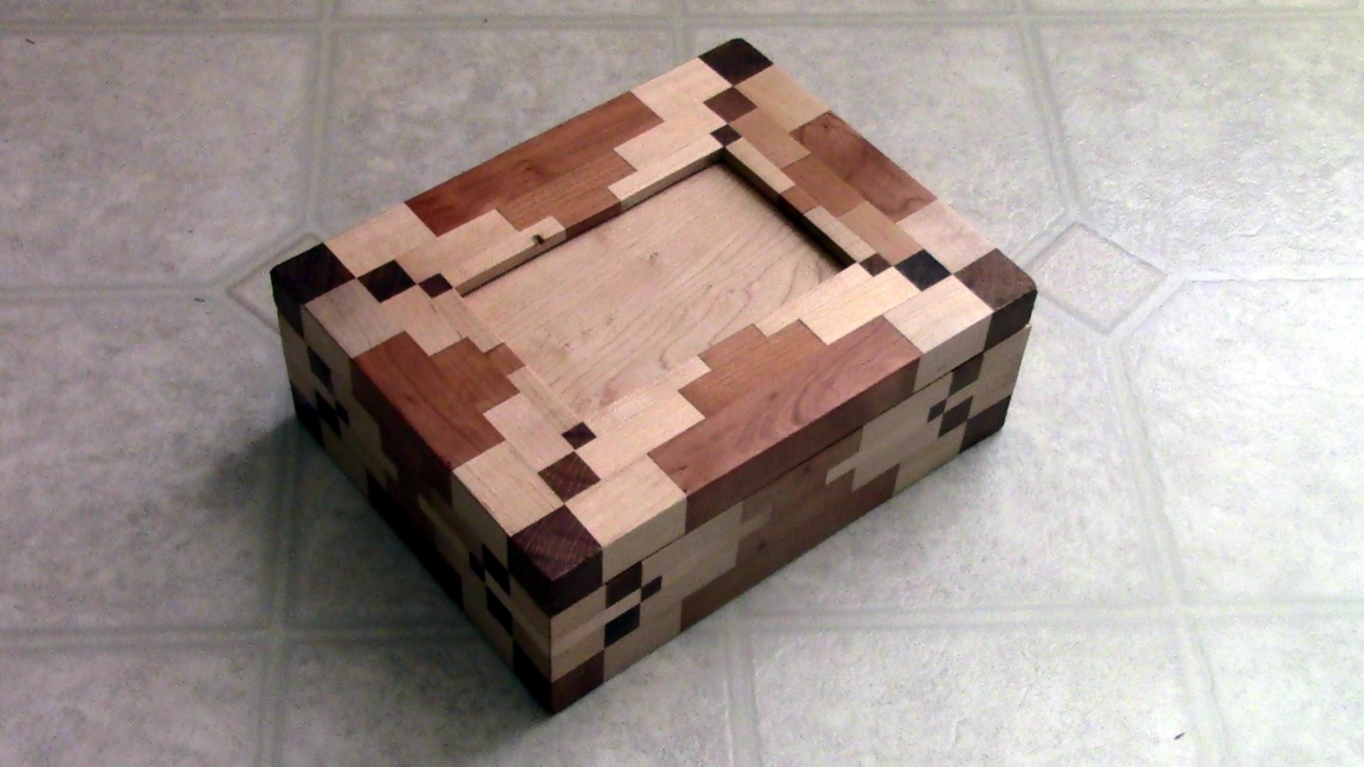

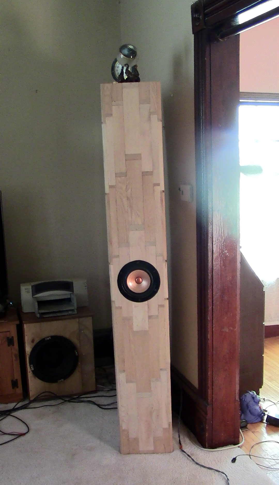

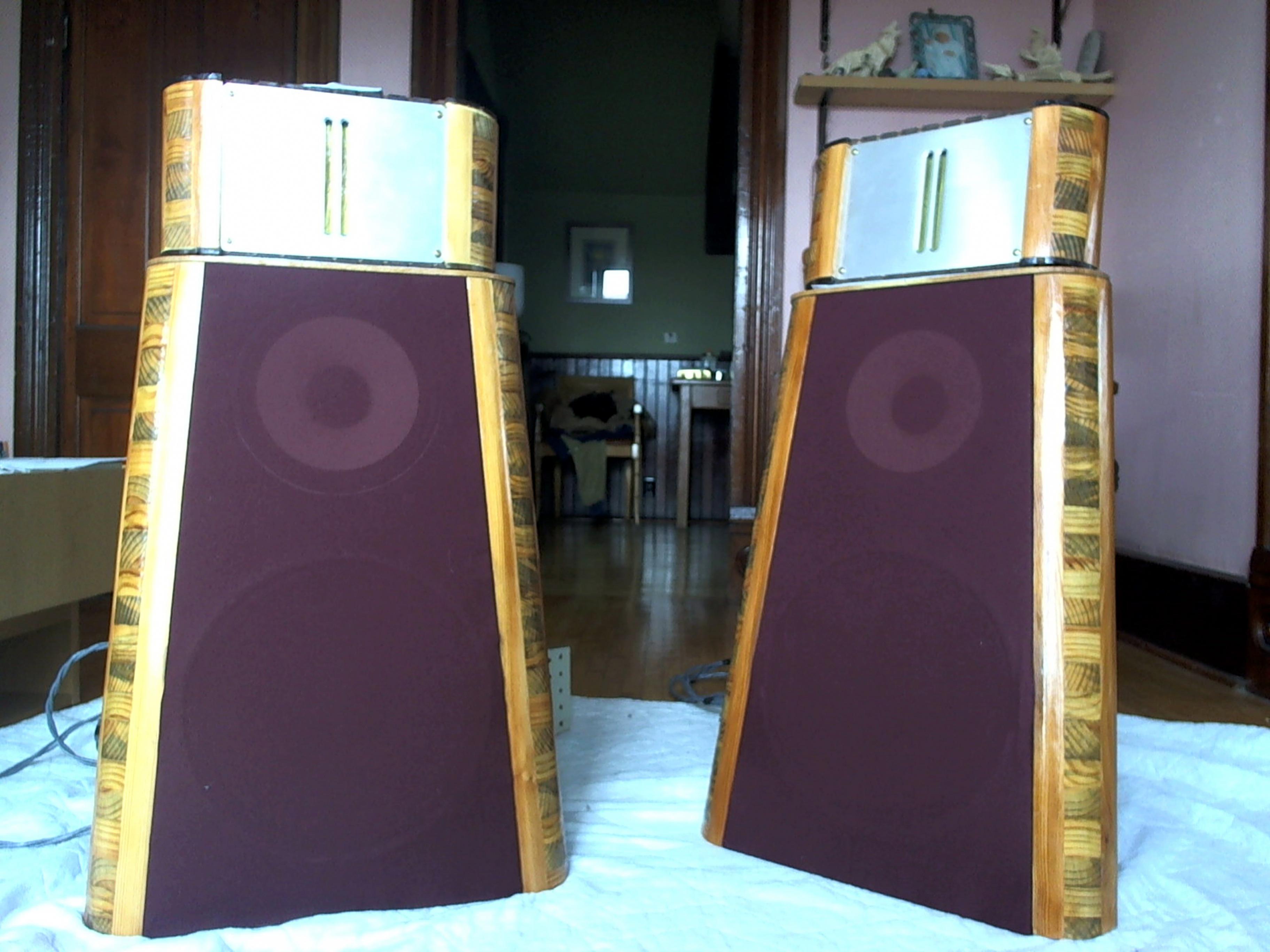

Below, I have included some photos of my multi-wood hard woods "mosaics" so you know what I am talking about. I will build the cabinets out of Baltic Birch then I glue the hardwoods on top of the completed cabinets. I have this thing with hard wood patterns.

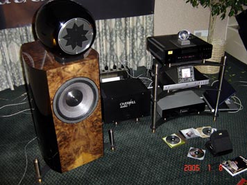

Comment's on Overkill's two-ways pictured above...
Nice Build, Derek. I have seem that system on another thread somewhere (maybe Wesayso's). If I recall, the woofer section is laminated Baltic Birch - same constructions as Wesayso's. Is the top laminated BB also? What does the "star" do to the top driver (Is that a mangar bwt?)
I see the same speaker in three different rooms with similar house plants in the background. Either You moved around a lot, or You remodeled a lot, or they are three separate systems in three separate homes, and the house planets are a required prop to improve the sound some way. 🙂
I'm sure I am quite close or at that figure. It makes sense. One of the reasons for me to build in wood/aluminium instead of a lightweight epoxy/fiber variant for the enclosure (would have been an easy choice to get my desired shape).
I didn't go with spikes though. I tried something resembling spikes and am happier with the industrial damping feet I use now.(*)
(*)= I have a wood floor that actually moves a bit, it is not as solid as a concrete floor. With the damping feet I haven't noticed any ill side effects.

Okay, back to Sd. In a SPL sense, You felt the 24 BMR's was overkill, so you recommended 9 BMR's
9 of your BMR's with Sd of 70.88 per driver is 637.92.
32 of the 3" Tectonics is 627. I could actually fit 36, because they are a little under 3", so the total potential Sd is 705.6 - which is more then the Sd of the system You designed for my room. Would this driver be worth considering?
I am not really considering the bigger Tectonic, I really question the quality.
The only real issue with the smaller Tectonic is the bezel rim. I thought about cutting it off, until I read the 1:1000 deal, and realized the driver can not be compromised that way, dealing with the amount of movement the array will have.
I know your BMR's are the cat's Meow. Is the Tectonic worth exploring or is it a cheap BMR want ta be?
I have in mind a...killer performance line array design for your room.....Four 12 inch drivers with 9 BMR's per side.
32 of the small (75mm / 19.6 Sd) BMR's = 2,400mm tall which = 627 Sd or just over a single 12 inch driver.
24 of the medium ( 108mm / 37.2 Sd) BMR = 2592mm tall which = 892 Sd or a single 15 inch driver.
I use 16 of my 112mm square chassis BMR with Sd of 70.88 per driver = 1,134 Sd.....
Sometimes I do not understand this kind of engineering...
What can we do with this rim guys?
Add something inside to smooth transition?
Or back mount to thin baffle. Afraid that will cause the praised BMR dispersion pattern to "beam" or what Derek calls "Constant Directivity" or "Lowest Common Denominator"
Or is it a lost cause?
Any ideas?
Allen
Any ideas?
Allen
