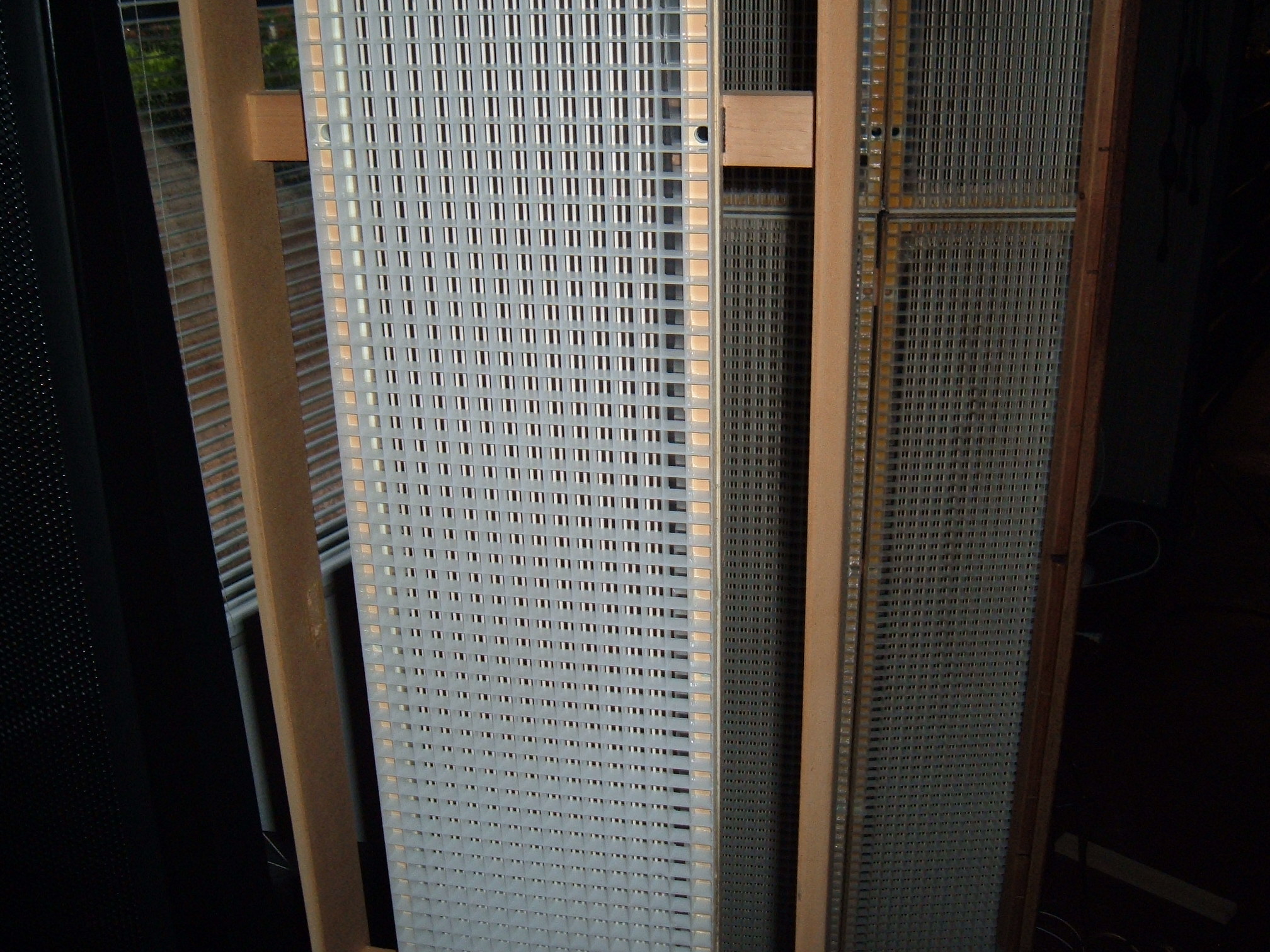

These are the older 2+2s with the first silver looking wire used.... in the panels in my pr of Xs.....back in 89....all the panels I have had in the last 20 years ...all was with the copper wire. in the panels.....
pulling the pads off the copper wired panels ....I found was a must for better topend..
But I have found with the silver wired panels ....that dose sound diff....to me...with all the screw pull out ...but for 2 per panel.......removing the felt pads may not be needed....
Also I have found the silver type wire holds the bias...better...longer than the copper wire
The silver wired panels PVc seems to be better at keeping panels from leeking much better...

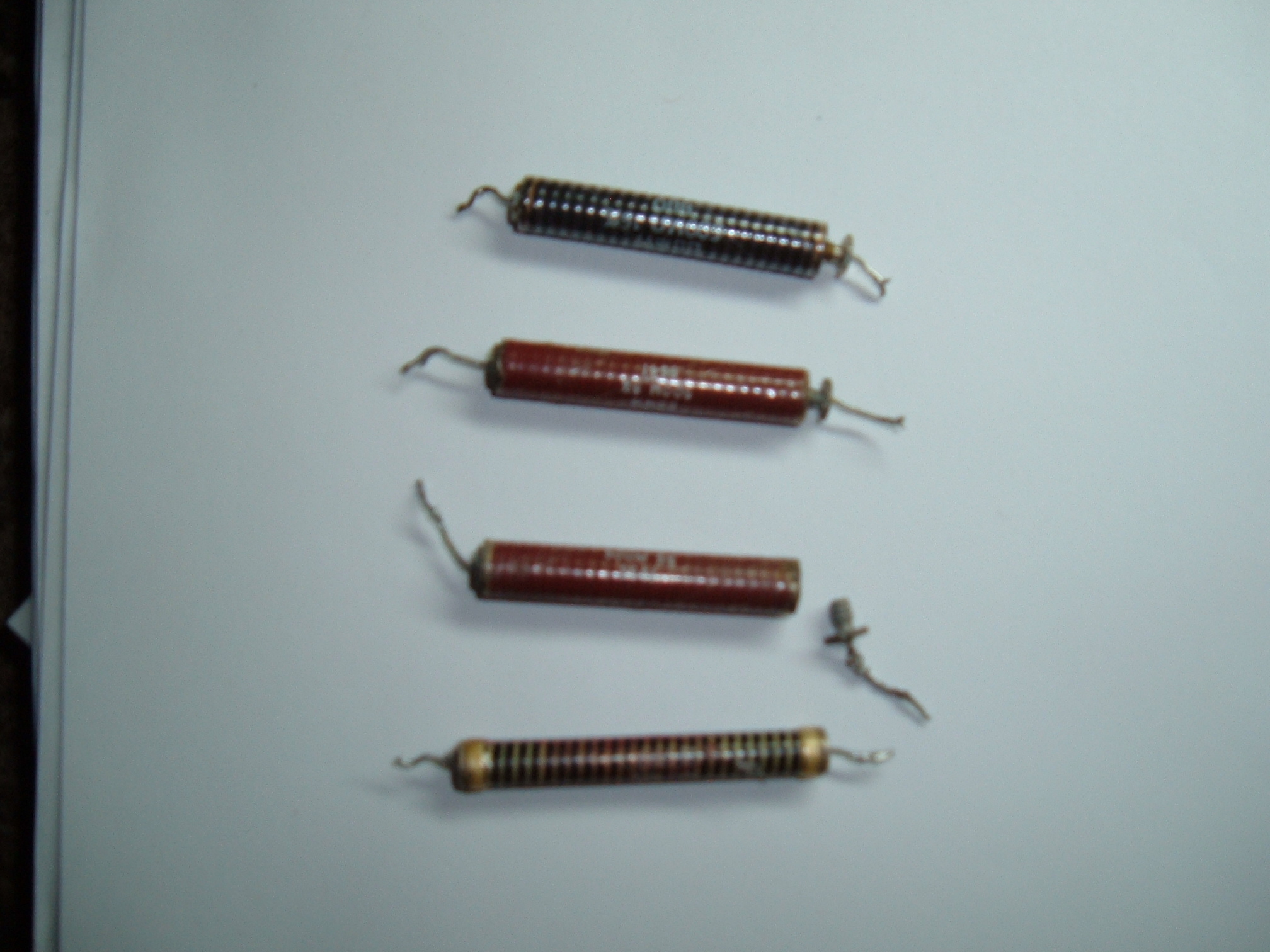

JUst one more thing that can give low output......to the panels....the stock 500meg bias res ends can get lose.....one day work....next day not....high humidity can add to this
this has drove me nuts for yeas...I don't need any help added .....as some say ....I am NUTS a nef.......not Voodoo magics.....

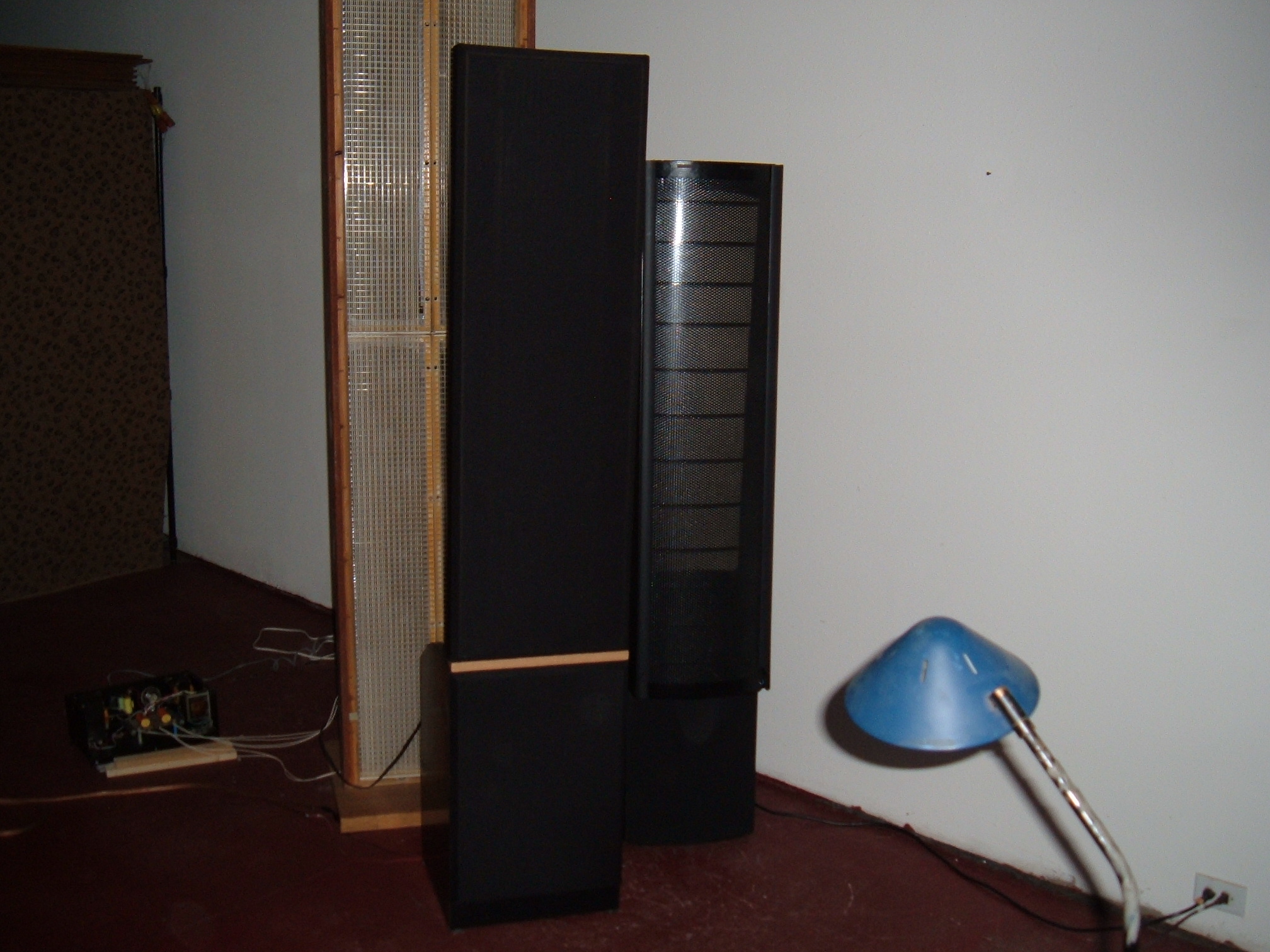

Some people frown on mixing electrostatic panels and cone bass drivers, insisting that full range stats have "coherence" that is somehow lost when you go "hybrid".
I have begun to feel that getting the sub 50 hertz bass off the panels and into a nice pair of subwoofers is the way to take my Spectra 22 to the next level. They would have to be the right subs (possibly homemade open baffle or dipole), and the crossover would have to be done just right, possibly just a cap to roll off the low frequencies to the main amp. Hope to achieve more punch, lower bass extension, and cleaner midrange and high frequencies from the panels which would be relieved of the excursions require to reproduce low bass notes.
The Spectra 11 basically did just that. It seems to be a much loved speaker. The new Marten Logan's and the Sanders models also successful combine electrostatic panels and woofers.
One day I am going to get off my butt and do it (maybe)!
Enjoy your new toys tyu!

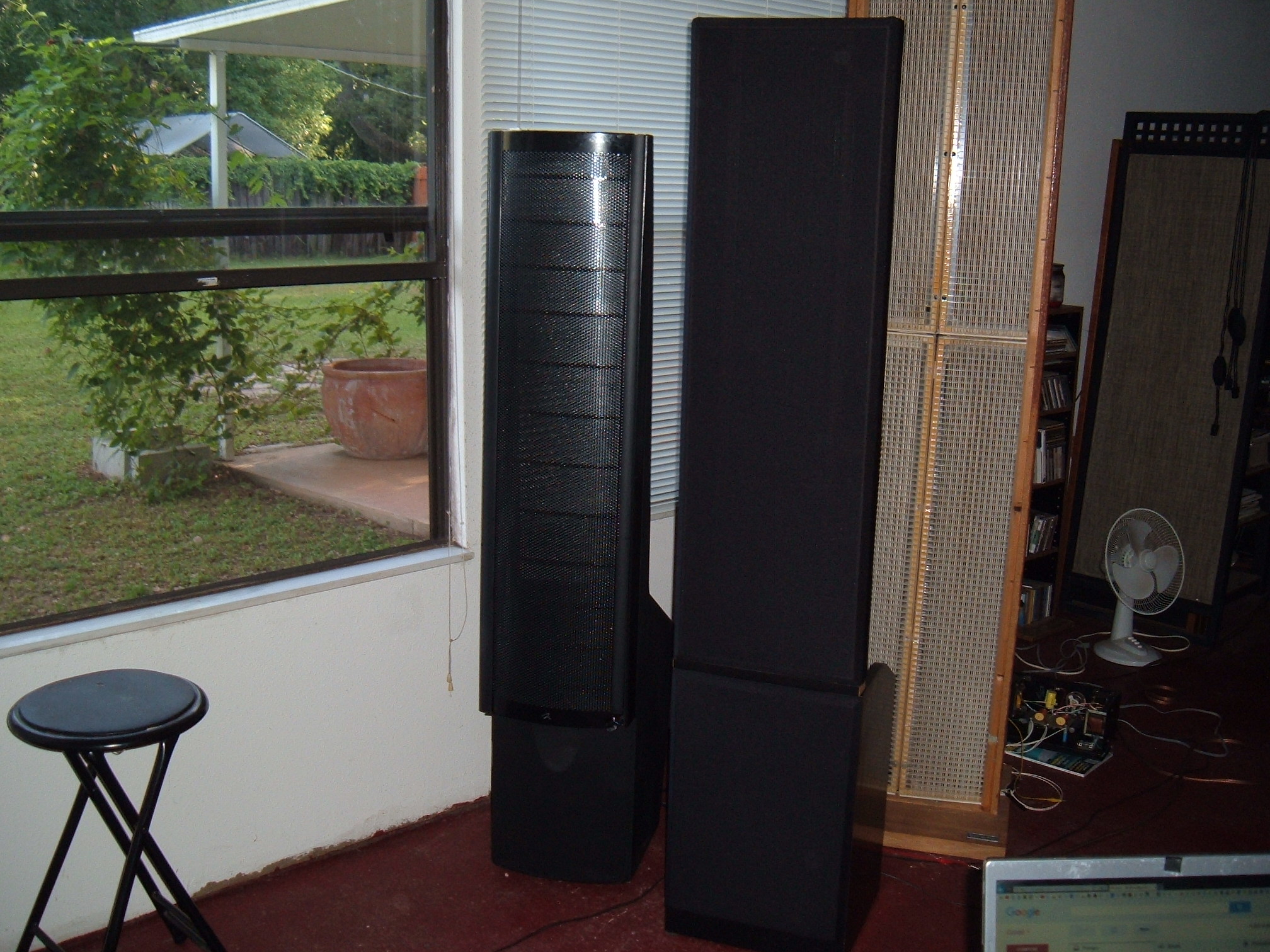

I have ben working with a guy that has a room.....12'x14'x7'....he has the spectra 33.an.22....Apogee minors an ML ....the ML allway sound good....the 33 bass is heavy....22 just don't have the output in the room....minors work well....he has two 10" bass boxes ....his sound get better with the added bass......but in this size room I think 2 small 61/2" bass box with ports..would work best
I don't like to have anything but full rang sound come from the front speakers...
you well be shocket.....how much clear you sound well become ......when you add little output from these type bass box....
so called subs in a small space is not what anyone needs ....less you just need your neighbor...have your low bass.....low bass....heheh..... have fun...
As for the 11....or the 1+1...I still say in the end the best sound ... that come from Acoustat .....well be these one panels wide speakers....thay have all the magic...all
just one mans finding

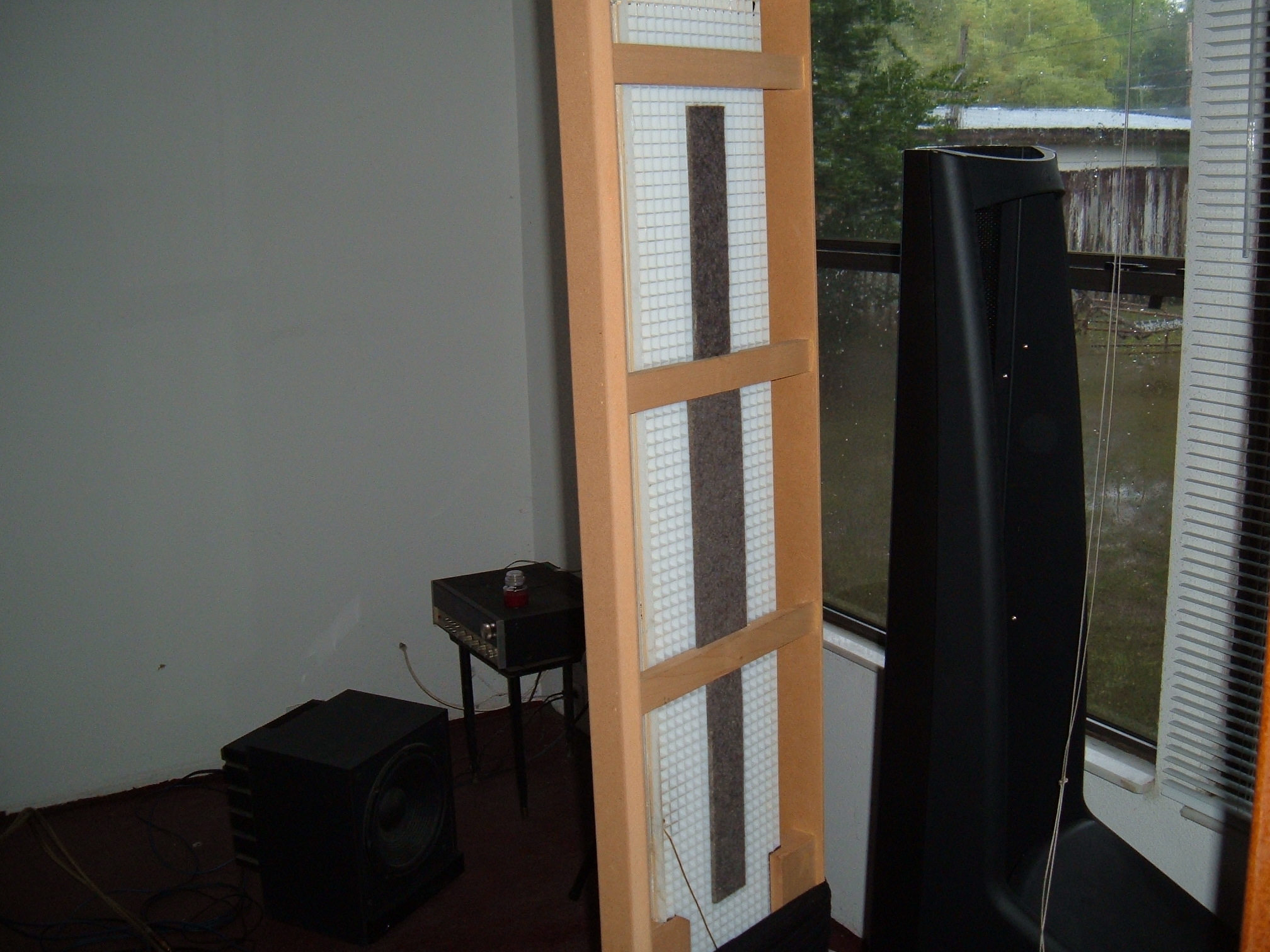

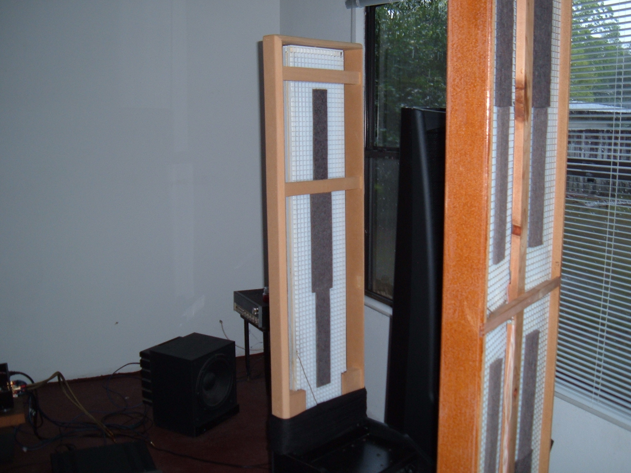

Well it been some time now...that I have had the spectra 11-1100....same back plat......the 11 are the only Acoustat panels setup I have owned that have cross horizontal bars... as a way to mount the panels....I have found that way of mounting the panels....any panels bust the high frc....why thay slow the planels mylar movement at the crossbar point......how do I hear this well I pulled one bar ...the first one up....see pic....I can add it in an out...an as stated before pulled the screws out of the panels...all but the 2 at the bottem....this give a more natural sound stage....aka sounds more like the full rang Acoustat....
Now this has give us a way to get better high frc out of the full rang Acoustat
on my 2+2s...I have found by adding a small horizontal peace of wood 2"x 9" wide ....to the back of the one inside panel in the 2+2 just below ear level.....give a nice peak of the top end....it would work on more than one panels in your ESLs....but I have found it sounds better when only one panels has this peak...I just use tape to hold the bar....so it can be ezey to pull in & out...if you were to add it an like it....hot glue would work fine...
Also the medal plat has a wire the runs to the ground in the bias... in the 11-1100--pull this it sound vary bad....takes that steely sound out of the top end
all just one mans finding.....have fun with Acoustat

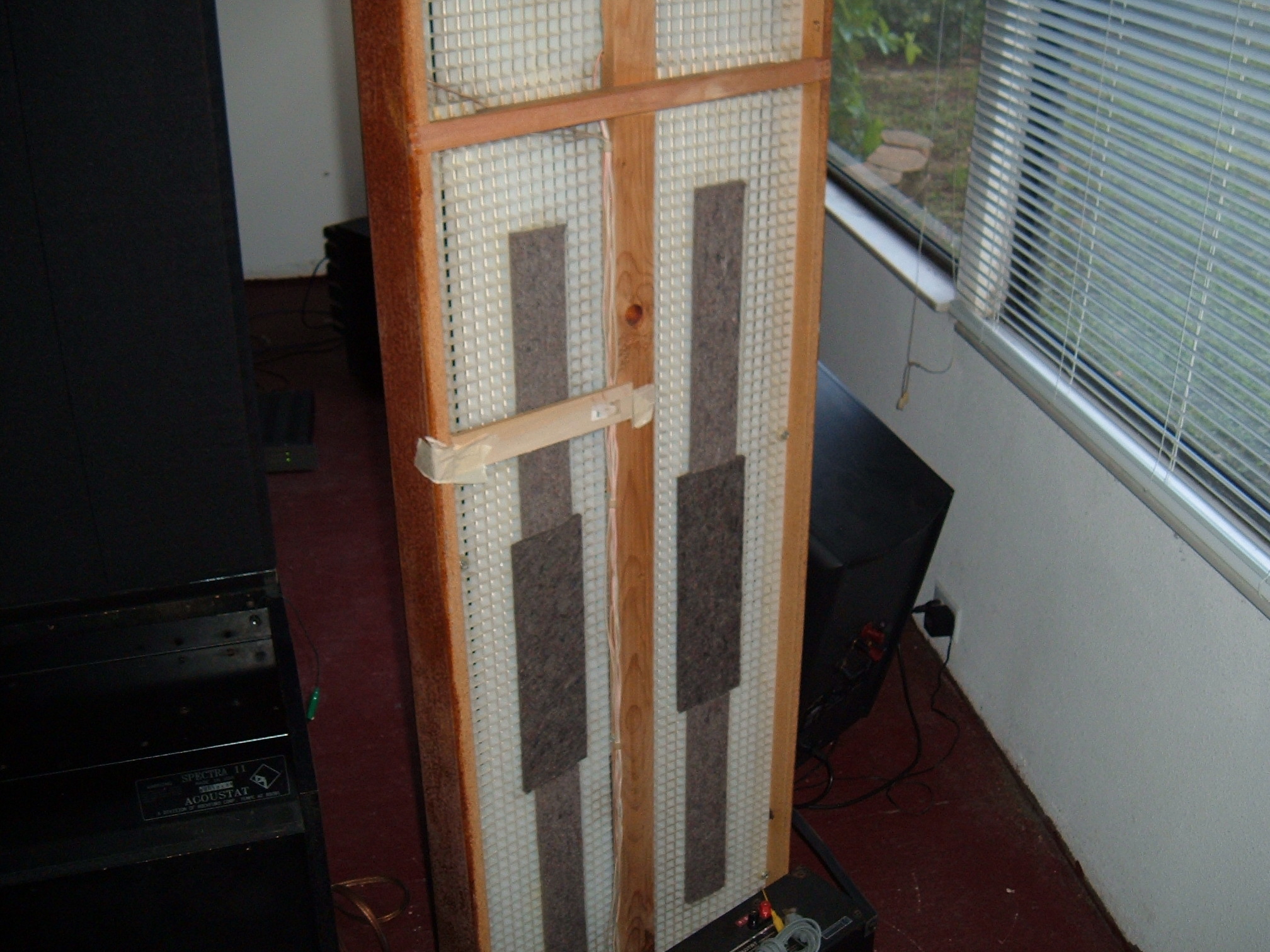

geting better high frequency-response out of Acoustat panels
More info on getting better top end out of any Acoustat panel....as I have posted..... adding the 1"1/2 peace of wood....to the back of one panel just below or at ear level well give a vary good sounding bust to the frequency-response of the panels.... .passively....with out going active with..... add on ..ESL or ribbon type tweeter....
What seems to be happening here is the slowing of the mylar only at a small point...so the movement from lower an mid notes don't smear the high frc....gives much better image, depth of the sound stage... I have found.
Add you input..an findings..after all its about getting better sound out of these great panels.....
