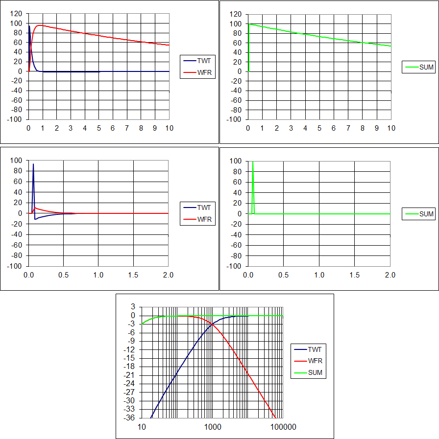

Hmmmmm...interesting....noticed a time difference when looking at a pulse input between the HF and LF xfmrs.
I'll have to take a look to see if it is anything other than the usual HP vs LP crossover filter time delay. Even with an ideal 1st order filter, the peak of the LP step and impulse response is delayed relative to the peak of the HP. But, this is what is required for the HP & LP to sum to a perfect impulse.
Do you recall if you measure with both HF & LF transformers driven together? or independently.
Also, were you measuring at the output of the mixer? or the HF and LF inputs to the mixer.

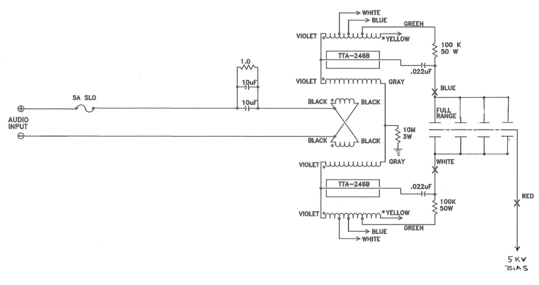

Does the Spectra models have fuses for both the high and low frequency transformers? Seem to remember seeing a few fuses inside the interface. Does anyone know the value of those fuses? Other than bypassing, has anyone tried any of the premium "audiophile" fuses in those spots, or a contact enhancer like Walker SST? These might give you much of the improvement of bypassing the fuse all together.

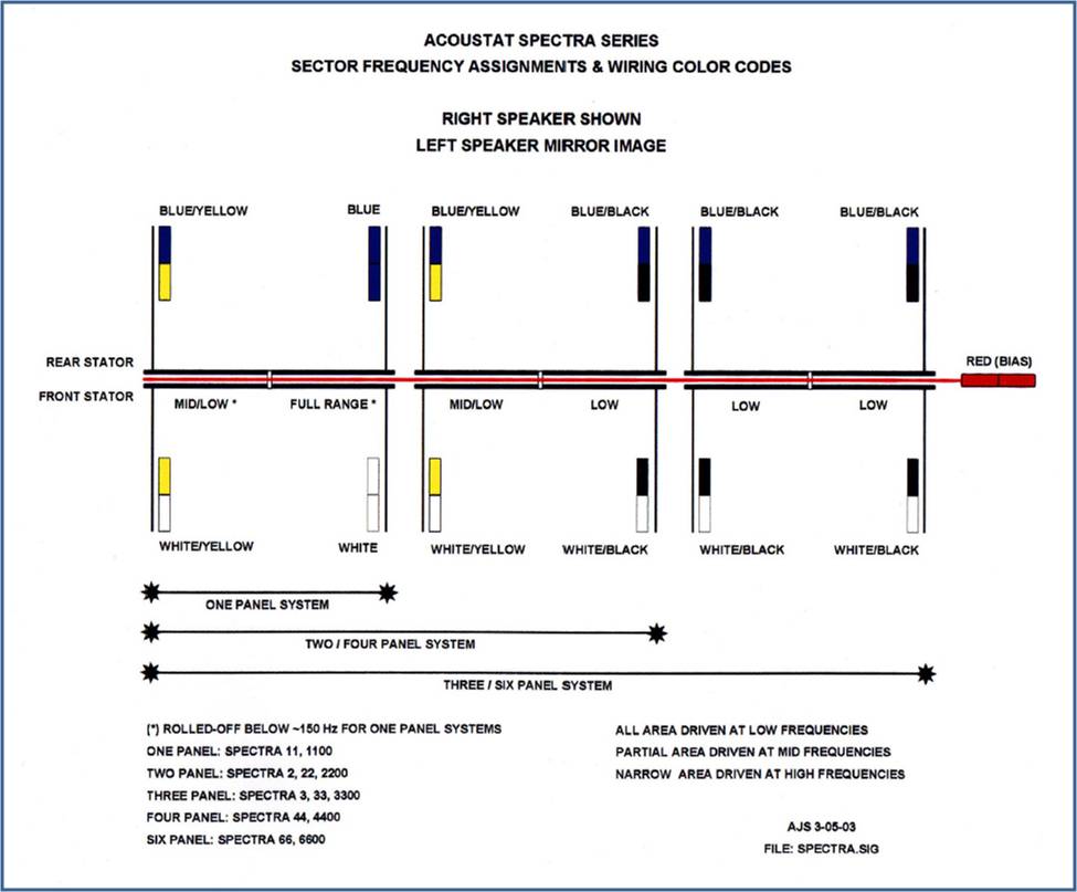

Hi.....how it going....I put up this Spectra 44 sepup tran .....your 22...33 all look like this...you tran are wired to be one tran.....see the older 121...two diff.trans........see yours....like 44 there only one fuse......you can hear a diff with the fuse out
............... ......But...........you kill one... two tran...good luck...I don't fool around with this old ....hard to fix-find...get....but hay...I kill more than one tran....do what you well..............you know...you wont no less you go...right....it was not that big a gain....no fuse....for me......have fun
Thanks for the info. Only one fuse inside the interface? Do you know the value by any chance? I know the one accessible on the back of the interface is 5amps. I do not intend to bypass the fuse, only upgrade, given that the fuse does appear to affect the quality of the high frequencies.

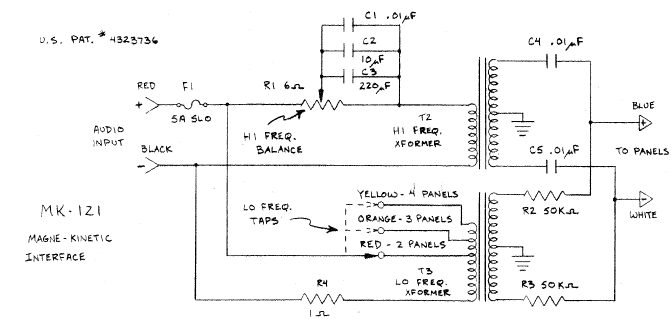

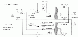

Look.....there the 5amp this is were put diff fuses.....that's it...........as for the 2 fuse in the bias.....there like1/8 watt...I have put biger fuses in there rolled the top end down......not for me......BUT
.less see...if you have a early Spectra...that have the same bias tran an fuses. the 121...as....you see in this first pic..........see the small tran an fuses...
if you have the 12-15v wall wort that pluges into the wall then pluges into the interfaces.....you have no fuse inside....pic 2 looks like that bias setup...from 11-1100s.....

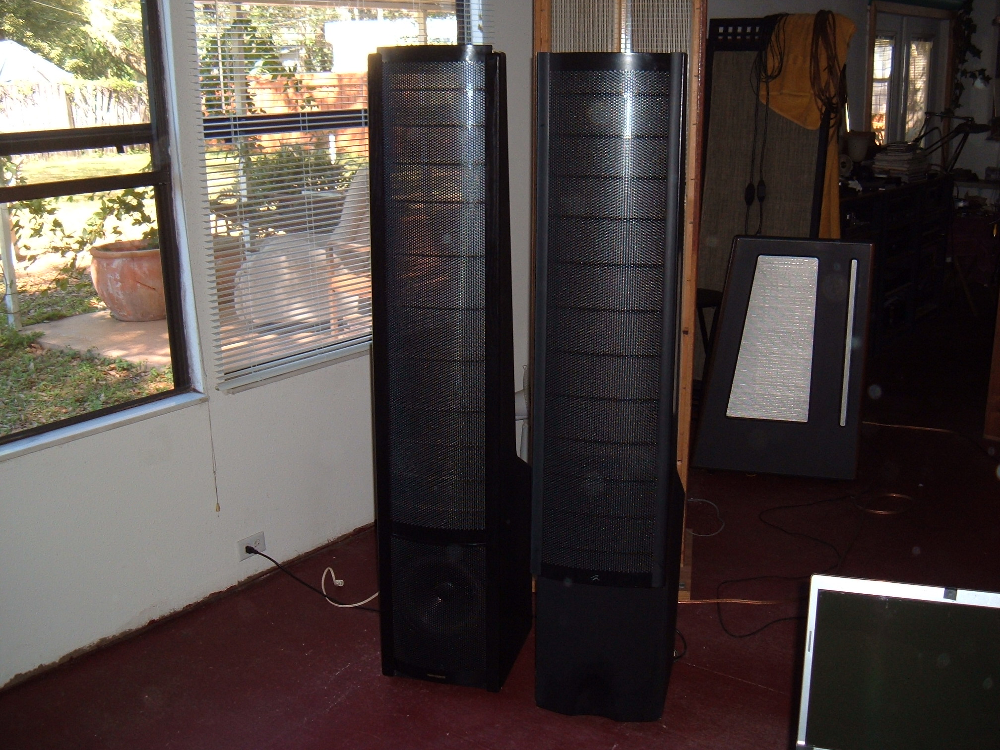

I just pic up a pr of ML Ascent....I have had 4 pr now....I paid $40 for the pr...bad panel............I got open up ...... the bias wire had pulled out of the panels......there playing now..... sound great.....these were some of the last of this type.....that have there new vary vary then mylar.....WOW....best topend I ever had.....out of any esl.....

As for the setup of my Spectra 3s.............the 3s were setup like in pic 1....but I found thay sounded much better....running the 3 panels ....1 hole panel for lows...1 panel for mids...1 panel for highs.....
But now I run all the panels....on the full rang output only.....this sounds best to me...... a none Spectra setup.....but uses the Spectra MK2123 to drive full range has a sound of it own.......still minny ways.... to get great sound out of Acoustat panels
