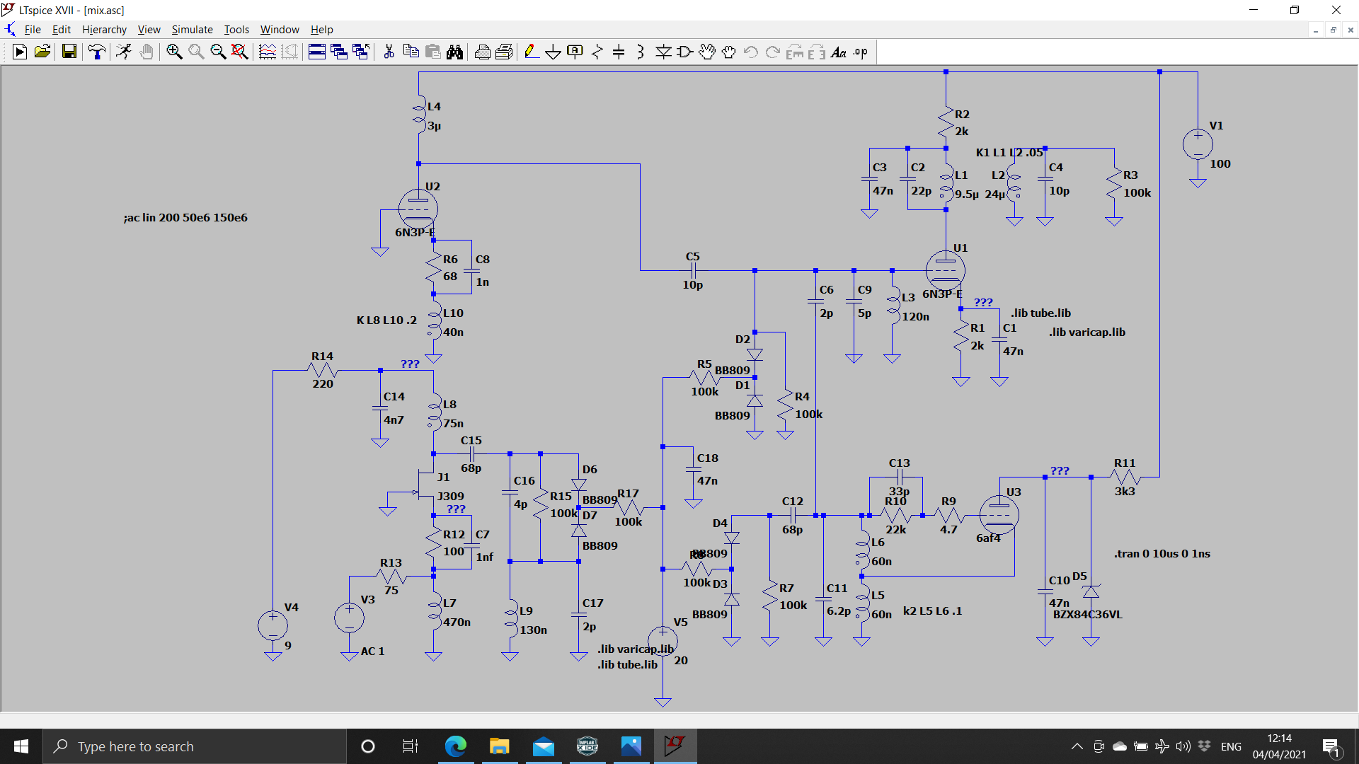

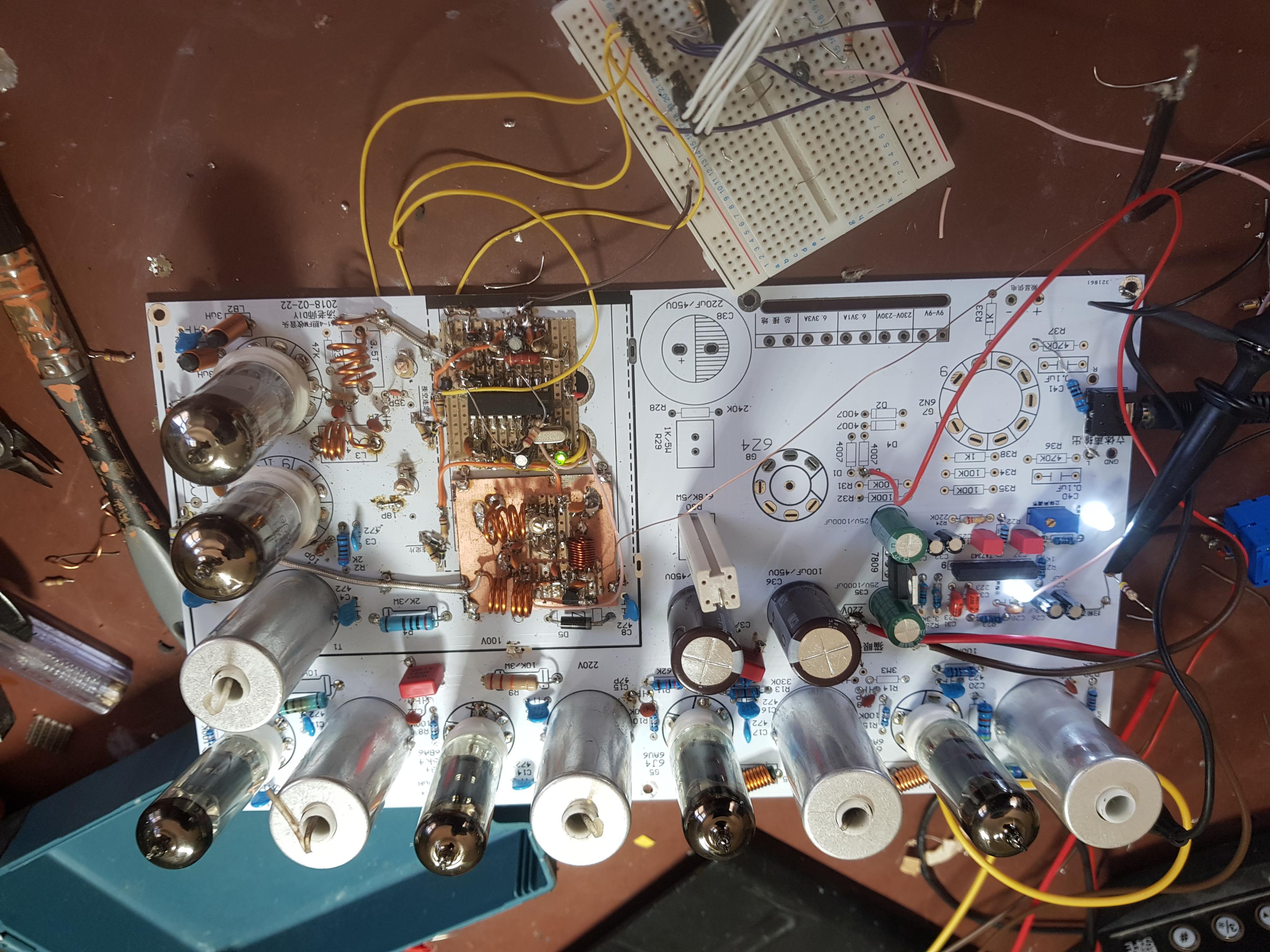

This is the front end. I went with a JFET as its simple. The LC tank contains both a peak at the wanted and a tracking notch on the image. After a lot of playing in the IF its now working in stereo. Here's some pictures.

Its definitely worth ago. You can synthesize a valve osc as long as the amplitude is controlled. The IF stripe had to have a few 22k across the primary coils to stop it oscillating. The RF comes out very close to LTspice simulation. Something to stimulate the brain rather than another amp. I've got about 1uV input sensitivity and about 65dB image rejection. And it sounds OK.

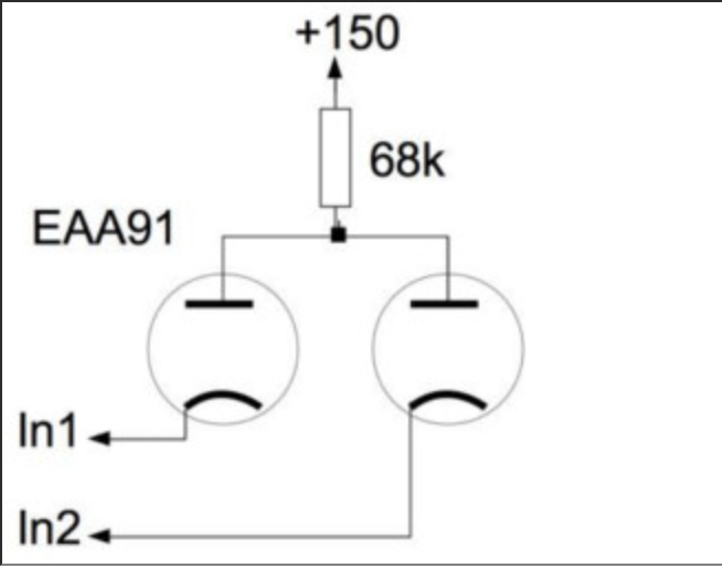

In the realm of "100%" tubed circuitry, I'm thinking coincidence FM detection by a dual vacuum diode AND gate that's fed with a strongly limited signal of the sort produced by the circuitry found in the Harman-Kardon Citation III. Stu Hegeman employed 2 gated beam tubes. CRUSH AM noise!

The original china circuit had not enough RF gain/poor image rejection and too much/oscillating IF gain. I don't think you need 5 stages of double coupled tuned circuits. Having three gangs of the cap is the right way forward. I was trying to work around the PCB I bought without hacking it to bits. The coils are nicely made. The FM limiting works well, and I noticed their original ratio detector was a dual diode valve. When you look at the MPX output you realize just have much processing is taking place on the TX it's nearly always 75KHz deviation! I will have a further play to get a bit more RF/mixer gain from the new circuit. The synth is a SAA1057 controlled by a PIC16F677. The idea was to have a display with presets. There's a magic eye in the kit too.
The China ones had about 2:1 turns with 10p on the 2 (grid side) and 22p on 1 (plate side). They were just critically coupled with a ferrite slug top and one bottom to tune. I think this is required to get a good bandwidth for stereo. May not be required for mono. I may add a headphone output to the unit. There is a gain stage but no cathode follower which is a shame.

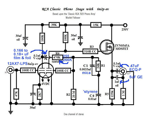

Perhaps a ZVN0545A source follower, like that in the tweaked RCA phono preamp, could solve the buffering problem. FETs and tubes do "play nice" with each other.

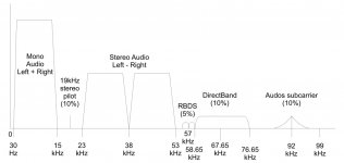

Perhaps some of the German IF "cans" and at most 2 pieces of the BJT stuff would work out well. I also plan on using a carefully selected ceramic filter, whose bandwidth disposes of HD garbage and the like, located between the IF/limiter strip and the FM demodulation circuitry. Anything beyond the DSB L-R info. is of no HIFI use.

Well I went with an op-amp for the headphone amp - easy. They are 32R and would either need quite a bit of power dissipation or a transformer. The MPX drive to the stereo decoder was too large causing distortion. Now sounds pretty good. Need to improve the coupling/matching into the 6N3 to get the best NF.
