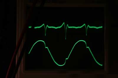

Here´s a pic of the output at ca.25V and the V+ supply, the peaks are almost 400mV

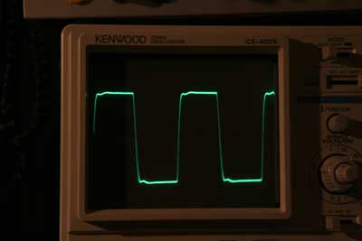

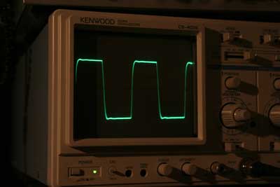

The square waves look fine to me, so I don't think you have an oscillation problem.
The thing I find strange is that the rail dip occurs half way on the downward slope. If you have a differential probe, maybe you can check the output current. The fact that you still get this with the active current source deactivated implies that the latter may not be the cause.
The other measurement I would suggest, just to trace where it might come from, is to measure the voltage across the JFET drain resistors. Again you need to measure with a diff probe, since you need at least one channel at the output to show the phase relationships.
Does it get worse with 16R ?

OK😡 I think I´ve found it.....
looking at the voltage at the drain resistors there´s a strange peak when the distortion sets in.
Looking at the voltage before the source resistors there´s a sinus with almost 0,15V PP just before the distortion sets in. this means that Vgs is changing all the time and when the voltage reaches 0.25V it can´t go any higher, sort of clips and causes this distortion.
Taking ot R46/47 (I tried😀 ) is no option as the absolute dc offset get´s a bit unstable.
Changing them to 33k (from22k) makes things better at least until about 27V are reached (wich is almost at clipping)
If you look at the waveform at the jfet sources they start distorting a few volts before the output starts distorting because of the feedback keeping things together.
This also explains why changing the McMillan resistors to bigger ones made such a big sonic change.
So what to do next?
Put in a servo and very big (>50k)McMillan resistors?
Change all output devices to toshibas with lower input capacitance?
Put in the IRF9610´s again?
I could up the source resistors but I don´t think this is a good sollution.
Any ideas???😕 😕

What I was going to say is that I find it very interesting that you are getting dips in you power supply voltage.
I think it would be safe to say the power supply's ability to output current at that point is being exceeded. But -- is it because of some fault in the power supply, or is it because the circuit is drawing a lot of "extra" power at that point? It would seem it must be one or the other.
You seem to be focusing on the amp circuit -- I am going to spend some time looking at the McMillan resistors to understand what you suspect may be the problem.

So somehow above around 22V output ( 31V peak, 15,5V per side) something happens causing the bias to peak. This happens twice per cycle
If I understand the x-topology correctly, wouldn't the output on the other side be drawing peak current from the V+ rail? So it might only be once per cycle, shortly after the positive going peak?
