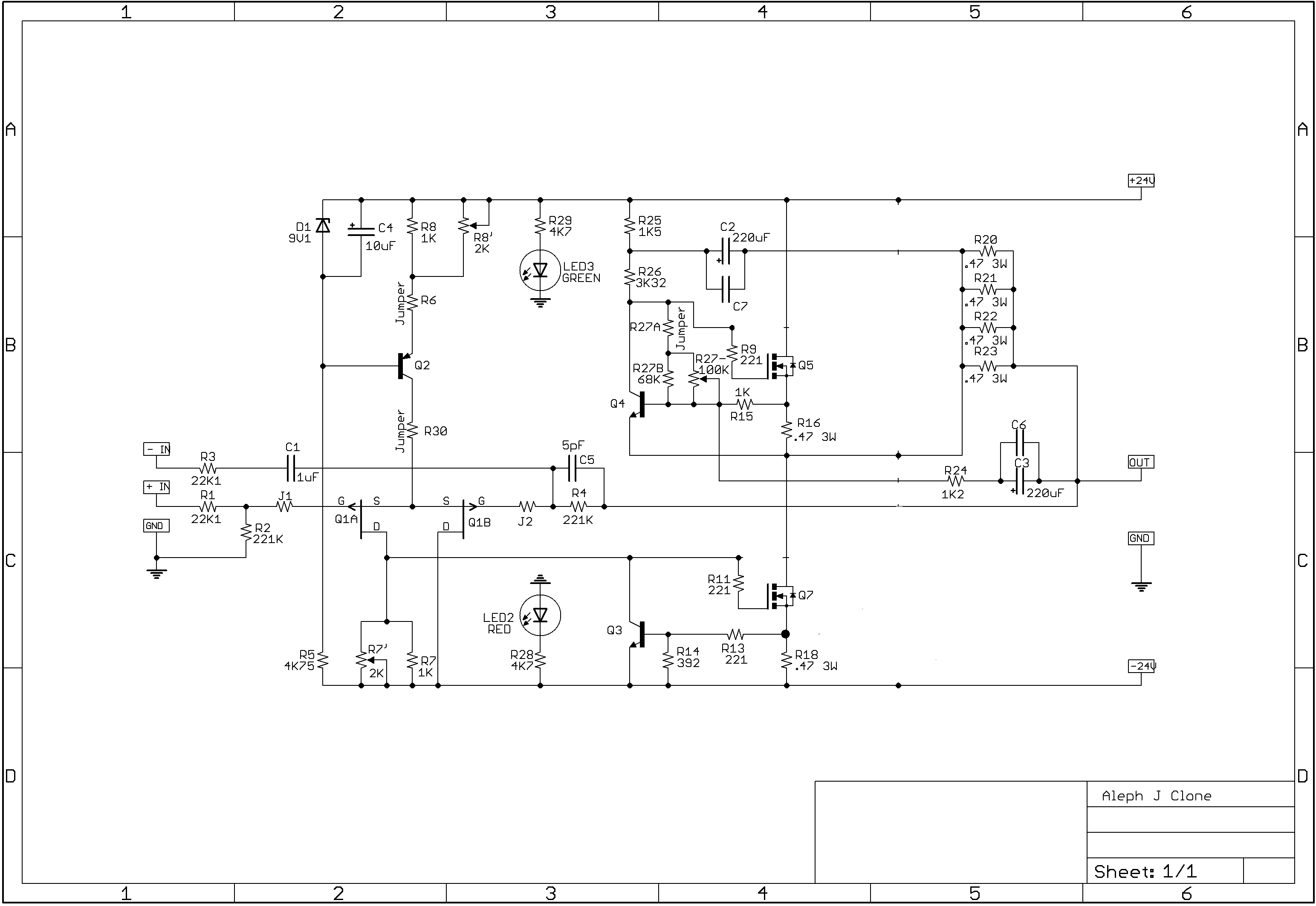

I have attached the AlephJ schm. and the BOM from the DIYaudio store here, but i really would have liked that the values was written on the schematic instead. If you need that, then i can go to my work and print it out, write the values on the schematic, and scan it up again?

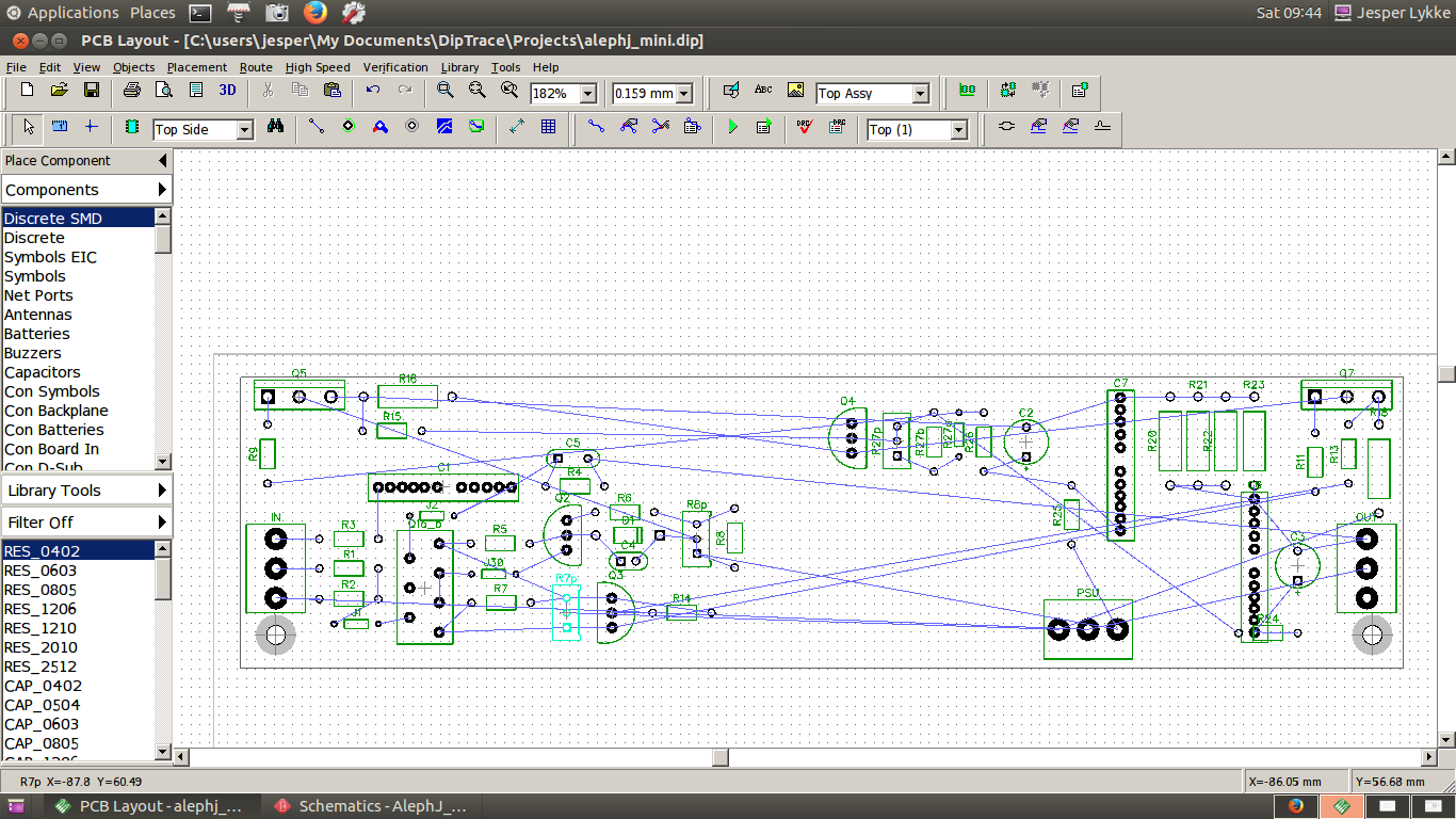

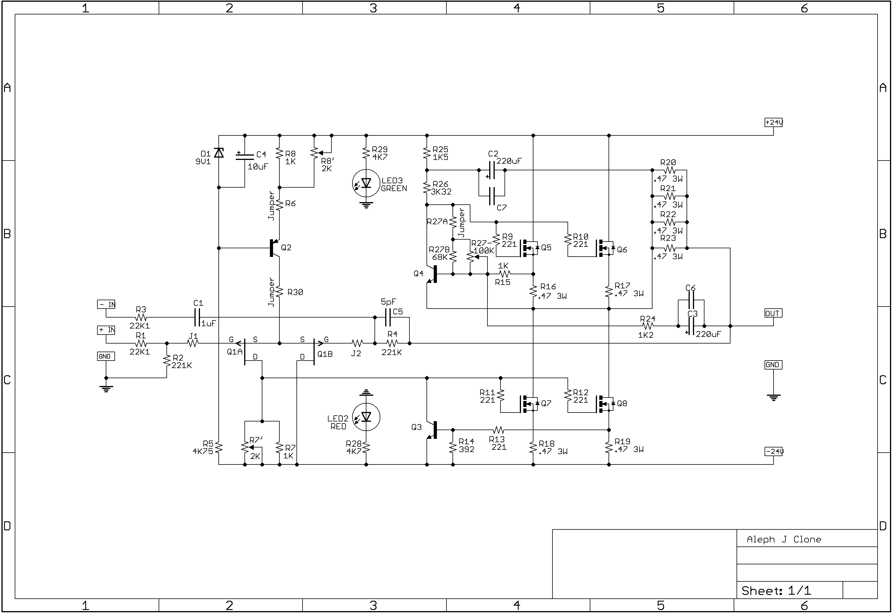

I started a layout for this proto mini alephj tryout 🙂

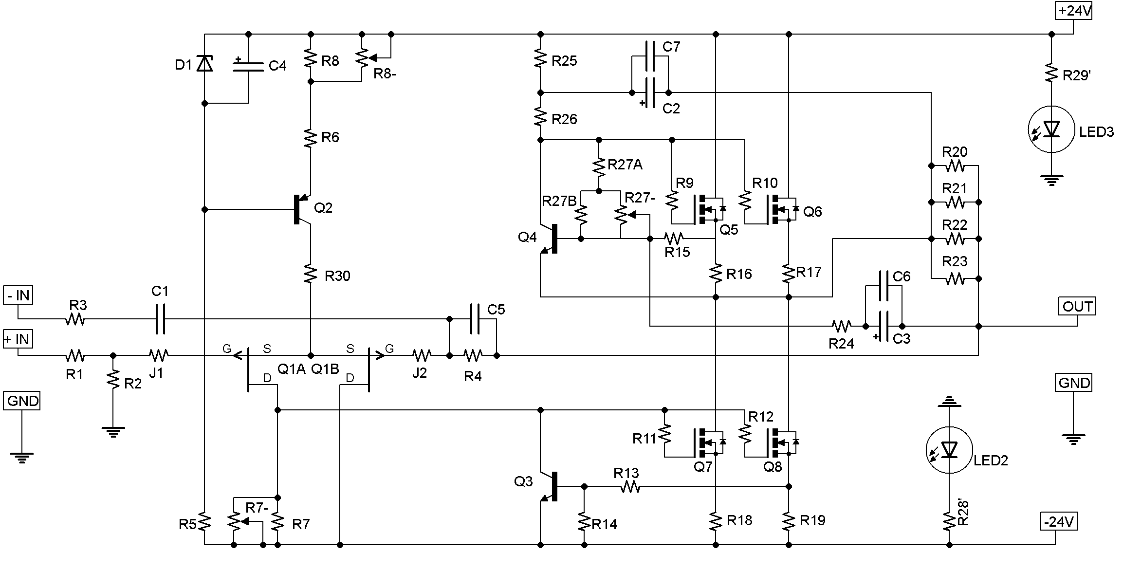

Maybee someone could have a look at attached schematic? -I have removed one pair of output mosfets (IRFP240).
If one look at the connections of the original dual output schematic, there is a connection from transistor q4 to q5 (upper half of circuit) and a connection from q3 to q8 (lower half of circuit)
The connection from q8 i removed and connected it to q7 instead (See attachments)
Is this correct? -Maybee someone could explain? -I mean i don't understand why connection from q3/q4 only goes to one of the output pairs on original AlephJ schm, 😕
Jesper.
It controls the voltage at the gate of both mosfets, it does not need to be connected to both mosfet source pins to achieve that.
I would leave off Q3 altogether. It's only there for fools who abuse their equipment.

I found the original schm.
There is added an extra pot in diyaudiostore's schm. for adjusting around R27,
I see in original schematic, the connections i was in doubt about, goes excatly like i changed it too 😀

You're modded circuit is perfectly ok (just in case you're still worried).
Thank's... youre explanation cleared it out.
I am doing some layout at moment... still long to go through 🙂

as far as I can see , everything is OK
you can excludeQ3,R13,R14 (overcurrent protection)
put trimpot (as variable resistor) +resistor combo instead of R7 and instead of R27

I did, it's also in diyaudio store schematic.
I attached the schematic i use for reference.

looking at that schematic :
- remove R8'
-remove R27B, use R27 and R27A
-put R7 and R7' in series in drain
will tell you exact values later , still on first morning coffee
- remove R8'
leave it as per Papa's schematic
he's having damn good reason for these values
Yeah exactly, no need for trimpot BS
