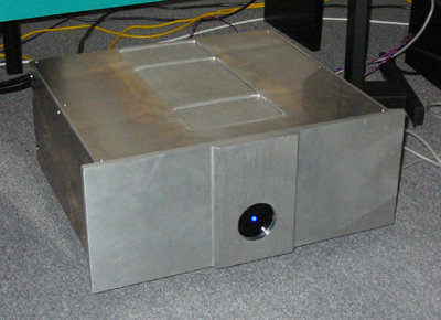

finally (almost) finished
Hi all,
just a pic of the (almost) finished Aleph5. Don´t know how I will finish the case so for now I settle for this "unfinished" look.
Since the last reports I changed the trimmers for R19 and R21 with resistors (49k and 390R) so now it runs at 2.4A bias and about 63% ac current gain (about 6.7A peak).
I will leave it this way and start on a pair of monos with about 31volt rails and 4A bias with 6 paralleled fets. I think this will cure the power problem into 2-3 ohms and make for some happy listening....
william

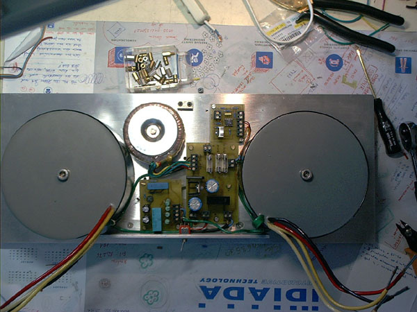

Hi all,
I´m back home again so now I can post some more pictures.
This ones shows the front, seen from the back with the two transformers (600VA, 2x25V), the soft start and the 12V supply with the fuses for the three transformers. The on/off switch is at the bottom.

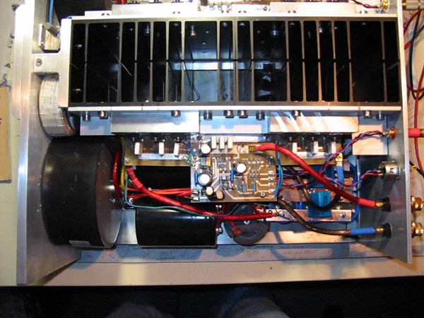

and one more, this the right channel with modified fet "bases" wich bring down the temperature directly next to the fets with almost 10°C (before these I used a 50x50 L-profile wich just couldn´t get the heat away fast enough.
william
