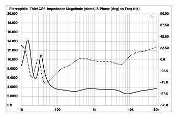

Hi William,
It sounds like the lack of available current is the problem. I noticed on the Thiel link you provided, that the minimum impedance is 2.4ohms! That down in ribbon territory. Impedance that low will suck up the available current pretty fast. I would suspect the the bass is weak in the 100Hz range or maybe a little higher. This would probably be the range where the woofer impedance bottoms out at 2.4ohms. It's too high a frequency to be effected by the inductive reactance of the cone motion at resonance, but too low a frequency to be effected by the inductive reactance due to the voice coil inductance.

Hi Rod,
here´s a plot of the impedance. Minimum occurs at 8kHz but it´s quite low all the way to a 100Hz.
william

Hi William,
I think your on the right track by expanding the output of your Aleph. If you went to X6 or 12 devices per channel, If you build them in mono blocks, you would have an Aleph 2 with 32V rails. I'm not sure what adjustments would be necessary on the main board, but I'm sure that some resistor value changes would be required.
This should work and get you the extra current you need for your speakers. Hopefully some of our fellow DIY'er can help with some of the specifics.
