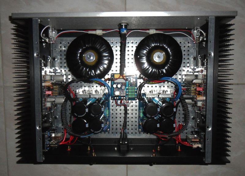

After struggling with hum for over a year and trying many things, I have found that the worst ground loop offender is having two separate PSU's. Whether they be two independent power trafos and two CRC's or one trafo and two CRC boards, nothing helped. Ground loop breaker resistors, star ground with fat 12 ga wires, etc. When I switched to a single PSU like the new F6 design, the ground loops and hum went away. I am getting 100uV noise at my amp outputs on the Aleph J with the F6 PSU. So in the end, I have given up on dual mono PSU's despite the advantages of better stereo separation - but not worth it if one can't get rid of audible hum. The F6 PSU has an additional stage of separate RC filtering to improve stereo separation somewhat.
I can highly recommend this PSU (follow the topology exactly though - I did mine in P2P with solid 12ga copper from household mains wiring as the GND bus):
Here is my amp with the Fluke 101 showin 0.1mV rms (excuse the messy wiring, it's quiet and with the cover on, no-one notices - also, I move things around a lot - many amps pass through this case, hence the spade connectors on my Aleph J PCB):

Let's see if I can get clear shots, problem is that some of the wires are inside the frameworks pipes in present frame.. There's prob quite a mess after trying many grounding variations.

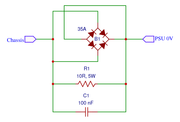

If you're assembling a true dual mono then the only thing in common is the chassis, so only final ground of each channel PSU should be tied together. Modules shouldn't share anything except earth, just like mono-blocs, right?
You can use a circuit like this one for each PSU and tie the chassis side on the schematics together in a star topology directly to the chassis earth. This way you isolate each PSU. If you connect the 0V of each PSU together then to chassis earth (chassis ground) then you don't have dual mono anymore. Please do correct me if I'm wrong
*** Make sure you always observe the electrical code in your area since some circuits could be illegal.
I know that some of my personal amps are using floating ground and it could be risky but the amp is in my listening room and no one touches it. I'm also not worried about 19Vac (120Vac primary) killing me and the risk of the transformer to go bad is as good as me winning the lottery... So I'll take the chance. When I sell my amps, I always make sure I change it and earth the PSUs appropriately though.

Hi Do,
I made a ground loop breaker (GLB) just like you show to connect the 0v (clean GND) of each PSU to central earth ground. I don’t think having a common low impedance power GND between two monoblock PSU’s makes it a non monoblock anymore. The trick is to prevent large currents in one channel from modulating the other. A common low impedance GND is indeed what is needed to prevent ground loops.
