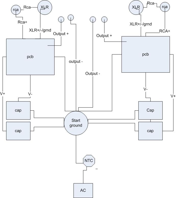

So after two years I rebuild my aleph5 with a new psu and more easy to access layout, see my earlier problems at:
http://www.diyaudio.com/forums/showthread.php?s=&threadid=52936
The amp is working fine but now I have a humm problem.
When all inputs are empty there is nearly no audible hum. If I connect a shorted inputcable to the right channel (or left) the hum starts (no preamp just cable). When I attach my preamp to 1 channel it gets louder, it doesn't mather if the preamp is turned on.
Please help me to find the ground problem :(
Groundschematic, chassis is not grounded since it is glued together ;)

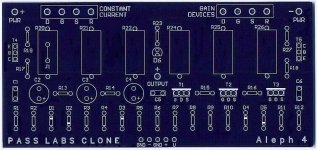

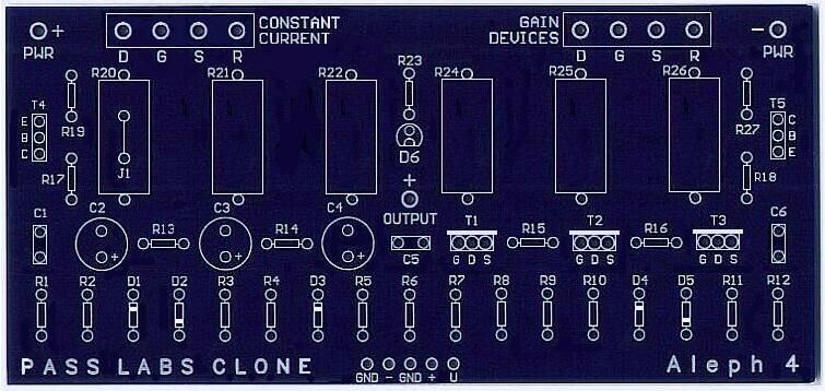

The pcb's are the origanal ones I bought about 5 years ago: http://www.kk-pcb.com/aleph-4.html, the fets are hard wired.

Assuming that I'm reading your diagram correctly and that it accurately reflects what you have in your circuit, you'll need to make sure that the inputs (both RCA & XLR) attach to ground in some manner. Also, why are the RCA jacks connected to both the XLR and the circuit board? One or the other I can understand, but not both.
Depending on how close your amp is to other things that might induce hum, you might need a chassis that shields the circuit. I've got some Aleph 2s that function just fine naked, but you may have something nearby that's causing problems.
As far as support for the kk boards, I would suggest that you contact the fellow who sold you the boards. I've never seen a set and have no idea how they're laid out. He should support his boards.

rwagter said:
only the negative input is grounded (with a jumper). The rca groud goes to the XLR ground which goes to the PCB.
Hello! From what I see, your pcb asks for balanced GND and Unbalanced GND to go separately to their respective points. I would test without the bridge from RCA cold to XLR GND to PCB. I would go XLR 2+3-1GND, RCA hot U, cold GND PCB left.

My quickly drawn schematic was, as it seems, not very clear. But after some changes I wilt try to describe the fenomenon a little bit in more detail for 1 channel (the other one acts the same.)
Input:
XLR + --> pcb+
XLR - --> pcb-
rca + --> pcb unbalanced
rca ground and XLR ground --> star ground
Output:
speaker - -->star ground
Other:
pcb ground --> star ground
psu ground --> star ground
star ground --> ntc --> ac ground
chassis --> not grounded (corners are glued and have
no baremetalconnections between each other)
these are all single wires. But here it comes. After turning the amp on dc offset goes to about 13mV when connecting the preamp and the humm gets louder dc offset doesn't gets higher and my multimeter tells me that is exactly 100Hz.

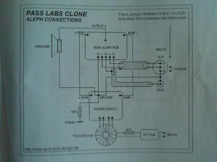

Salas:
I found the wiring schematic that came with the pcb and connected it accordingly. The pcb does have it's own grounding but it concerns not input/output
Here's the part I'm cuurently concerned with. When connecting the aleph to the pre amp out of my sudgen amp I get an increase of humm, when I connect I to the "tape out" (which is unfortunately not controled by any means of attenuation so I cannot use it) there is no increase of hum. Where do I start seaching now.
