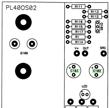

Now I have some issues for coupling caps. The space for them is really tight. If I put them upright only 10x15mm (DxH) caps can in on the boards for C102 & 103.
If I get Elna RFS, they are easily 10x20 ~ 16x30mm even just 220uF. Hugh!
The current idea is to
* solder the cap (C101, 102, & 103) horizontally with bent leads
* solder on cap (C103) on the correct side of PCB and the other (C102) on the wrong side of PCB
Such horizontal way also move C103 away from bare alumina heatsink.
Or I can use Nichicon 220uF/50V, 105F and they are 10x10mm without any of those problem. 440uF caps are just too big and have to use the horizontal scheme.
High capacitance also has higher ripple current, does that matter for these coupling caps?
What is your suggestions? Thanks!

you have 3pcs of 220uF caps per channel , according to schmtc
C101 and C103 are more important than C102
so - for C101 and C103: in your boots I'll solder some fine MKC (polycarbonat) of 10-100nF on "right side" , and fine Elna Silmics on copper ( inner ) side of pcb
for C103 - either use Silmic again or any other decent cap , but you can solder it on any side , depending of dimensions
not really big fuss
not really big fuss
ZM, some more hint, please. What's the purpose or scheme of using those MKC caps? to provide leads to the "back" (copper) side for Silmics cap? I am lost here.you have 3pcs of 220uF caps per channel , according to schmtc
Actually C101 was the one by itself. I can use large one if lay it horizontally. (or with your scheme if I can figure out what you meant)for C103 - either use Silmic again or any other decent cap , but you can solder it on any side , depending of dimensions
Got it. Last time I got advice on bypassing the power filtering cap and found the treble became more stressed than what I like. Then I read some debates on this topic. I guess it makes more sense to try it on coupling caps (C101 & 103, right?)
I finally settle down to Elna caps with biggest size allowed in Aleph3. They all will need to be mounted on the back side of PCB. Also got some Panasonic power filtering caps. But again due to the diameter and lead spacing limit, I can use up to 33mF/25V.
This brings another question: can I find some DIY PSU board that allows larger caps and still can be fit in Aleph 3? And does DIY Pass Lab amps take liberty to have PCB that allow generous sized components?
leave it as is - with original pcb
if you want better - you need to go with complete dual mono route , with Jfet front end - say as Aleph J or Babelfish J ( my shameless knock-off of original)
recapping it , with increased PSU caps is max you can do in that case ;
changing it too much would be blasphemy , without substantial benefits
so - conclusion - finish what you already intend to do with original one , and - if you want better - build two mono blocks , from scratch
