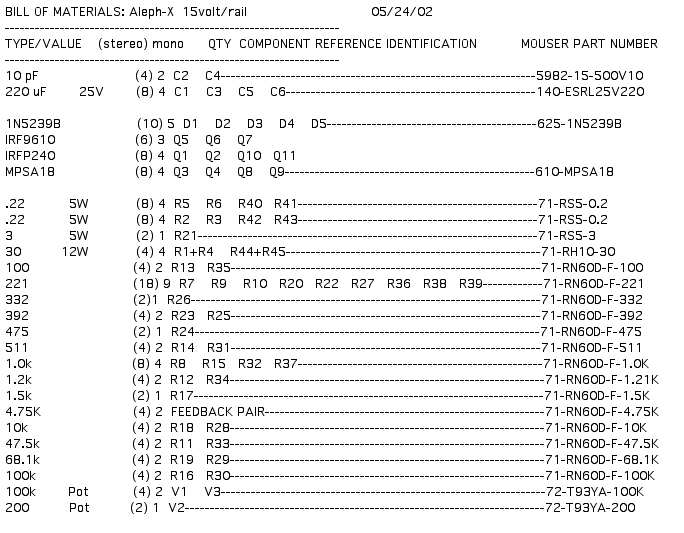

Here's a parts list with many of the part numbers. Look it over and correct me if you discover any errors.

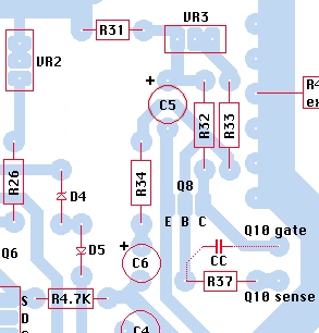

both sides now......
I forgot to mention; if you install comp caps, do so to both sides of the circuit board. This is a twin configuration.

Several small glitches:
First: I remember asking for plated through holes. The holes are not plated through. I don't have the original website take-off form from Mega Circuits to refer back to. I can't find this particular request in writing through any of my correspondence with them. I remember verbal communication over the phone, but if it's not in writing, then there's probably nothing I can do. I tried the holes against the components and they feel just snug enough for an excellent fit.
Second: there are a few small printing errors in the transistor labeling dept. The bases "B" on Q4 Q8 Q9 are mislabeled as "A". I checked the boards against my art and my art is correct. I'll be emailing Mega Circuits about this little problem. It won't be difficult to work around. Heck, it makes it easy to identify the first thirty amplifiers. 100 years from now, when they become vintage, this will be the identifying mark.
Third: the board color is green, not white. The silkscreening is black, I would have asked for white if I'd known that the boards were going to be this dark. The labeling is decent quality, just a bit hard to read against the green backing.
I don't mean to sound picky, guys. I'm a bit of a perfectionist and just want everyone to be pleased with their purchase. I believe these pcbs will work just fine.

Beating a dead horse.......
Ok, I got a reply from the supplier: Since I sent them single sided artwork, they manufactured single sided pcbs for this order. According to Doug, the salesman, I would have had to order double sided boards for plated through holes with $3.50/board in added expense. Now, this misunderstanding never seemed to be a problem with ECD and I never guessed that it would be a problem with Mega Circuits either.
Also, double sided pcbs have solder mask on both sides (our pcbs have the mask on the trace side) and the silk screening color is automatically white. Hummmmm. I wonder why I was told that the board color was off-white?
My apologies go out to anyone who feels that I let them down.
