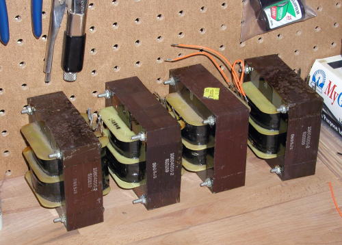

That was actually Plitron. But the drop was more than estimated 6% regulation. Unless I was pushing it too much.😉
What I was meaning by not that simple, is actually how transformer behaves in a real world. It is my experience that it is not always as they claim. I have two identical trafos from Plitron and one is much noisier than the other, both connected to the same outlet.
With the Aleph X type of circuits, where supplies voltage is in the 12-15V range, 2V makes quite a difference.
Transformer are the purest form of electrical machinery, 99.9% efficient (the kind in power distribution grids), very straight forward to calculate and size. The biggest problem is construction, how much tension you give to the windings, how nicely you tighten up the core, the wire gauge, the quality of the iron you use etc. Making transformers is basically an art form. The old potted military transformers where built the best vibrate less, heat less, just plain performed better. Initially what I was trying to locate was a few of those 12vct transformers used for tube heaters. The toroidal from Plitron are a long way from that quality standard, at least the power variety, maybe the medical type are better, I don't know.
As Peter stated I found a large spread in Plitron perforamance parameters. The worst I have seen was with an 80 VA 60-0-60 which was more like 75-0-75 idle.
