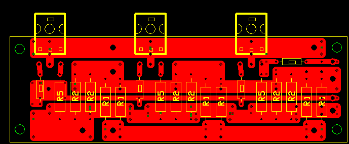

I have sent this little gizmo to Chad for considaration, it's a universal output board, add 4 of these (or More) x chn to increase the output dissipation. I was shooting for a monoblock with a total of 180-200W dissipated x chn.

Output boards look great! They should work good with the boards. I am planning on using 3 devices per bank for my Aleph-X monoblocks. My first version is only using 2 per bank, with my current heatsinks. I am aiming for 16v rails with 5A of total current.
