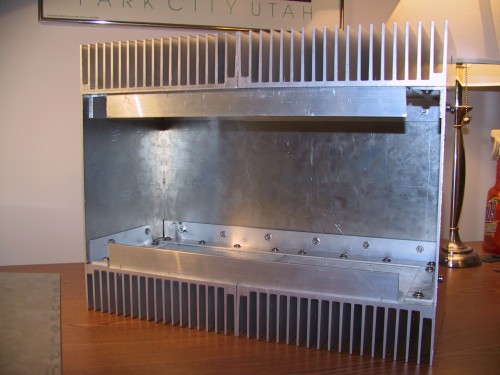

Re: Two heatsinks on each side
Dennis Hui said:
Do you think it's feasible to use two of these heatsinks
on each without compromising the structural integrity
of the case?
Thanks,
Dennis
I made a chassis with 2 - 8"x9" heatsinks per side, and with the L brackets on top and bottom keeping the heatsinks together and the sides of the case, it is quite stable. Here is what I am referring to:
You should be able to do the same thing with the larger heatsinks with no problems.
More of my chassis pics at:
http://brian.darg.net/chassis
It is a very stable case. All aluminum is 1/8" thick 6061T5 (what metal supermarkets carries) It is very stable even without any top and bottom on it. The stability comes from the L brackets, and the front and back panels. I can stand on the chassis when it is put together, and it doesn't flex too much. For the screws, I tapped #10-24 holes for screwing all the L brackets to the heatsink.
Brian

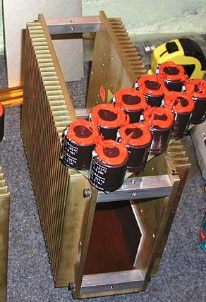

I'll be doing quite a few of those amps and I was thinking about easy way to do it.
One possibility is to connect both heat sink sides with 4 square bars, (like pic below). This would easily make the chassis. All you need to finish the box are 4 cover pannels. Since recently wood became trendy😉 and pretty good looking (and possibly better sounding), one could do the panels out of quality wood and stain it. Much easier than aluminum and easier to finish as well. I would leave 1/8" gap between wood panels and heat sinks for ventilation. Wood could also be attached to bars with some sort of plasic spacers so less heat is transferred.
I would be looking for at least 1/2" thick wooden boards (HD has a nice selection). Maple would be on top of my list.
A clarification .... it doesn't have to be L bars since most of us (I think) won't be using TO-3 mosfets. For myself, just a regular bar would be sufficient - the thickness of bar to be thick enough to drill #10 screws on it.
Now, if someone decides on all aluminum chassis, I don't recommend angles. It's better to use 3/4" x 1" solid bars. The main reason is that front and rear face of the bar makes the attachment surface for front and rear panels. Two bars per heat sink would be enough. My bars had to be milled, because I was using TO-3 type devices. With TO-247, they are not needed. devices are mounted directly to the sink.
