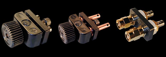

Speaking of cardas binding posts for the X amp, can anybody recommend there patented binding post. It is the one in the picture all the way to the far left. I have never actually try them but they look like they’re easier to tighten by hand then typical binding post because of the big screw in the center. I also like that the plastic piece in the center moves only backwards and forwards and not around and around. The binding post in the picture to the far right is another post sold by cardas for exactly the same price as their patented binding posts. I am a cardas OME so I can get good prices on all there stuff.

The ones on the left look pretty weird. I don't know if I would like to have them on my amps. They also prohibit the use of banana plugs (not that I like to use them). The ones on the right are more appealing, and you can buy a plastic wrench to tighten them really well.

your cardas posts look better than what's in the picture, they appear to be some type of solid Cu alloy (I should read the datasheet) while the ones in the picture just look gold plated. Am I wrong?
