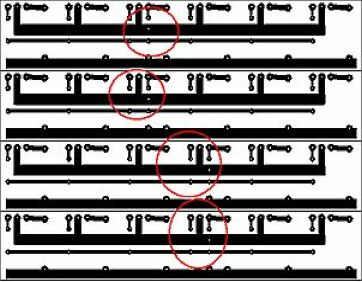

I don't understand that someone can design and then sell the PCBs and not know the difference amoung them.
Also, did you tested all the Pcbs in the operation ?
Correct me if I wrong, but on the your PCBs I see a couple of serious errors !
I'm sorry I got into all this. I was browsing the Pass forum and noticed a need for boards and a lot of moaning and groaning about PC layout software and other difficulties. A pdf file containing the layouts was posted by BrianGT. So, I figured I can use the file as a guide, make the layouts a little better and offer the boards. Everyone's happy. Making boards is not really a big deal.
Correct me, if I'm wrong, but i don't see any seriousness in that error. Somebody tries to help you out by making boards available and you already start to citisize. I think that not silkscreened boards sound better. If you don't like them, just don't buy them.😉

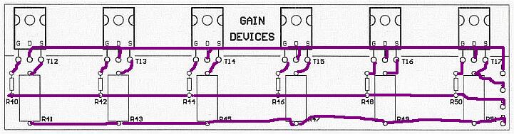

hi,
On the Bill Fitzpatrick PCB, I see the errors in the connections of the gates resistors with the some other resistor that is connected to the FET source.
According to the schematics I think that they are wrongly connected.
Also, at http://web.vip.hr/pcb-design.vip I founded the similar PCB, so I connected all the parts acordingly to the Pass schematics.
If that can help to someone, here it is:

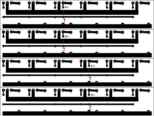

Strobo: You made a bold claim that the layout has some serious errors but you can't prove it. Instead you show us somebody else layout which (at least to me) looks exactly like what Bill has posted. The only difference is the location of the 4 holes for the hard wiring from the output board to the main board. So, once again, could you specifically point out to us what/where is the error!
After all I wasn't right. These are holes for connecting wires for sensing circuits. Strobo, both boards you presented here are correct, it just that the wires on first one are taken from the position in the center and on the other from the side. Now I start to be sorry I got into all this.🙄

The fcel and HPotter are right.
I also believe that the output PCBs of the Bill Fizpatrick are without errors and that they should work without any problems.
To the amateur, the PCBs can really look like that they have somes aditoinal resistors, but they really don't have them.
It's depends from what perspective you look at the PCB.
The areas on the PCBs that's look like the spaces for the aditional resistors are infact the terminals for the Sense and Gate wires.
At least at the mine opinion.
