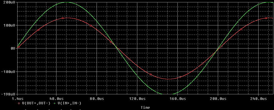

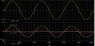

this is the analysis by varying the trimmer for a 1K output potentiometer..
I don't understand one thing.....
This design already has the input regulation by mean the input divider resisor, setting propertly the switches.
why is there a trimmer?
Is it not pointless? may somebody clear this up?

Stefanoo said:this is the analysis by varying the trimmer for a 1K output potentiometer..
The trimmer sets the gain for both channels to be equal. Remember, it's a zero overall feedback circuit and the gain is dependent upon the mosfets parameters.
NP mentions that one can control the volume using a variable resistor in this position. It sounds like a really attractive proposition as a single pot effectively replaces two highly matched ones.
Only it doesn't seem to work that well in practice. You can't get the volume down to zero, you get a weird control characteristic and volume dependent distortion.

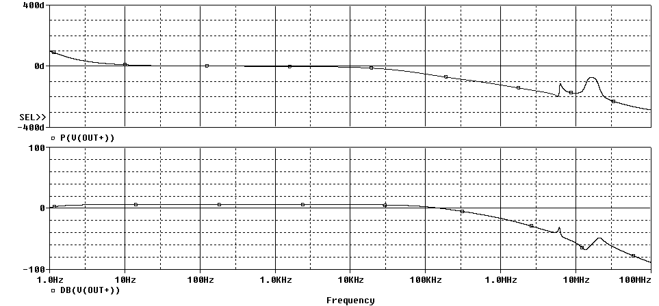

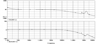

Stefanoo said:finally the frequency response..
is it ok to have that that peaks at around 10MHz? COuld it be a problem for the autooscillations?
Is the simulated behaviour ok for you guys?
Could you please explain what is your vertical axis? One seems to be degrees; how many db per division for the other?
Interesting results. In another thread i mentioned my 1.7 oscillating around 10MHz until i increased the grid stoppers.
Stefanoo, glad to see you got your sim running all the way through 😀 A convergence problem is a typical type of error. Ussually they are due to high gain or oscilation or something a little bit wrong somewhere. When you get the window that allows you to change some parameters, I ussually lower the current resolution a couple decades(I think thats right, go down to E-9 or 6) and the sim will go all the way through...
I believe my pre has a little bump starting at 750kHz or so (in reality) but those are the sorts of things that a real circuit may differ from a simmed circuit on.

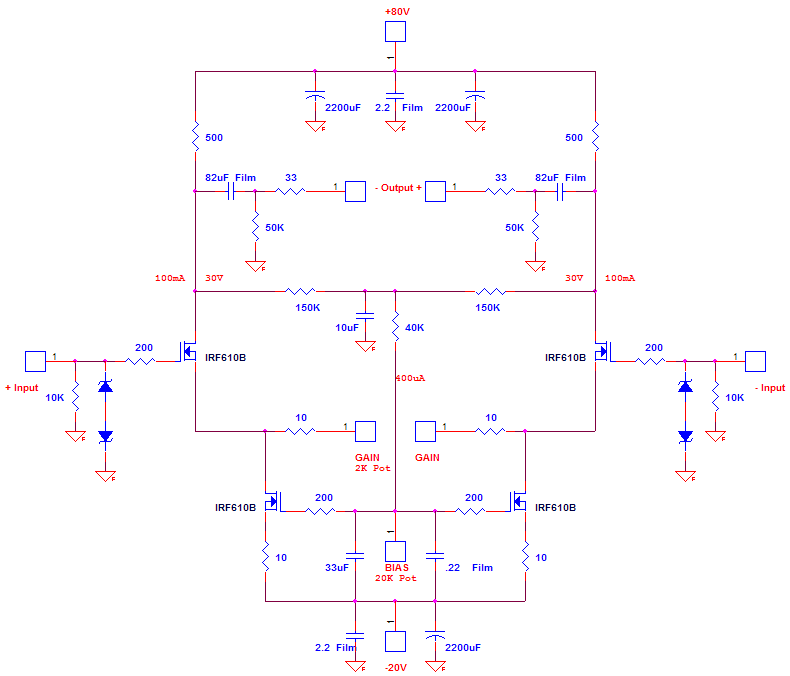

I have included a pic of my Pass "variation" pre for you and everyone to comment on, or build, if you like 😀 😀 😀

flg,
Nice iteration.
At least for me there are some undefine areas on the schematic, like were you connect the attenuator, Gain pot? Bias?
Could we have some details on these?
and the most important Q, how does it sound? Compared to P 1.7?
