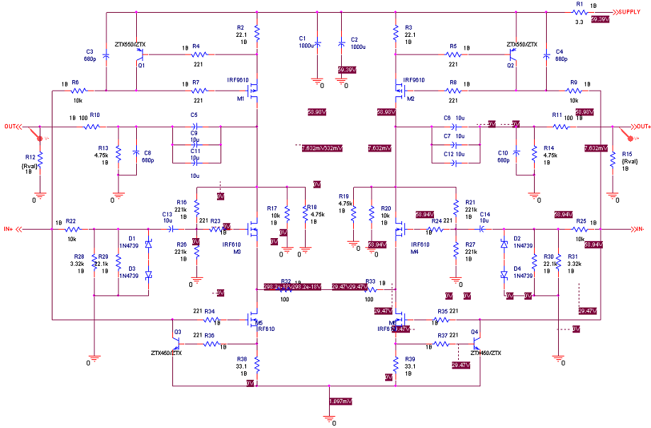

apassgear, Sorry
Yea, the gain pot goes from the 10 ohm to the other 10 ohm. If your going to ask why I have 2 10 ohms in there, I don't remember why! You need 20 or 40 or so or it will go bananas at the low end of the pot. I think with only about 25 or 30 ohms you can get pretty rediculous preamp gain if you need it...
The Bias pot goes to the - Supply 😀 😀 😀 I guess that is one of the differences from an N.P. circuit.
I have one with only about 55mA per side and 1K load Rs too. I could not really say which works better but the one with 1K load Rs is much lower temp. and I think a little quieter... BTW I used Caddock 500 and 1K TO-220 Rs for the gain stage load Rs and they are on heatsinks too...
I've never built an Aleph 1.7 but I like mine better than the BOSOZ. I went this far mostly based on the resistance to "current source" loads and the desire to have an S.E. to Balanced Pre. There are those who say a resistive load in the gain stage sounds better 😕 I drive a FET Circlotron amp that I am trying to finish up and put in a final chasisn now, after a year or so. I was going to put the pre in with it since Circlotron is a follower. However, N.P. recently said he might come up with a High Voltage Pre project for his new followers
I'm waiting to see what that stuff is...
BTW, my somewhat extreme diff thing is good for at least 25V or more of clean output for those head room freaks 😀

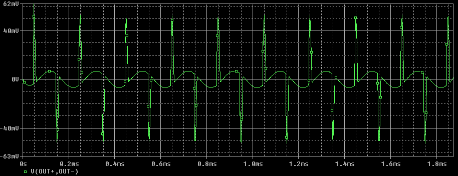

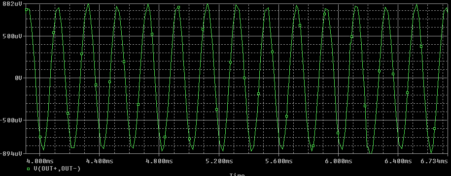

sorry, but i don't agree with you.
I don't have much experience with simulators but in this case, for example, was enough a propertly change on the setting, to get it goin'!
Who knows if a propertly set up for the Aleph X model would have helped it to work (on the simulation)...who knows! (i will probabilily try next)
I personally think that the simulator it's just a start and no more of that!
Don't get wrong: i'm a real audiophile and so ...for me.... the listening is VERY important and can't be replaced by anything.
Last thing: i don't put Nelson Pass circuit into simulation because i have doubts that they work.
It's, in the case, the opposite concept.
Since i'm convinced that they work perfectly..i use them to get a better handle of all the simulators (Capture, VHDL, PSpice -Advanced SIM) and to get more expierence on building projects.

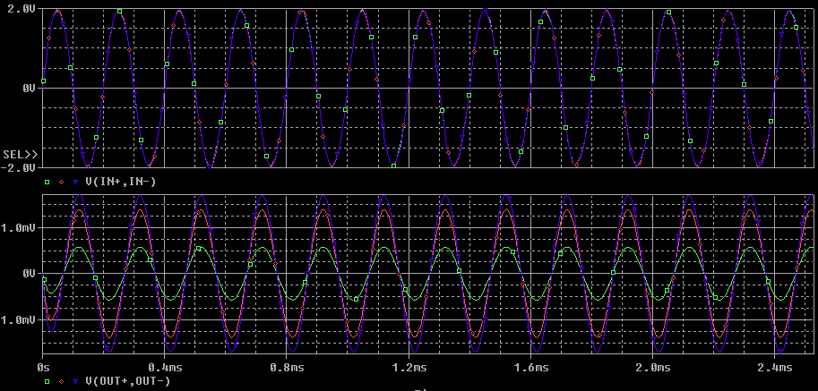

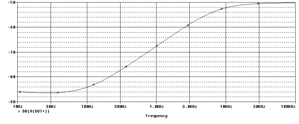

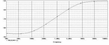

Something's wrong here...you're using circuits to learn a software program? From my (admittedly) music-centric viewpoint, that's kinda-sorta...well...backwards. But if playing with software is more important to you than building circuits and listening to them, then have at it.
I confess that I'm not clear as to how you feel that simulation programs give you experience building circuits. They don't. All they do is give you experience at simulating things--experience which doesn't translate very well (if at all) into the real world. Only building circuits can give you experience building circuits.
Grey
don't get wrong!
I really like to get more practice on BUILDING projects!!!
My viewpoint is that the simulator, if properly used, can help you-- but not replace the actual practice.
That's all i meant!
That's all i meant!
