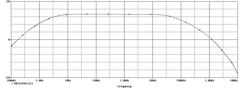

I disagree with the quality of the LM336.
I think that a better choices might be achieved, but i do agree yet, it is a decent voltage reference.
If you look at the curve you have just posted you will notice that non-linearityes decrease by increasing VDS and a good spot would be something around 8-10V.
I have also read various experiences on cascoding and good results, soundwise speaking are always achieved with a VDS over 7V.
GaryB said:
Martin,
Thanks for the comments.
I respectfully disagree. If the current is changing between the two halves of the differential pair then the voltage of the common sources has to change. It changes less than the signal level since currents in jfets have a square law dependence on the voltage change, but it does change. We can argue whether or not this effect is significant or not but my experience has been positive with the use of the bootstrap cascode configuration so my experience is that this effect is important.
I never experimented with this. The datasheet of the 2SK389 shows that even 5v is plenty to put the transistors into the saturation region, which is the goal. But they can handle higher voltage and it would not hurt. I suspect the effect won't be significant.
---Gary
Just my two cents.

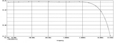

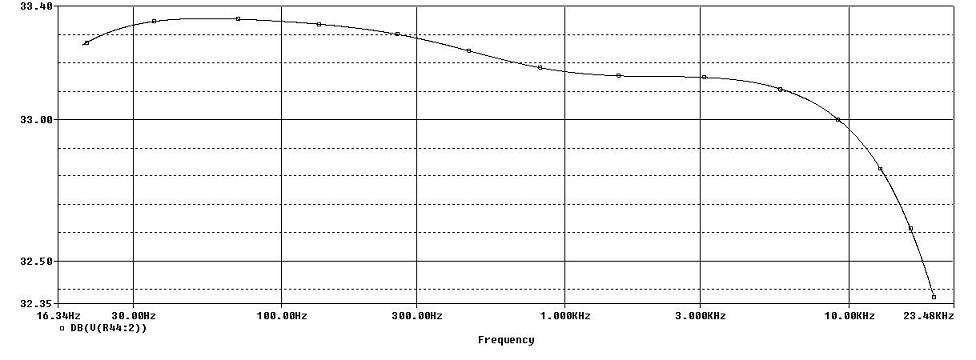

Hi everybody,
i am just done with the new RIAA network.
I like it a lot and i can't wait to put everything together and try it out
....i know it will take awhile....but that's ok.
I want to share my results with you guys so feel free to comment.
Just a short description:
Got rid of the 2 X 220uF electrolytic cap on the RIAA network as i have always thought it was pointless to have good Teflon cap and Electrolytics messing up the fine quality of the other film caps.
Anyways: the nice thing is that (i am just going to use MC so no MM inputs) with the same amount of coupling cap from the MC to the MM stage the bottom end response is much more extended.\
By increasing the resistor R20 up to 200Kohm (can this high value eventually create issue with stray field pick up?) with a 2.2uF coupling cap the low freq response is down to 1.2Hz or so.
This is very nice: with the same price of a good 10uF or higher film cap, I can buy an excellent lower value Mundorf Silver/oil or silver Gold Cap.
Since the MC stage, once the buffer stage is removed, is global feedback-less , I feel that quality of the stage strongly depends upon coupling caps and surrounding parts.
All values chosen for the RIAA are available on the V-CAP TFTF Range.
Resistor are Naked Vishay S102
All the results posted are obtained using a 2.2uF 200Kohm high pass filter from the MC to the MM.
First pic is the original network (0.1Hz 10MHz)
Feel free to comment.

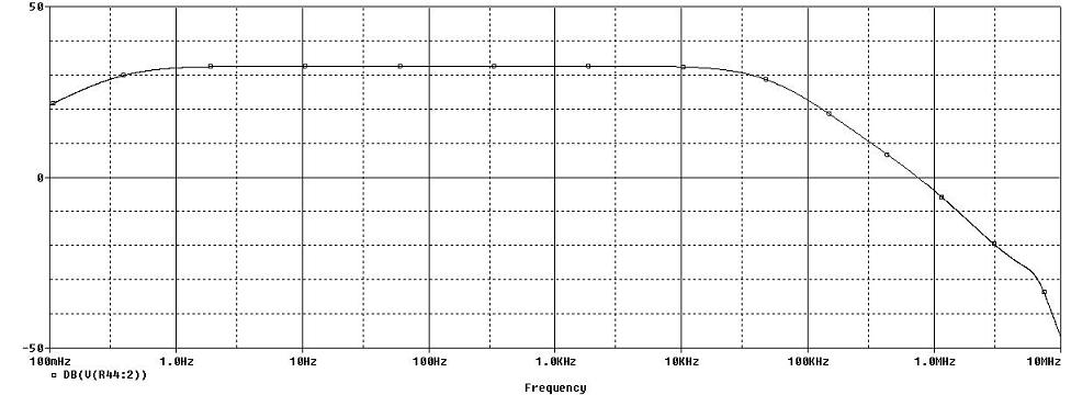

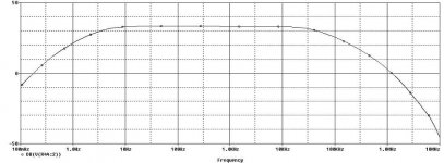

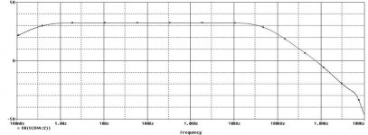

Now, new RIAA 0.1Hz -10MHz
in this configuration i can see a little peak at 8MHz or so which i have no clue if can cause any HF unstability issues or not.
The top freq resp can be smoothed a little more by changing the cut frequency of the HF filter.
A 180KHz freq cut was chosen to take full advantage of the top end response of the amplifier awhile on the original i think it was set at around 150KHz or so.

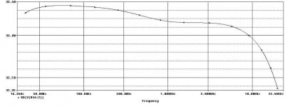

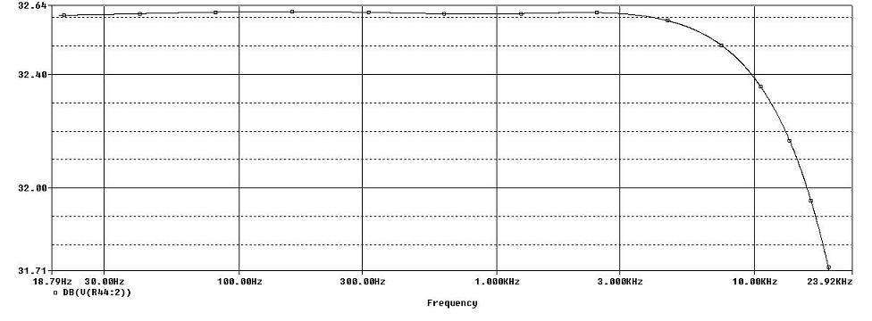

last pic is the close shoot at the new network in the 20Hz-20KHz range.
This last pic if compared with the original shows a better RIAA equalization.
The difference is small but yet, still nice to have slight improvement over the already good RIAA eq of the original.
the nicest thing of this network is that allows a lower coupling cap value and yet achieving a lower low freq cut and second allows to get rid of the 2 annoying 220uF Electrolytic cap.
any comment is appreciated.
new RIAA?
Stefano,
I'm not sure that I understand what you've changed and because of that I don't really understand the curves that you are posting.
Could you explain more about what changes you are making?
Thanks,
---Gary
Stefano,
Thanks,
---Gary
Gary,
I will try to explain it better.
My modifications involved the RIAA network.
I have changed the configuration of the RIAA and with the new one i got a lower cut off frequency and a little better RIAA equalization.
The lower cut off freq allows me to choose a lower value for the coupling capacitor (with 2.2uF the cut off freq is under 1Hz).
I have a question:
can the the former resistor of th DC blocking filter this be scaled up as much as i want and use a lower DC blocking cap?
Is there any drawback by choosing lets say 1uf 200Kohm rather than 2.2uf 90Kohm?
The higher impedance should come handy since the inverting/buffer stage on the MC has been taken off, right?
Anyways, going back to the pictures i have posted:
they referred to the original RIAA network (the ONO) and the modified one,respectively.
I have posted for each one the frequency response on the 0.1Hz-10MHz range and on the 20Hz-20KHz range to see in more detail the RIAA response on the audio spectrum.
the first two are referring to the ono and the last two to the modified network.
if something is not clear yet, please let me know and i will try to clear it up
Stefano,
A few comments. Rather than give you answers to your questions, I am going to try to teach you how to get the answers on your own.
1)How do you set the resistor at the input of the MM section of the ONO?
The original value is 47kohms, which is standard loading for a MM stage. You can increase this as long as the gate current from the 2SK389 has a good path to ground and doesn't lead to large voltages. That means that Ig x Rin should be very small. Look at the 2SK389 datasheet and estimate the gate current at the operating conditions. You should find out that 200kohms for the input resistor is fine.
2)Can you get rid of the 220uf DC blocking capacitors in the MM section?
Those caps are needed if you can not guarantee that the output of the stage will have 0v on it. The design of the ONO uses a DC blocking output cap which means that those 200uf caps are also needed. Change the circuit so that there is no DC on the output and then you can get rid of those 220uf caps.
3)Can you arbitrarily change the resistor in series with the 220uf caps?
This caps sets the gain of the MM stage along with the other parts of the RIAA network. Making it a bigger value will decrease the gain, which probably isn't a good idea.
4)Other comments.
The response of the MM stage should not be flat. The RIAA network means that it should have gain that drops with frequency. Your curves showing flat frequency response confuse me because they don't show the proper RIAA filter response.
---Gary

That would allow me to use a good 1uF Aura Teflon Cap (i know all exotic parts 🙂 )
Point (3):
i think that you are referring to C1, C41 on the RIAA network when you talk about setting the gain, right (since as far as i am concerned that resistor control the gain of the MM stage)?
If not, please explain this better.
You are right: these caps CANNOT be eliminated on the actual RIAA network's configuration.
What I was saying though, was that RIAA network was re-designed. i didn't just take the 2 X 220uF off, of course 😎 .
On this configuration, there is NO need for such a high value cap and therefore ONLY Teflon V-CAP will be used.
Actually i have been keep playing around with values and RIAA accuracy is now around 0.1dB on 20-20KHz range: not baad!!!
The only problem is that, in order to make one value, i need to parallelize 2 Capacitors and if V-Cap will be used price for 2 units....is a wee bit high 🙂 but that's ok, since the result obtained is really appealing.
point (4):
i didn't specify it, you are right, but i gave it for granted:
if you see a flat response on the wide 0.1Hz 10MHz range, you might wanna think that an inverse RIAA filter to evaluate the flatness of the response at the output is used 🙂 🙂
feel free to comment!
Best,
Stefano.
P.S. nobody replied at the question is matching of the complementary devices ot the output stage is needed for minimum distortion.
