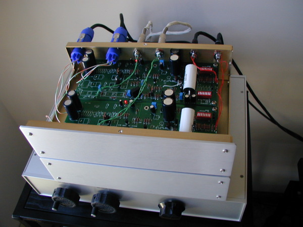

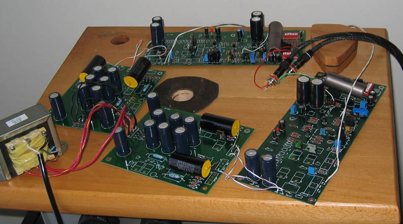

Hi all,
I finally got my Aleph ONO phono stage working. I used the pcb boards that pquadrat laid out and offered up to the DIY community. More details on the boards are found here:
http://www.diyaudio.com/forums/showthread.php?threadid=10326
I did change the design slightly and didn't build in all the functionality that is possible. I didn't bother with the relays since I intend to leave it on all the time. I also didn't need balanced operation, so I eliminated those parts. I also got rid of the output coupling cap per the modification suggested by Peter Daniel.
Other than that I built it as designed. After a bit of listening I decided that I didn't quite like the MC stage and went to the simpler Pearl type 1st stage. This means taking the output directly from R40 and bypassing the last 2SK170 and the electrolytic coupling caps. This cleaned up the mids but slightly hurt the highs. Thinking that this might be related to the moderately high output impedance of the stripped down MC stage, I tried converting the input of the MM stage from cascode to bootstrap cascode.
To do this I removed R17 (10k to ground) and inserted a low noise zener (5v LM336, bypassed with 0.1uf pp cap) from the bases of Q1,2 to the sources of Q5. To get the biases right, I changed R3 to 29Kohm and R7 to 332ohms. This puts about 0.9ma through the zener and keeps the bias of the input transistors unchanged. This change worked very well and restored the nice highs of the original circuit and left the midrange clarity of the simplified MC stage and its what I'm listening to now.
Oh one last hint - I originally used a silver mica cap for C3, which is critical for the high frequency stabilization of the circuit. This didn't seem to cause a problem with the original circuit but with the change to bootstrap cascode this was problematic. Changing to a ceramic returned the circuit to its original well behaved state, suggesting that silver micas don't do too well in the Mhz range.
---Gary

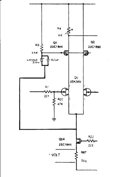

Schematic
---Gary
There hasn't been much response to this, but for completeness I thought I'd include a schematic to make the details of the MM input stage modification clearer.
---Gary

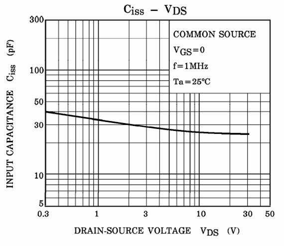

I'm also not sure I understand the comment from Analog-sa. He probably thinks that the input impedance of the MM stage is set by the 47k resistor at the input to the 2SK389 and the output impedance of the MC stage doesn't matter. Perhaps he's right but I don't think so. If you look at the datasheet for the 2SK289, you'll see that the input capacitance changes as Vds changes. I've attached this figure below. The bootstrap cascode configuration keeps Vds constant and eliminates this tendency for Ci to change with signal. I think this effect is more noticeable when you drive this with a high output impedance.
Even if the technical explanation is flawed, the sound quality is definitely improved by this change. It's not too hard so why not try it out.
Hi Gary
Your suspicion is correct. You may be right with your explanation; it's just impossible to prove you are not compensating for the different distorion spectrum after the removal of the NFB stage. It would be interesting to listen to a MM cartridge with and without bootstrapping.

Excuse my ignorance, and maybe I do not understand differential pairs well enough, but I do not see that you are really bootstrapping the common base transistors. You are referencing the cascode to the connection of the common sources with the current source. However, this point should have a more or less fixed voltage - in other words the effect would be the same as referencing the cascode to ground. If one side of the K389 is conducting less the CCS is just forcing more current to the other half, but their voltage should remain fixed.
Secondly, the signal voltages are so small that the capacitance of the K389 should not really change, besides it should be too low to make any differences in the load. So I do not "buy" this explanation either.

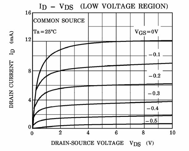

My last comment before I shut up: I believe the 5 Volt reference is setting the drain to source voltage too low. As a minimum I would try 2 references in series to get 10 Volts, that is if you must use them in the first place.

. . . I do not see that you are really bootstrapping the common base transistors. You are referencing the cascode to the connection of the common sources with the current source. However, this point should have a more or less fixed voltage - in other words the effect would be the same as referencing the cascode to ground. If one side of the K389 is conducting less the CCS is just forcing more current to the other half, but their voltage should remain fixed.
Martin,
Thanks for the comments.
I respectfully disagree. If the current is changing between the two halves of the differential pair then the voltage of the common sources has to change. It changes less than the signal level since currents in jfets have a square law dependence on the voltage change, but it does change. We can argue whether or not this effect is significant or not but my experience has been positive with the use of the bootstrap cascode configuration so my experience is that this effect is important.
My last comment before I shut up: I believe the 5 Volt reference is setting the drain to source voltage too low. As a minimum I would try 2 references in series to get 10 Volts, that is if you must use them in the first place. [/B]
I never experimented with this. The datasheet of the 2SK389 shows that even 5v is plenty to put the transistors into the saturation region, which is the goal. But they can handle higher voltage and it would not hurt. I suspect the effect won't be significant.
---Gary

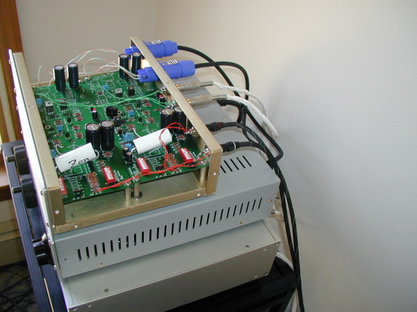

Joined 2002
photos

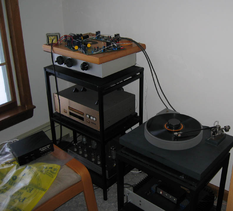

Here is a photo of my ONO in it's final configuration. Originally I stacked the power supply directly below the ONO as shown in the photo but this caused problems. Even with toroidal transformers, I got enough magnetic coupling between the units that there was an unacceptable hum. I found that the power supply needs to be at least 1 foot (30cm) away from the amplification circuits.
---Gary
Gary, you are off course right, the voltgage should change. As I said I did not understand this quite properly. Since this is the summing point of the input and the feedback signal it should somehow be the differential. I might try and sim this to better understand what the combined signal looks like.
