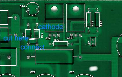

ERROR on power supply PCB !!!
There is a small error in the power supply PCB: D11 has to be changed in direction, and the connection between D11 and D11 has to be changed to reflect this.
Without this fix, the relay will not switch.

Ono project - P2 boards
pquadrat,
I am in the process of building the Ono based on your boards - should have all the parts by end of this week (hopefully getting the 10uF WIMAs...)
What would be the value for R19 when using the MEDER relais (24V) ?
