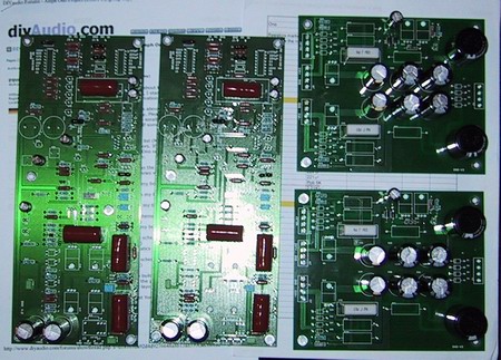

TheMyxin said:mjounot said:Peter
Thanks very much for the boards.
the quality is much appreciated.
What is min. watt rating for R-43,44,70,71
Hello Mike.
I have put in 2 Watt Metalloxid Resistors in my PCB-Board.
Another question for the PCB-Board. As i have seen on Peters
Photos there are no heatsinks on the MOSFETs. right ?
On a photo in the "Audio" magazine 11/2002 i have also not seen any heatsinks for the MOSFETs. Only on for the voltage regulators
(7815 on the PCB-Layout is written)
The MOSFETS on the ono boards do not need heatsinks, they get warm, but not hot, and I think this is intended by design. The original ONO has no heatsinks. I run my power supply MOSFETS without heatsinks,too, but there is room on the board to use them. If You use separate power supplies for both channels, there is absolutely no need for them. And You do not put R70A and R43A on the PS PCB then.
For these I used 2W types, but 1W should be fine.
Because of limited time at the moment, I will check this forum not on a daily base, so I ask everyone to answer questions, too.
-Peter

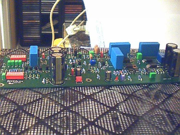

Re: Some Photos
Sorry i have forgotten to add:
I habe some parts left and i will make
a Partlist next week in TXT-Form.
If someone lives nearby Munich he can
of course ask me for this Part-list.
These are mainly the Panasonic FCs
Caps, Some OsCON SH for the smaller
caps.
Some SIMIC for 2,7 nF , WIMA
FKP2,
and the semiconductors
2SK170,2SC1844 and IRFD9110
TheMyxin said:Ok i have nearly finished my Aleph Ono
Boards. Here are a Picture from one
Channel-Board with my Webcam.
I hope you can see the parts.
caps.
FKP2,
