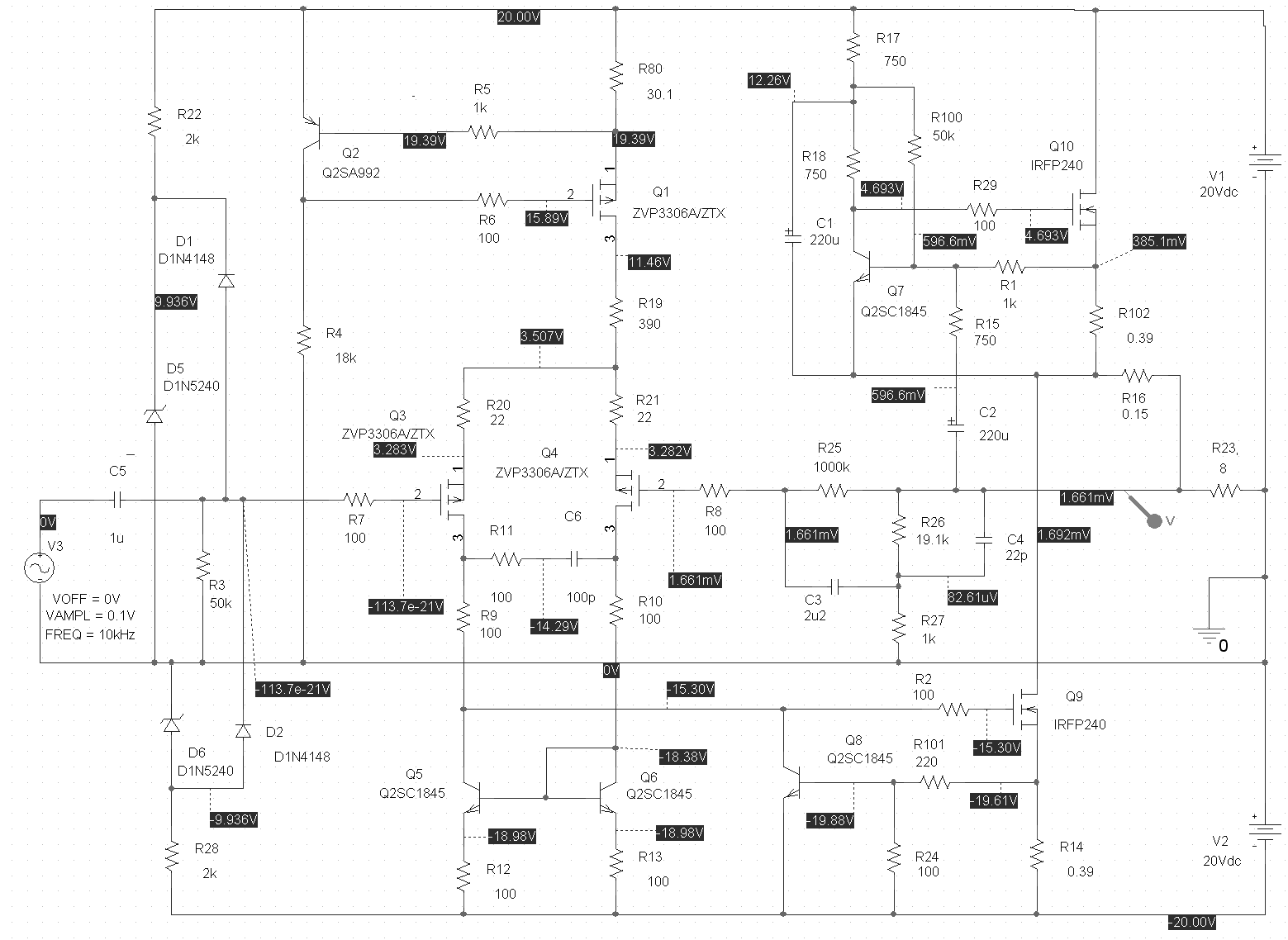

Here's a variant on Grey Rollin's Aleph Mini.
I've added a protection network at the input to prevent some dumbjohn from shuffling across the carpet and dusting the input via ESD.
I changed the input diff pair to the Zetex p-channel devices to reduce the capacitance at the input.
The current source at the tail of the diff input pair has been changed to a "ring of two" source to eliminate the need for selecting the mosfet feeding the diff pair tail.
The mosfets in the diff pair will still need to be closely matched - the degree of match will dictate the output offset of the amplifier. I want to avoid the extra complication of a servo circuit by instead closely matching the input diff pair. This has worked well for me in other projects.
I have chosen to load the diff pair drains with a current mirror rather than resistors.
I pretty much left the Aleph modulated source and the drive current limit alone, except for optimizing the value of aleph current sense resistor for symmetric +/- current drive.
The feedback network was modified to avoid having to use a series electrolytic cap in the feedback network.
Transistors were changed from MPSA18 to high gain devices currently available from FCH/On Semi.
I've added two options for compensation so that I can optimize the phase margin at zero crossing frequency.
The resulting circuit simulates well, and I have gone out for PCBs so I can build up a sample and see how it sounds...

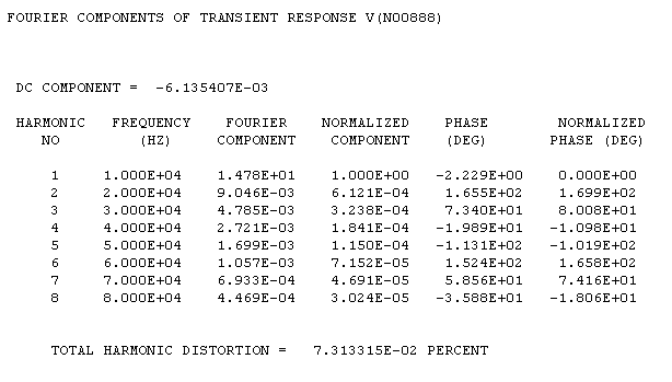

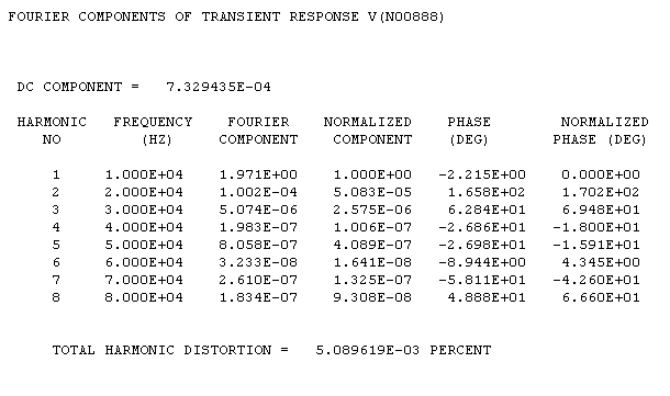

Here's a a simulation with THD results from 0.1V input and 0.75V input. Of course, for a limited open loop gain circuit like this one, the THD will track the input voltage.

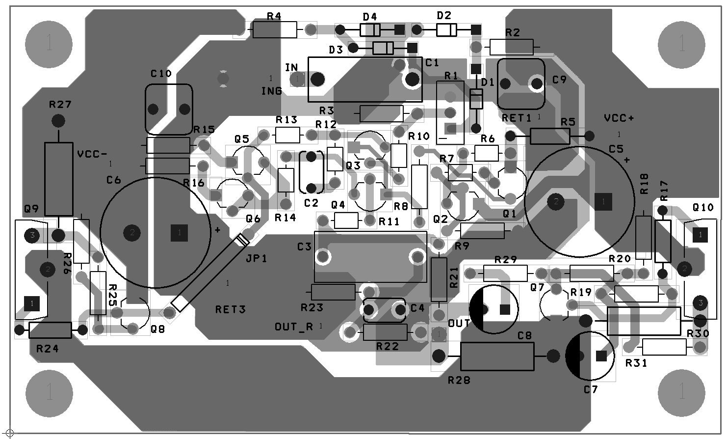

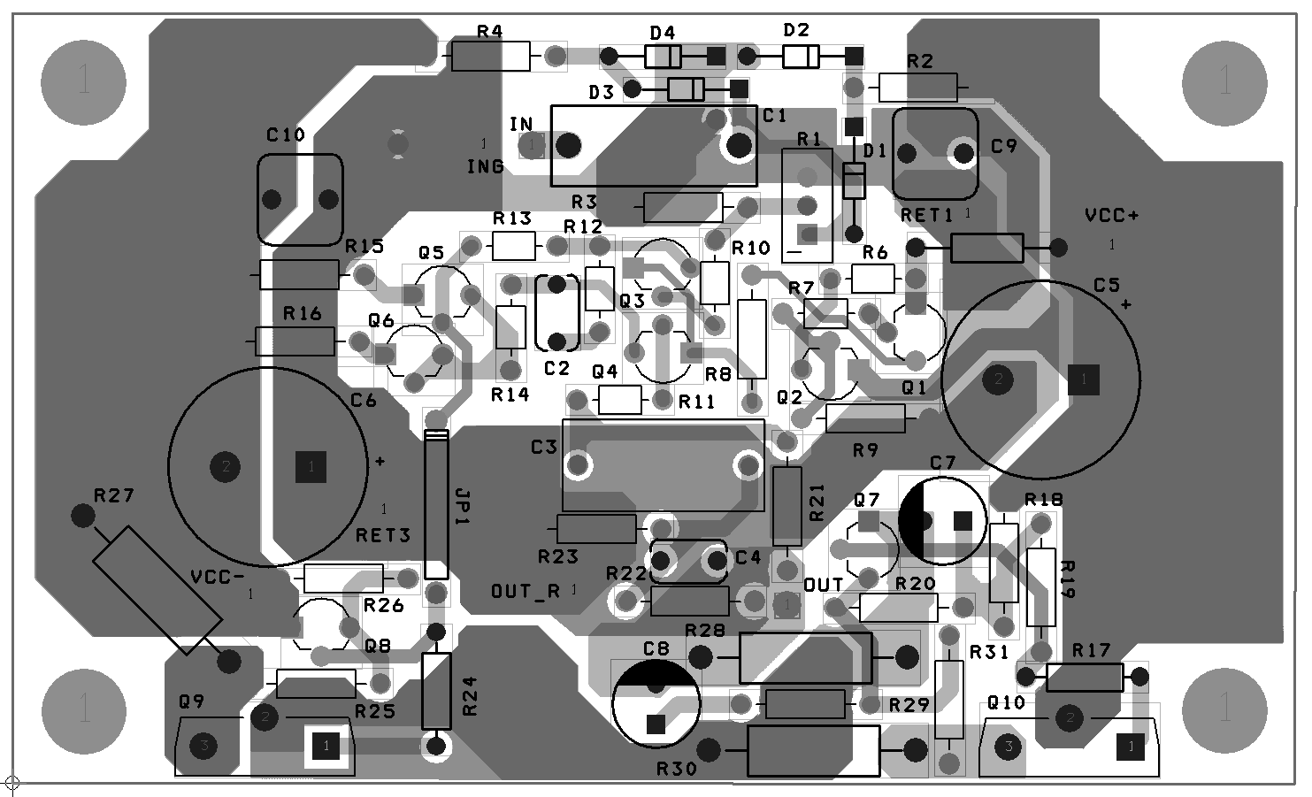

Waiting for boards... I just finished a new layout that moves the power devices to opposite sides of the board to spread things out out the heat sink. Since as a result, the board is now narrower, I should be able to mount the PCB directly on the heat sink, saving some space inside the chassis.

Boards are in house as of yesterday. Strangely enough, both versions of the board arrived simultaneously, though they were ordered a few days apart. Delay on the first board possibly due to non-std red solder mask plus 2 oz copper.
I'm stuffing one channel of the 2nd revision board. Expect some delay, as I'll have to drag out my matching setup for the input mosfets.
