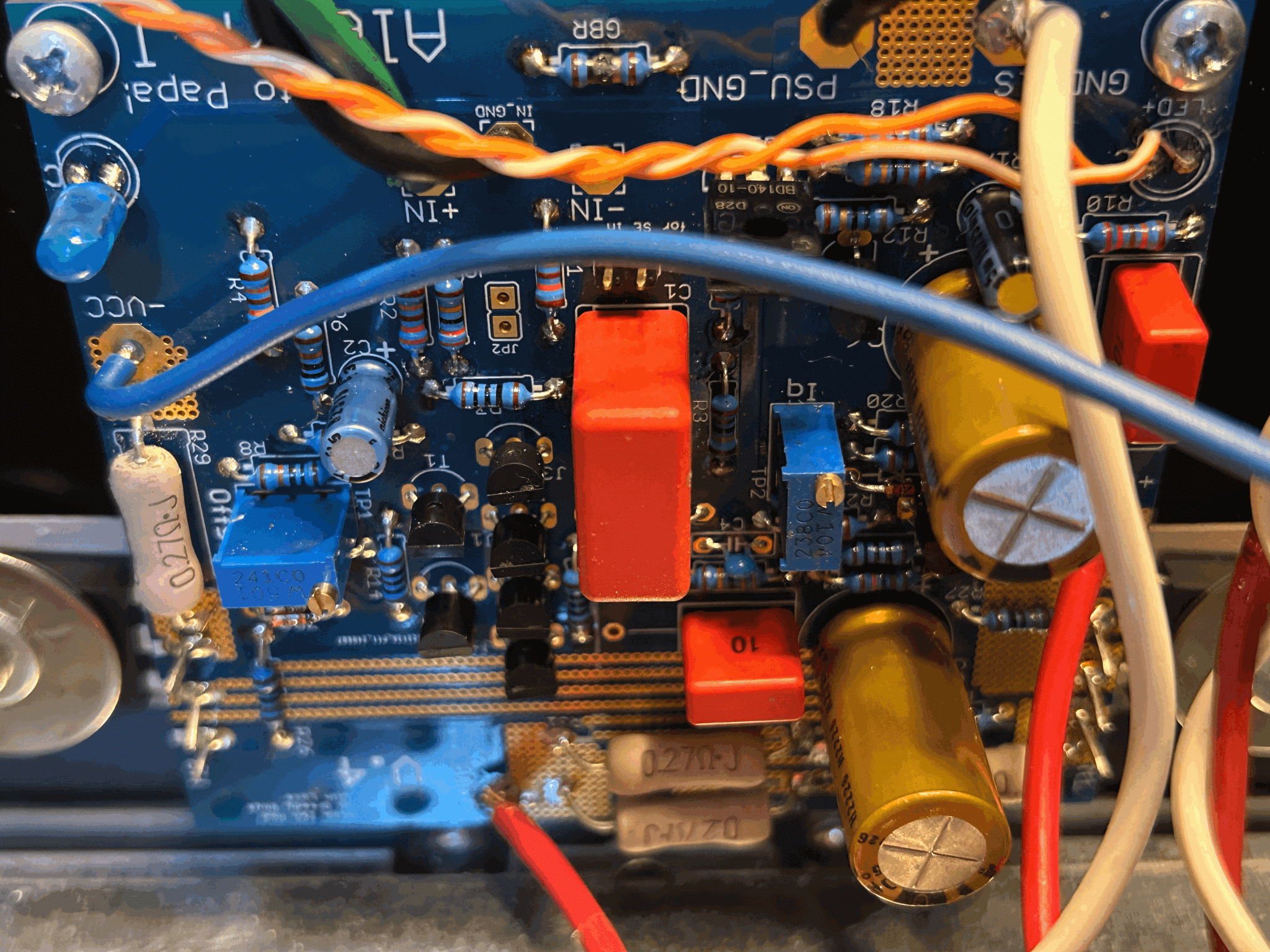

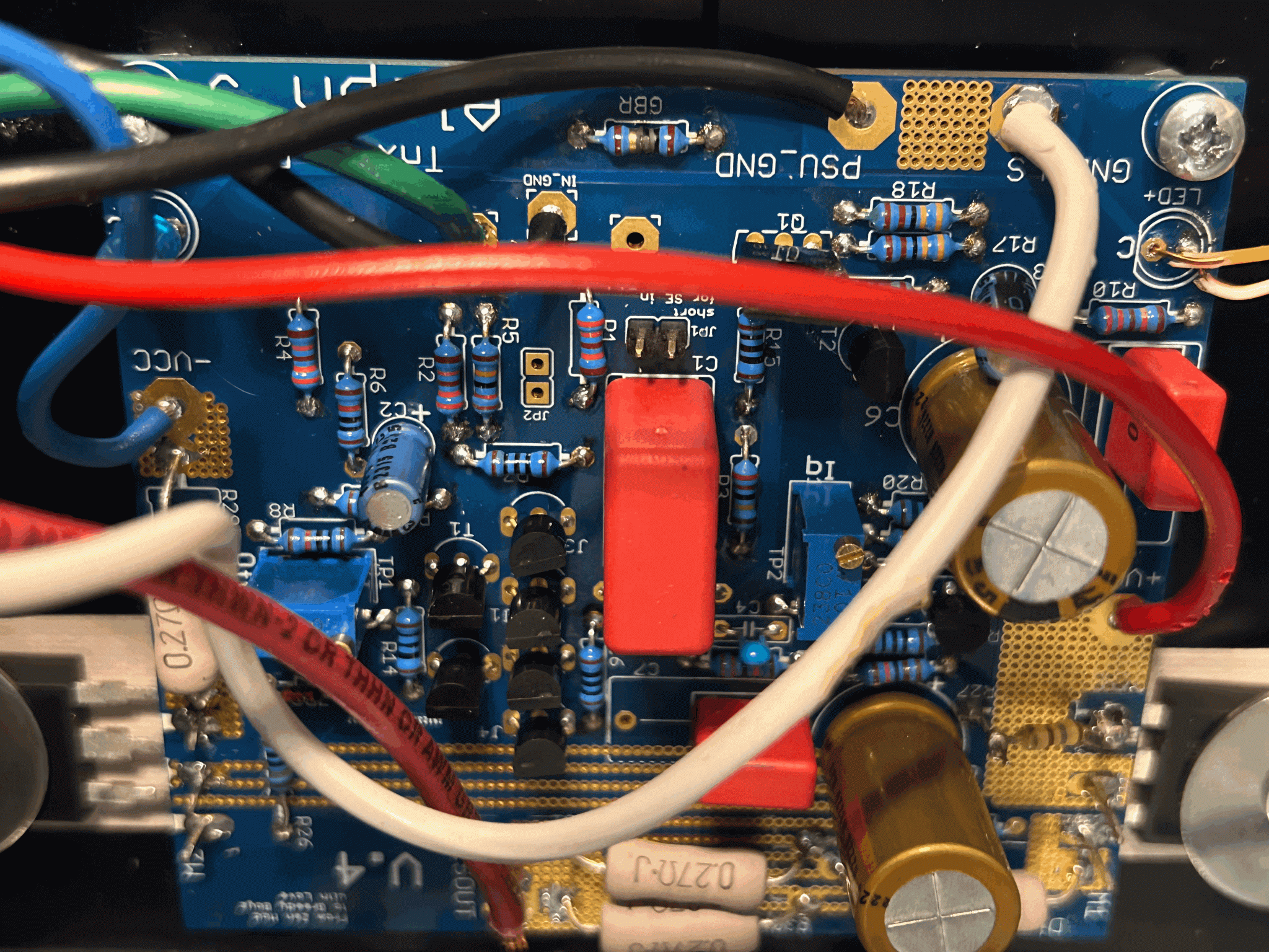

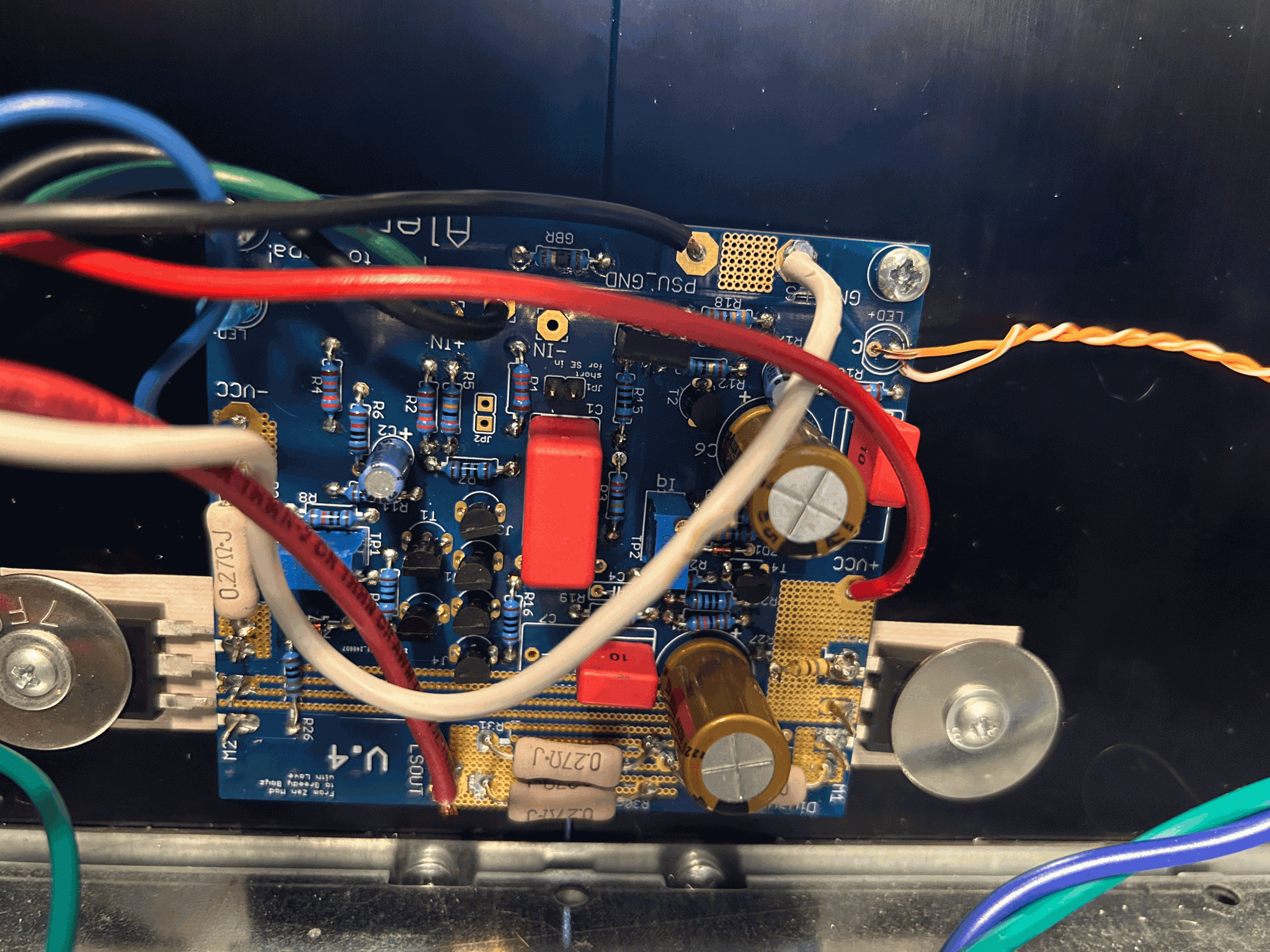

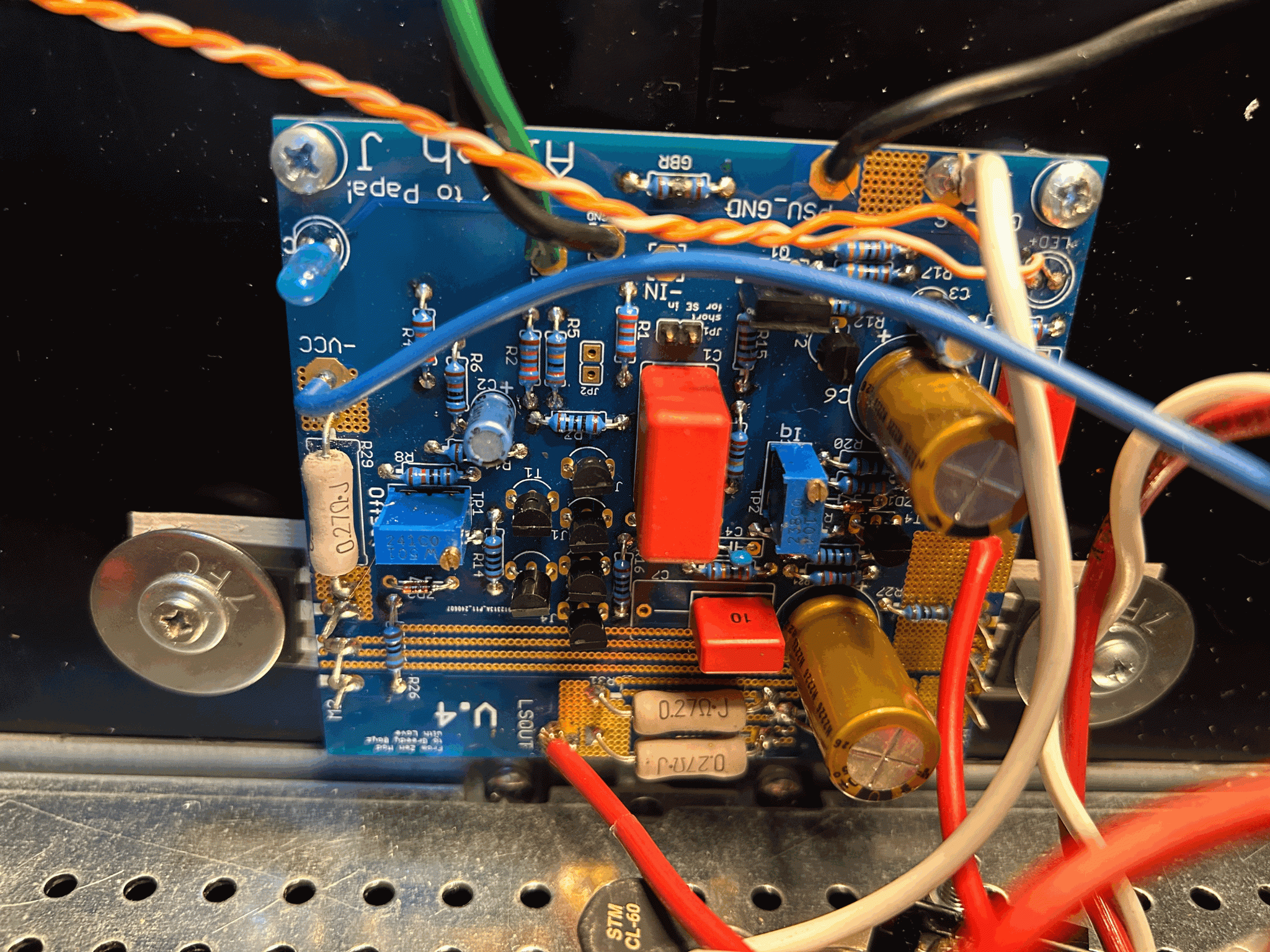

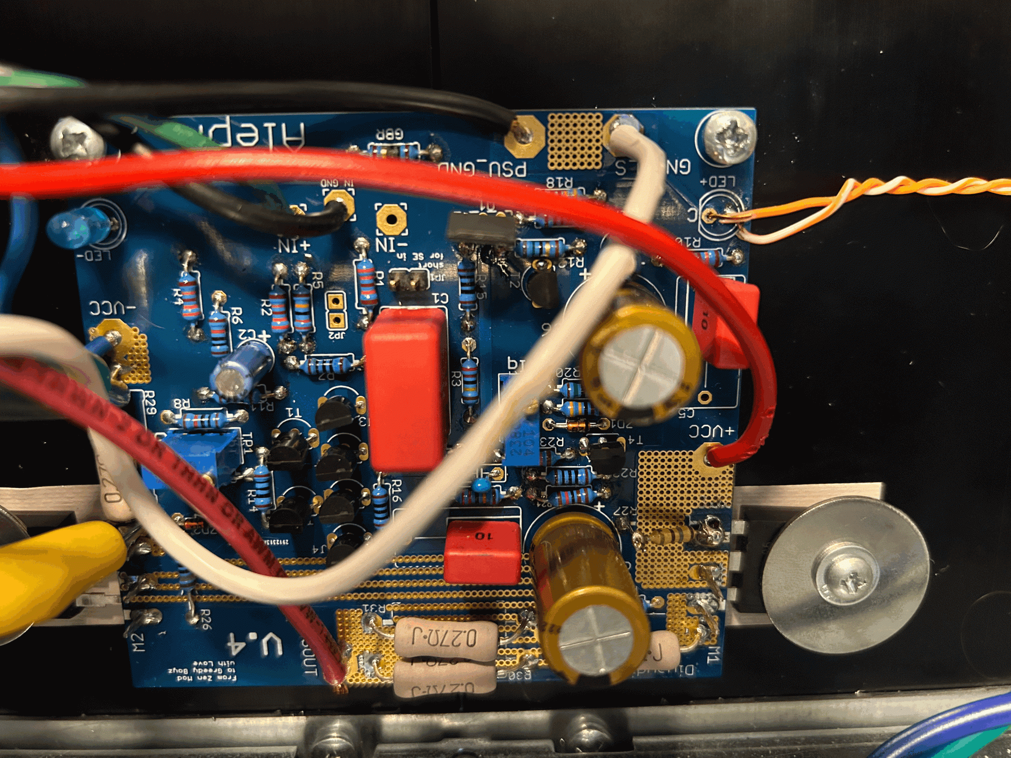

I recently built the Aleph JZM. I have tested it and I'm getting 450mV at r29 on both channels. My offsets at the speaker terminals are as close to 10mV as I could get them but they really fluctuate a lot. On the right channel, I accidentally scraped off the pads on R27 where it's super close to one of the legs of the MOSFET. I ended up soldering the resistor to the leg bc I assumed that's where it wants to connect to?
I'm getting a ton of distortion in both channels but particularly in the right channel. Also, I've seen the dreaded white smoke a couple of times and I'm not sure where it came from on the boards. Both GBR resistors look lightly toasted.
Can you guys please help me to diagnose what's going on? Please be gentle, this is my first real intermediate build and I still am quite a beginner. Thanks

dunno for GBR, have no ideo from pics, but - when using SE (RCA) input, you need to short -IN to GND (instead of leaving it floating)
there is a JP1 for exact purpose, and even a note "short for SE in"
that can cause distorted sound in your case, same as some fluctuation of output DC OFfset, in general
though, 10mV is practically nothing, and your definition of fluctuation needs to be described in detail - illustrated with some numbers - how much and how fast
replace both GBRs with 0R resistor - short piece of wire - they are toasted and who knows in what state they are, regarding resistance

Though, the white smoke is bad news. Perhaps a few real closeup pictures of the front and back of the boards would be handy, if shorting -in to gnd doesn’t do the trick.
The amp is now performing wonderfully. I shorted -IN to IN ground using a wire and I re-soldered some of my suspect joints. My lq pot wasn't working on one channel, but after the re-solder it's back in business. I recalibrated the bias and the offset and now it's sounding wonderful. I actually found the jumpers. I was considering putting them on and taking the shorting wire away but they just fall off the pegs if you move the amp at all. Am I supposed to crimp them? I figured it's working now so don't mess with it. Is there any advantage to using jp1 to short as opposed to using a wire?
