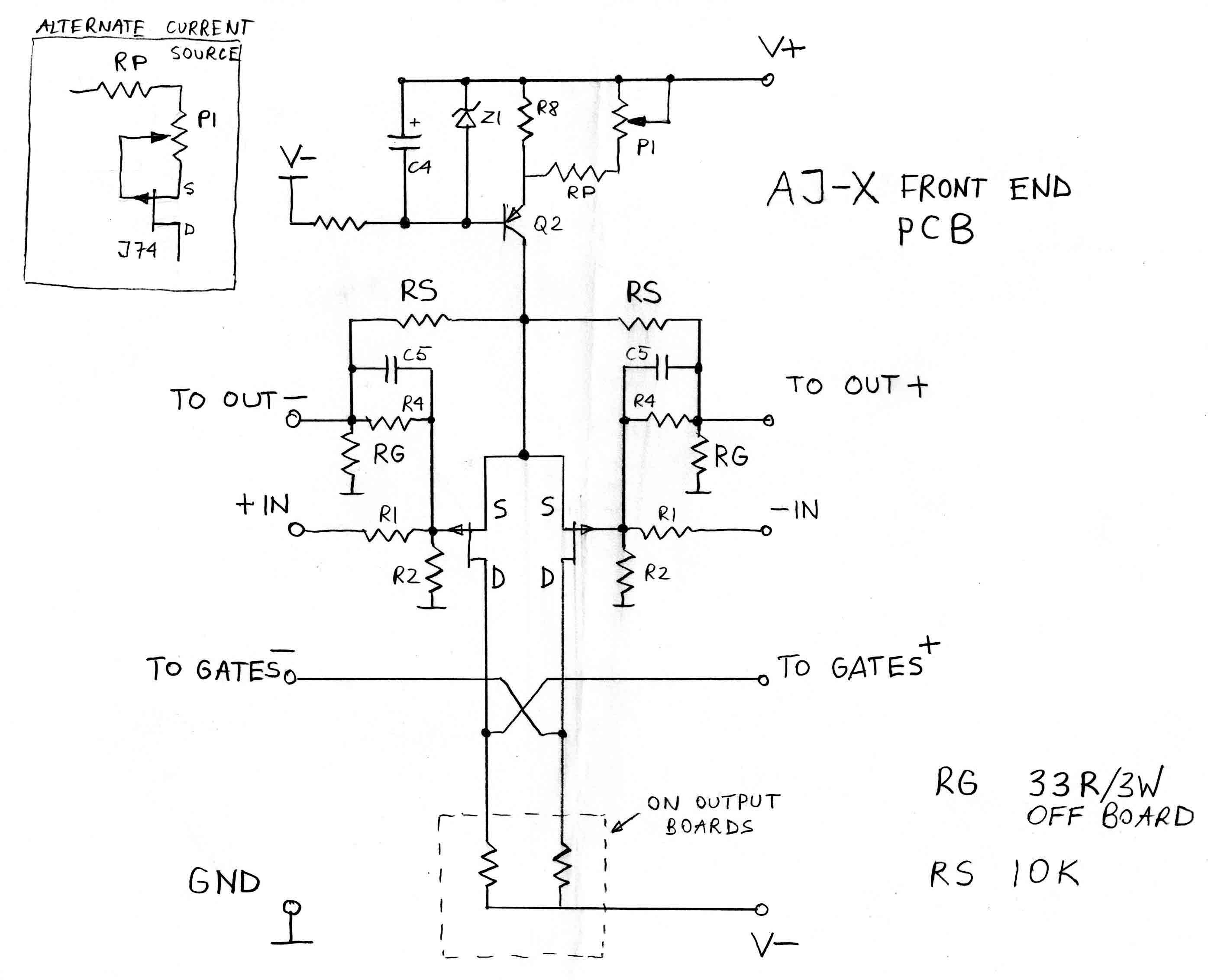

PCB Front End Population
Hi Everyone,
I am finally populating my pcb(s) and have run into a problem, there is a place for two transistors, J74 & Q2, according to the schematic I have only one of these should be populated, similarly with the two P1 & RP laid out on the Front End pcb ?
On the schematic there are two resistors boxed off at the bottom connecting to Volts negitive, and there is a note that says "on output boards" what resistor number corresponds to these resistors ?

For clarity purpose I'm attaching front end schematic here.
The circuit in the top left corner marked as Alternate Current Source was suggested by EUVL. You can either use it or stay with original Aleph current source based on Q2. In case of a latter, just don't install RP, P1 and J74 on front end board. And that's what I would suggest initially. After you have your amp working and tested, you can start experimenting with alternative circuit.
The two resistors connecting to V- and marked "on output boards" are simply R7, which are located on main boards. In case of AJ-X you will have two of them (one per each output board).

J74 current source
I have the J74(s) for the current source, do I just omit the Q2, RP, P1 grouped together near the Q2, and populate the J74, RP, P1 grouped together near the J74.
Thank You For Your help
