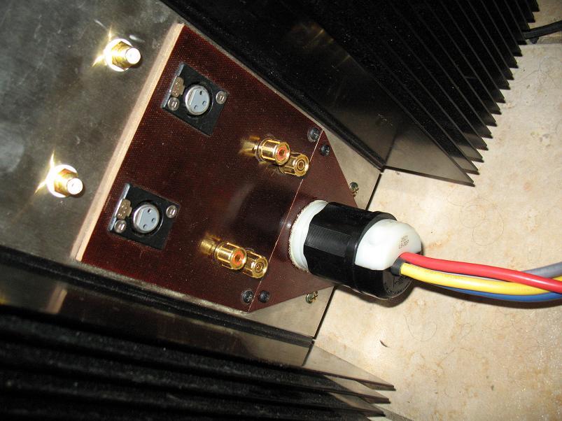

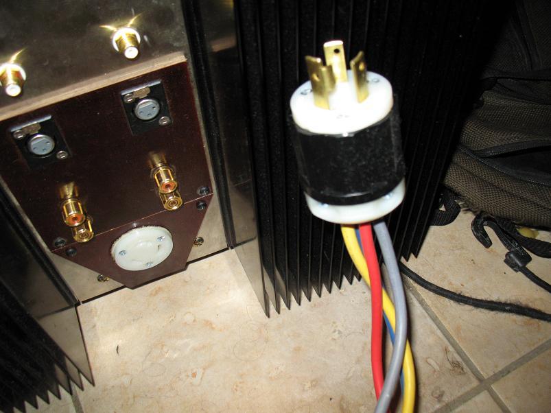

Peter I don't know if I can plan a head the JX version . What I mean I would like to use the same transformer for the JX amp what I use right now for my Aleph X .
The transformer 2x18VAC 1.5KVA . I could save almost 300 on the transformer .
Any way I like to keep the transformer in a separate enclosure .
I will post some pictucture from my Aleph X .A picture worth more than 1000 word !
I was planing to build a Aleph2 to use up my large heat sink enclosure (about 45-50 lb) but the JX would be more exiting !!
I prefer the sound of the X over any Aleph .
I do not want to hijack the tread . I just want to know if my transformer OK to the JX . In that case I would stop to finish the Aleph2 .
Some picture .

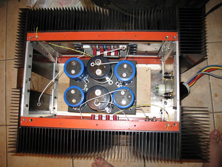

My Aleph X inside .
It is a great amp . The reason I want to try the JX-ed verizon .
I use the Kristijan PC board with 2pair mosfet (8 together for one side).
The bias is 7A . The sound amazing . Especially with lot of improvement in the bass .

I did sold the Aleph 30 . Right now I rebuild the X .I want the transformer in a separate enclosure in that way I can use more capacitor in the power supply . And I think that big transformer is not the best idea to be close to the PC board and to the signal to .
