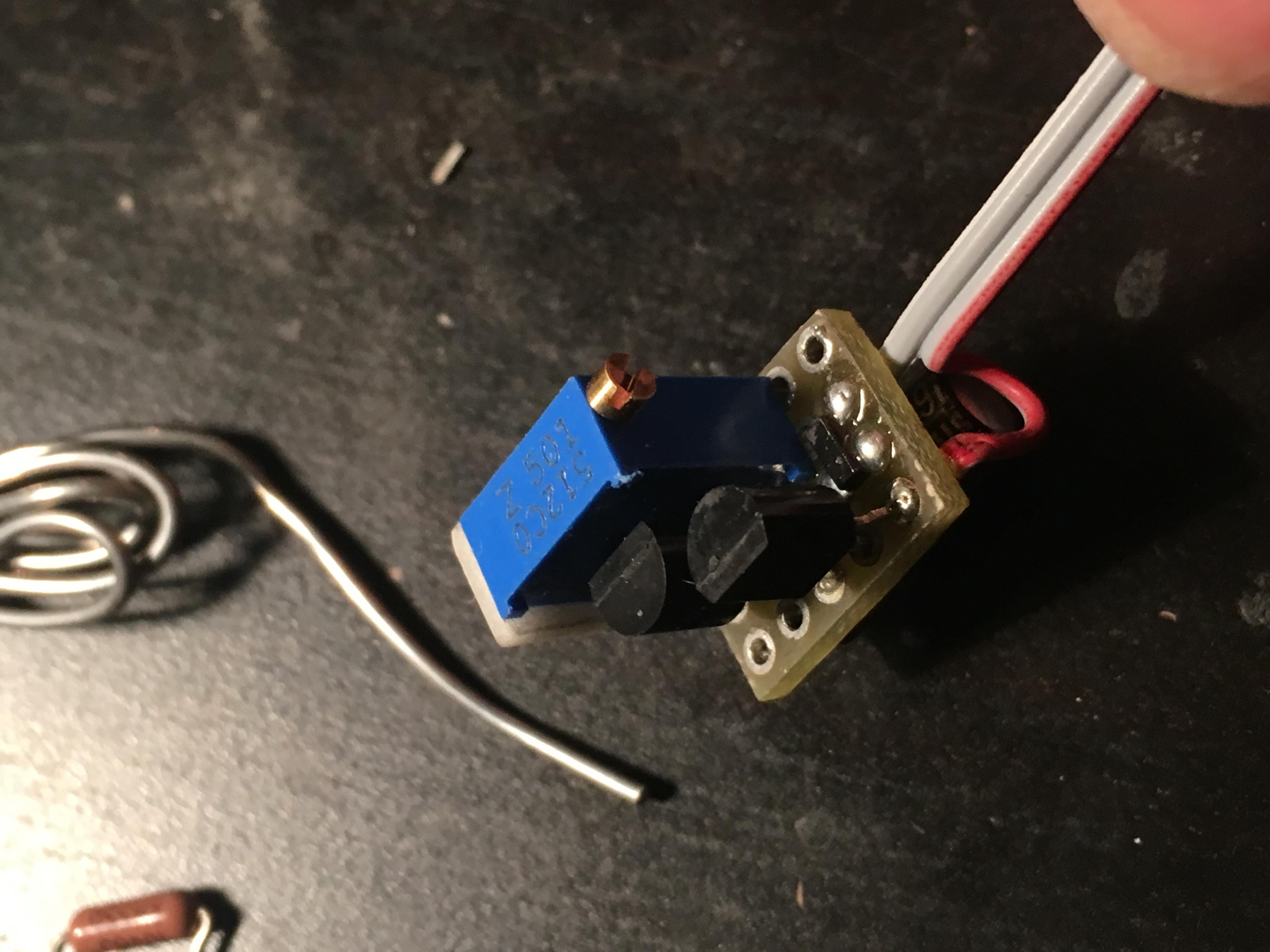

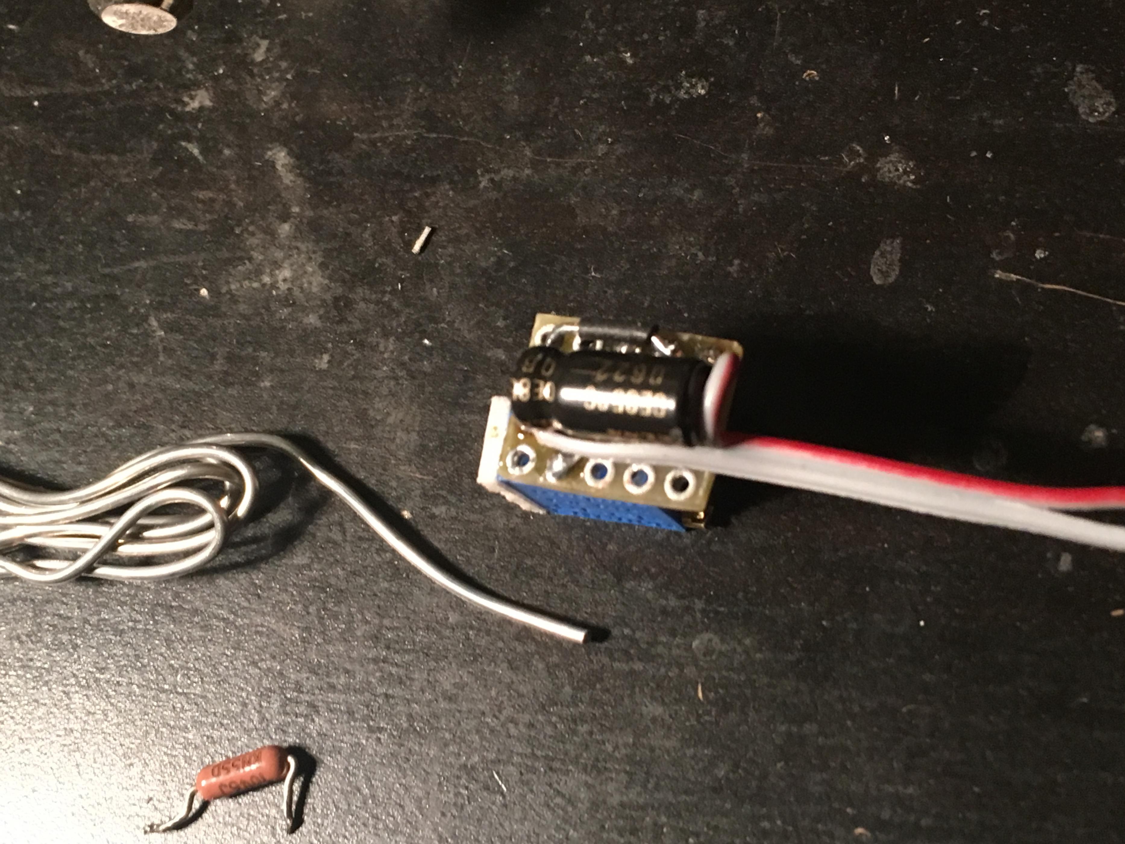

I have built some 2 terminal ccs's to bias the ltp of my each j.
I am using r8 in series with the ccs, from positive first I have r8 then the ccs.
I have instaled the ccs in one channel, set it up for 14 ma bias for the ltp and is all working up and biasing correctly.
Does r8 position(first or after ccs) and value matter?
Having 14v drop acros r8 I am considering to lower its value to 500ohm. Is this recommended?
I have replaced the original ccs with a 2 terminal ccs so I am not using anymore c4,z1,q2 and r5, the ccs is connected in place of ce pins of ztx550. Now the ltp bias is similar to ba1 front end only that I use something else as ccs insted of k170.
I have reworked also the second channel 🙂
